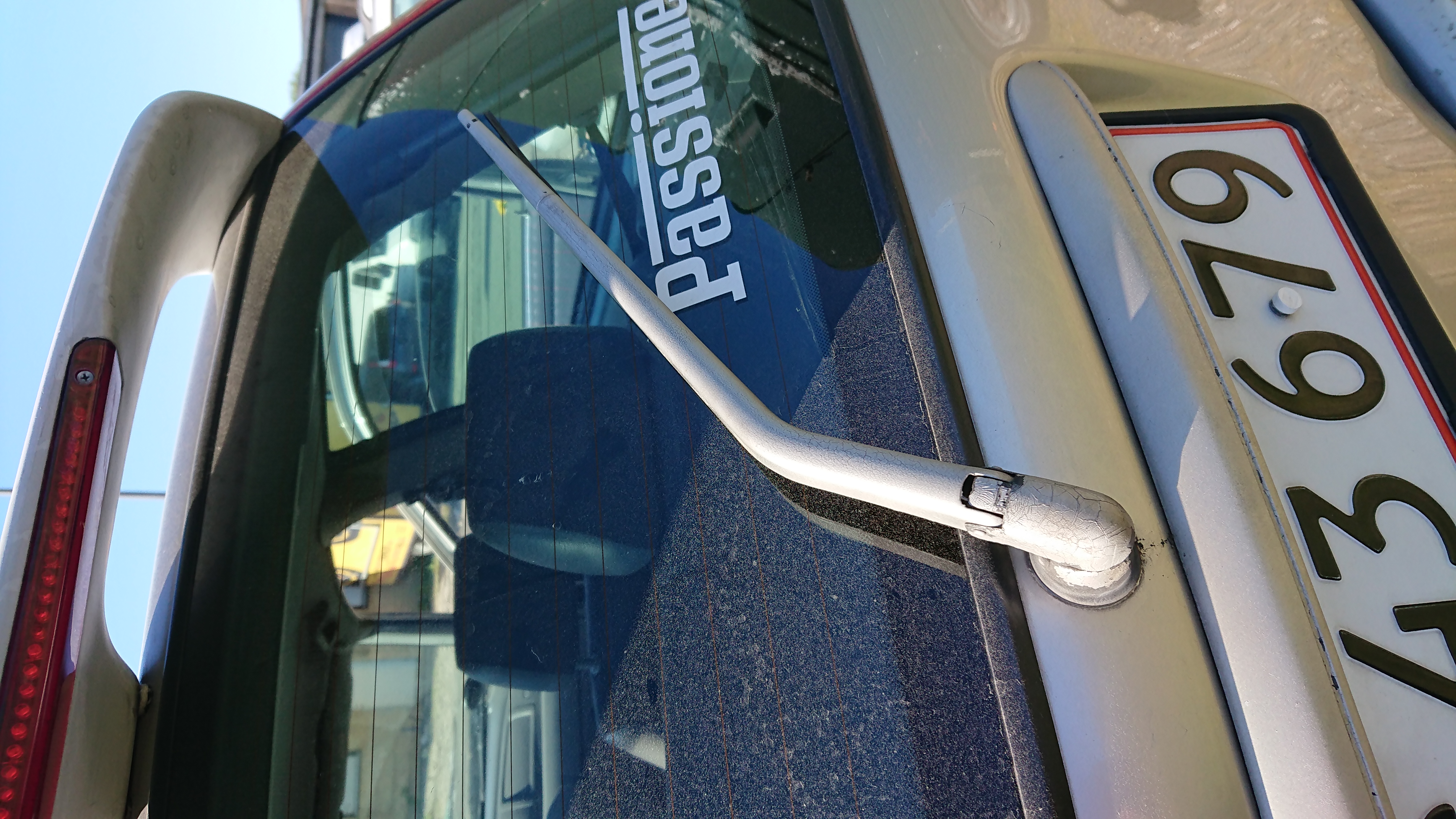

Ultimatum Demon Member Joined Apr 30, 2019 Messages 35 Points 95 Jun 1, 2020 #1 I got this weird problem that my wiper stops in this position. I noticed that when i help it turn, the washer house moves along
Steve gt Established member Parked in the garage Joined Jun 27, 2014 Messages 703 Points 256 Jun 1, 2020 #2 It could be one of the mounting bolts have come loose or the shaft where the wiper arm fits is starting to seize, I had to take mine apart to solve a similar thing , it was stopping straight up .
OP OP Ultimatum Demon Member Joined Apr 30, 2019 Messages 35 Points 95 Sep 7, 2020 #3 I found out that it was rusty inside, so i got it scratched off and added tons of grease. Works great now
Steve gt Established member Parked in the garage Joined Jun 27, 2014 Messages 703 Points 256 Sep 7, 2020 #4 Ultimatum Demon said: I found out that it was rusty inside, so i got it scratched off and added tons of grease. Works great now Click to expand... That just how mine was [emoji1303]
