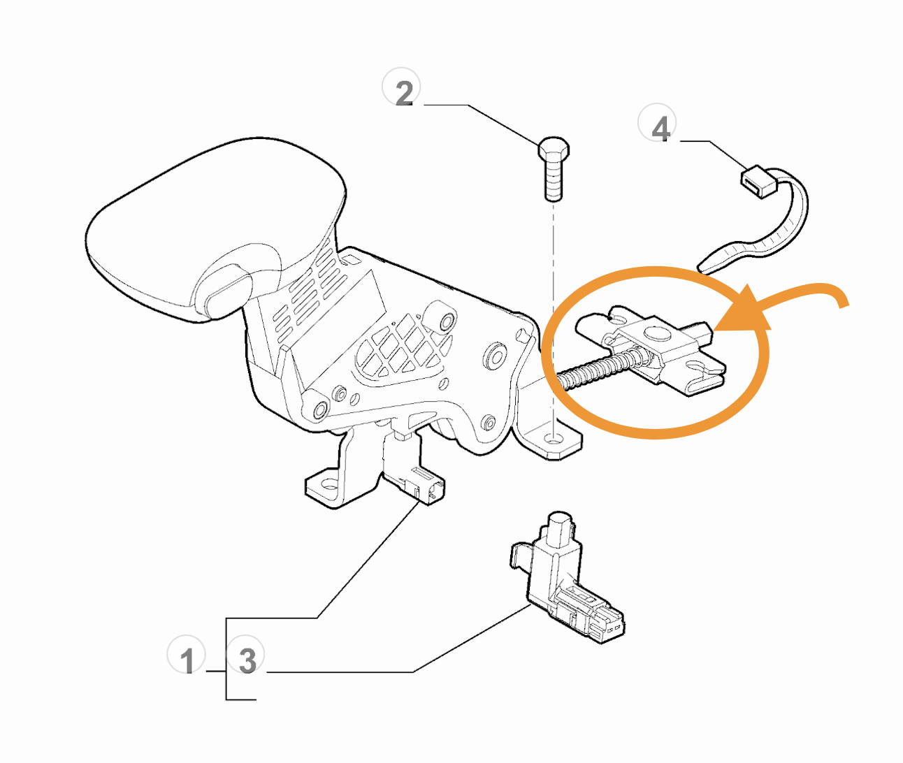

It is more making sure the levers at the wheel go back to the stops, otherwise it will not self adjust and you can adjust the cable as much as you like it still wouldn't stop properly. The cable adjuster may be under the centre console behind the lever nearer to the rear seats. On some cars you can remove an ashtray or similar to access, I don't know particularly on yours. Others here can advise on that.Thank you so much for your kind message, I'd like to start by saying that I've owned the panda from new and there has always been some play with the handbrake handle. The car has only 13,000 miles on the clock so there's no wear on the discs, however the handbrake handle has gradually got to the limit, she only just passed her last MOT with the advisory of the handbrake adjustment. I will try pumping the brakes and see if it helps. On previous cars I've owned there's an adjustment screw inside the handle but on my panda I couldn't find anything.

Hi everyone just want to let you all know that I have sorted out the issue regarding the handbrake, I took your advise and pumped the brake pedal lots of times, it's self adjustedHi guys and girls I've got a 2015 Fiat Panda 4x4 twinair. Can anyone help me please and advise me how do I adjust the handbreak cable, it's got rear discs, any help would be appreciated. Thank you.
