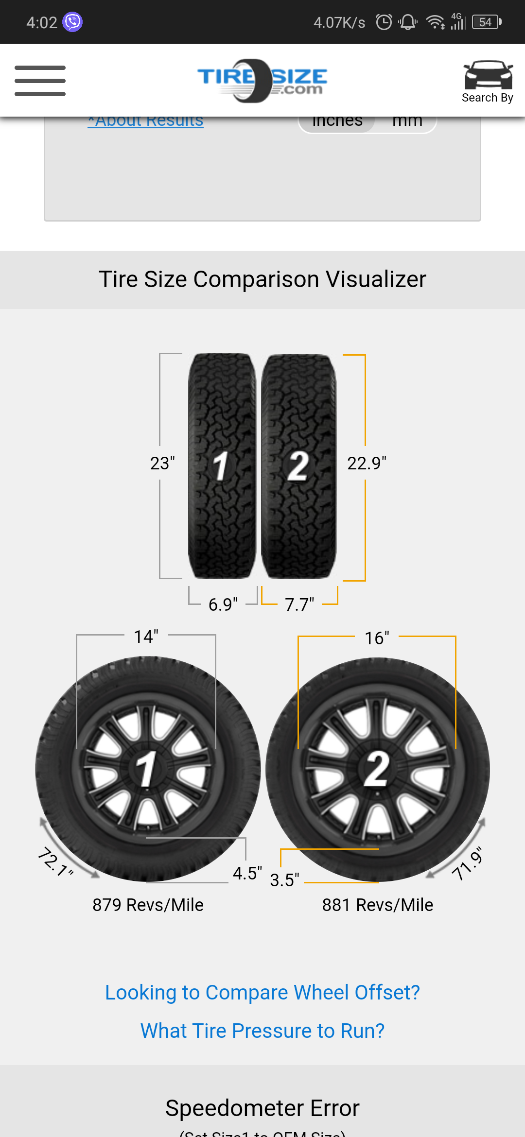

I have MK1 Punto and I wonder can I put 195/45/16 rims?? I have 10mm spacers and 175/65/14 alloys!
The stock size by the book given for mine is 165/65R14...
Will 195/45/16 scrub on full lock???

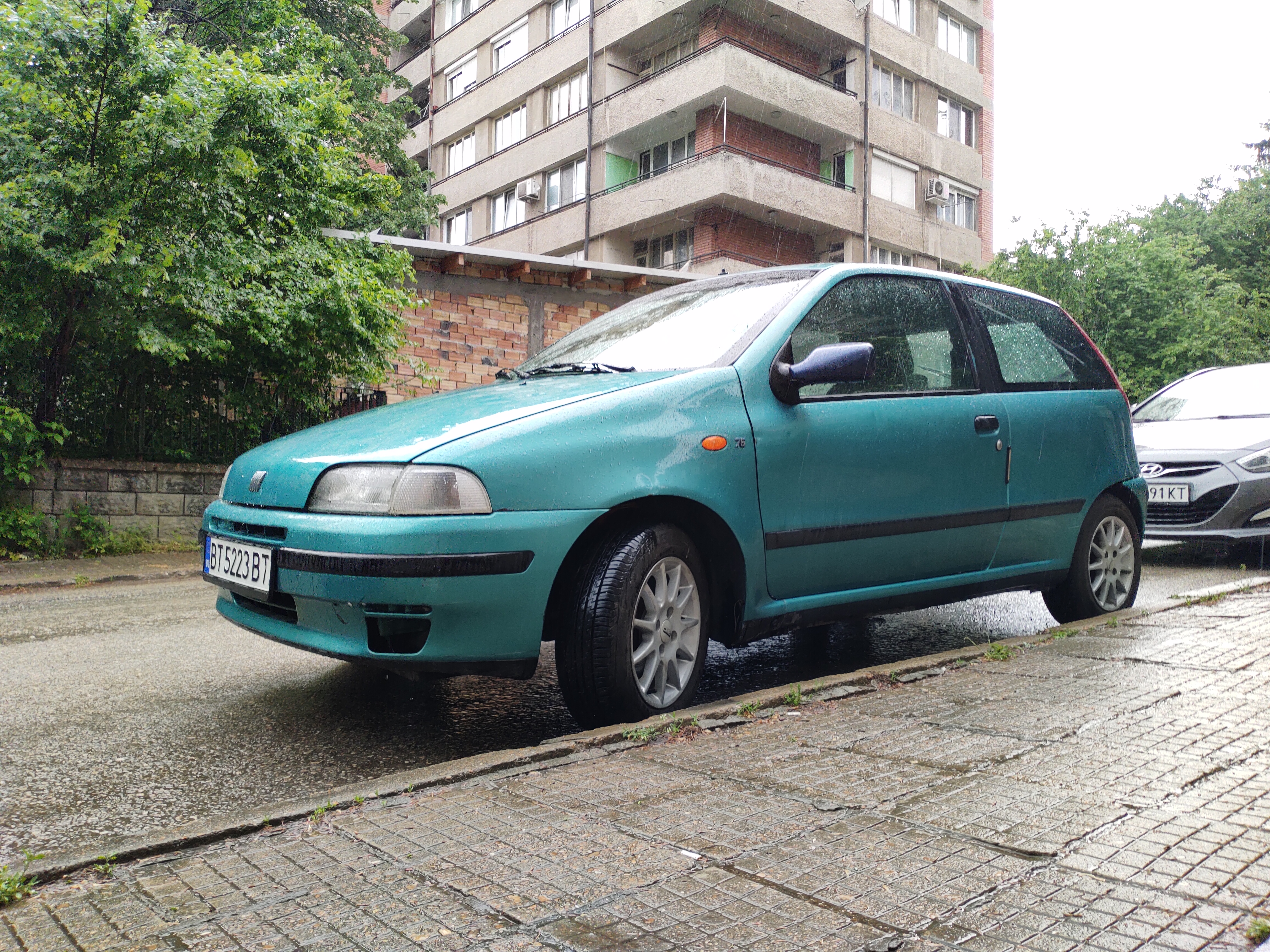

As I said I am running 175/65/14 and they fit good on the arches...
I am thinking of 195/45/16 wich is the first pic compared to mine

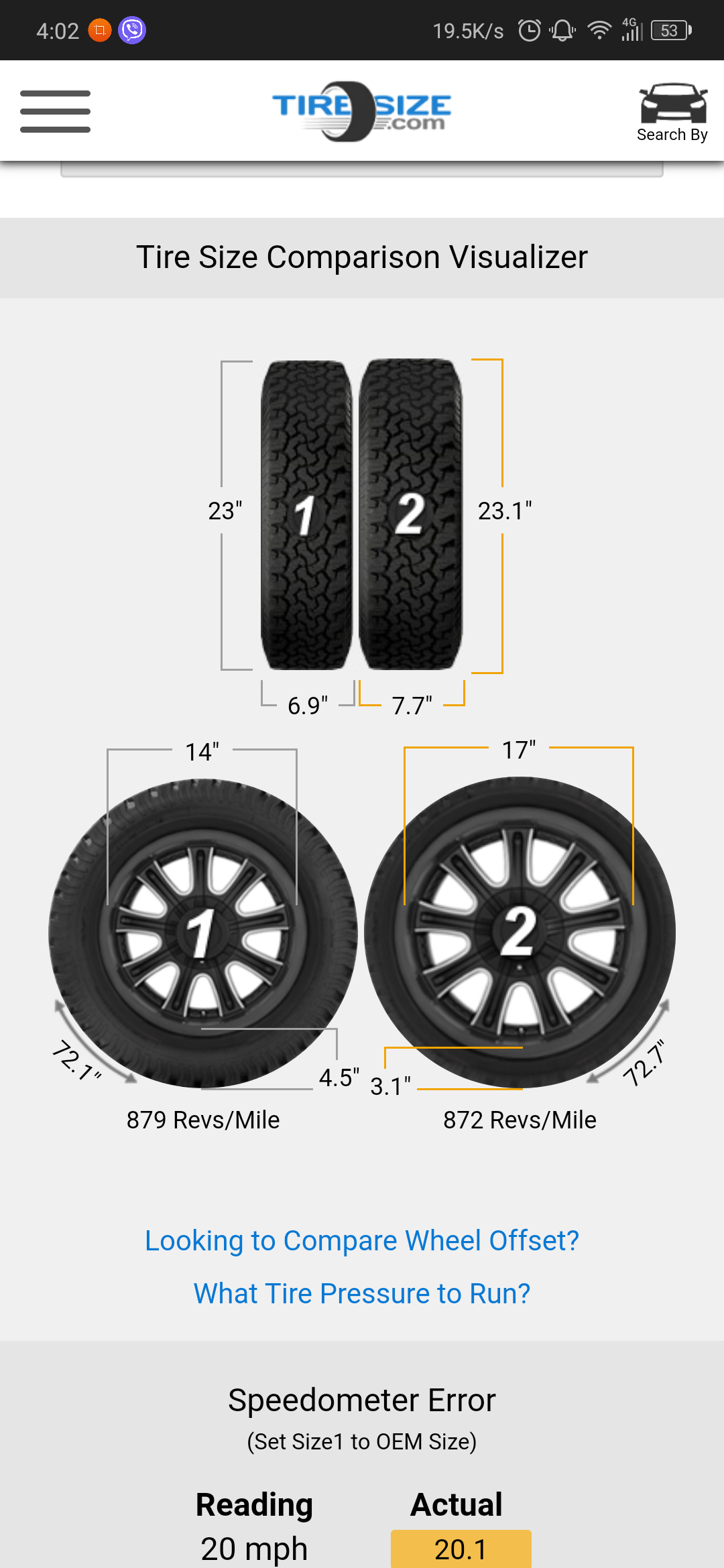

And the second one is 195/40/17 ( which I don't know how will look) compared to my size
The only thing I was wondering is will there gonna be problems with the steering?
