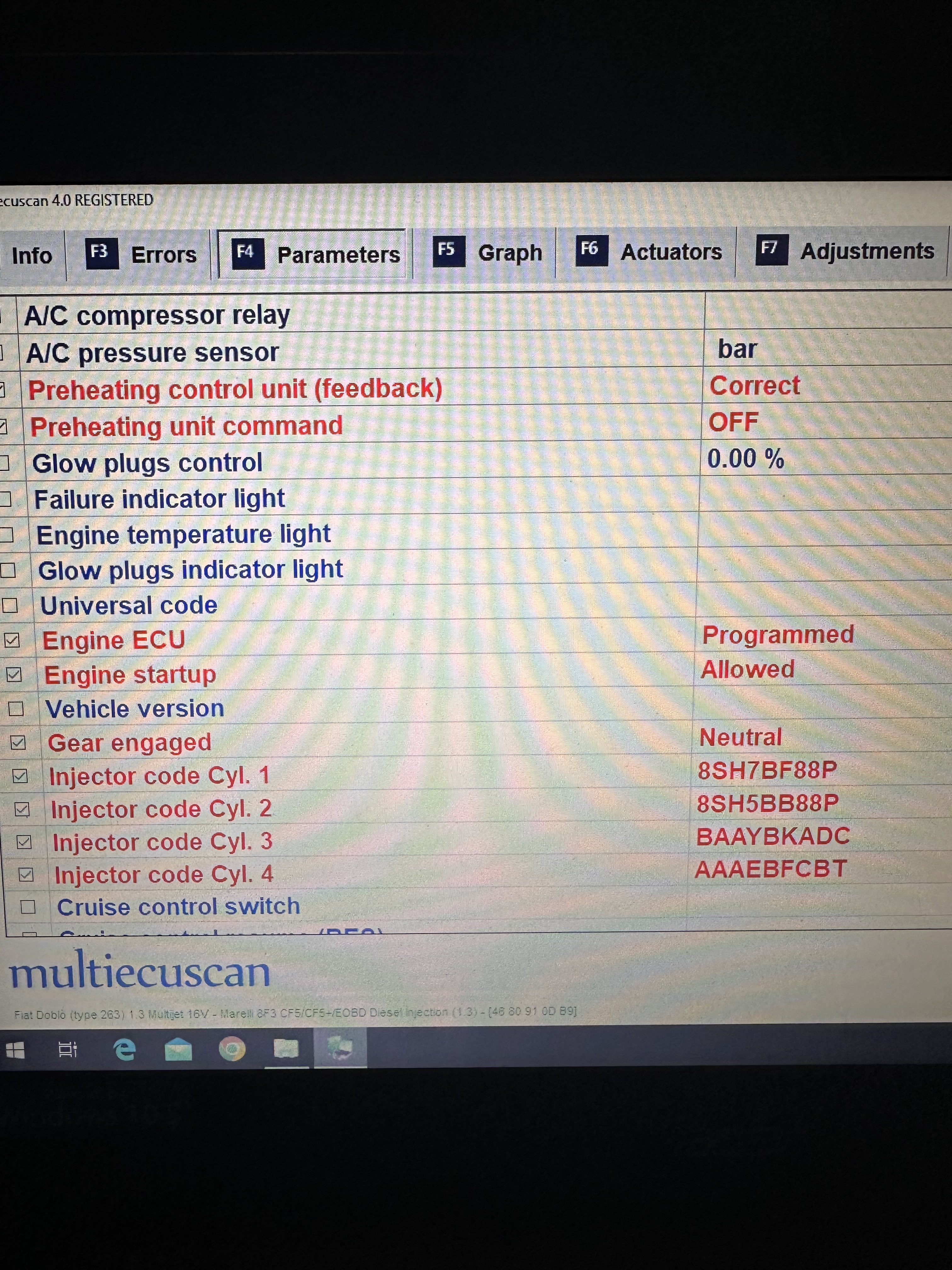

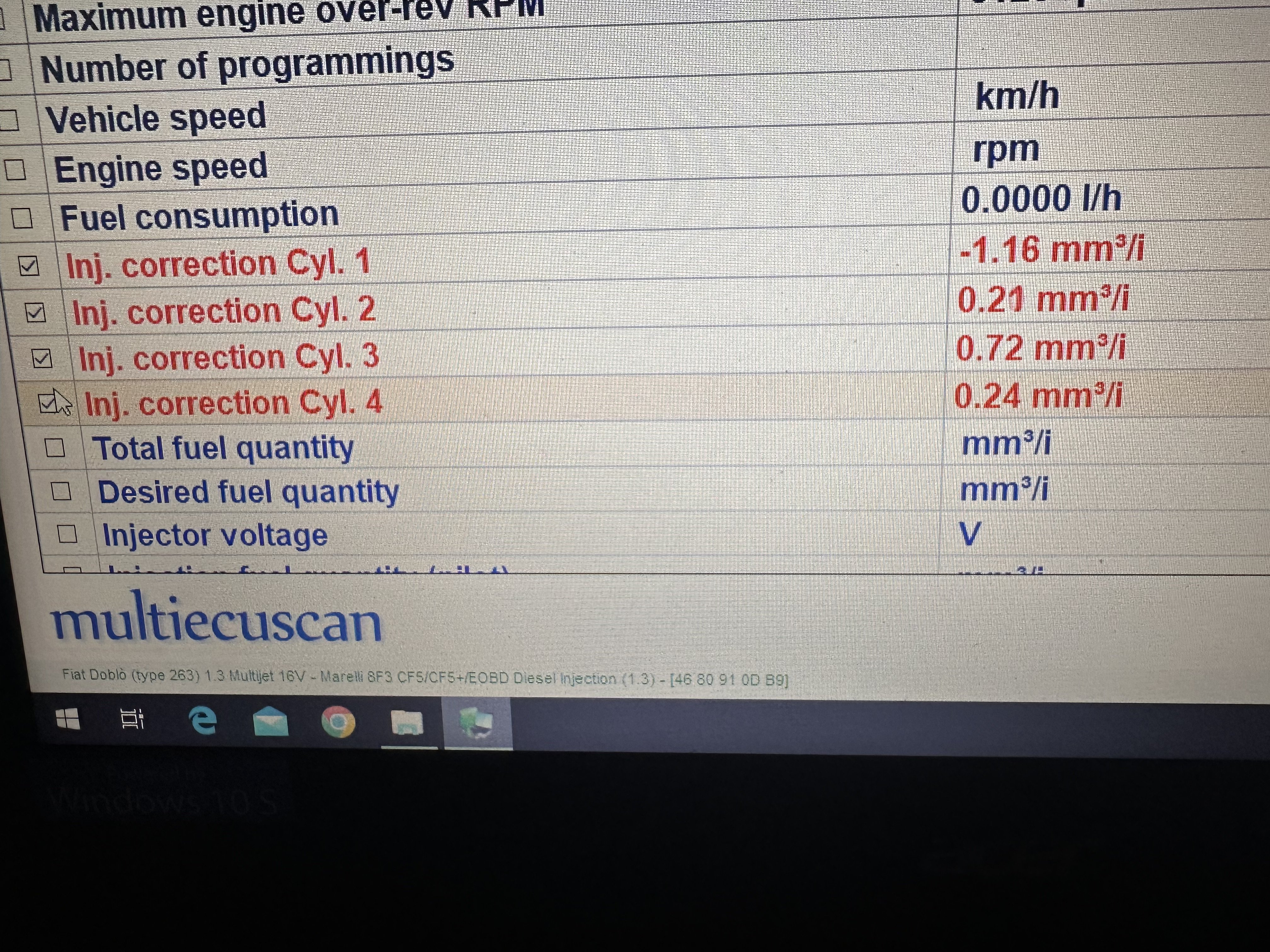

Yeah, reset I noticed the injectors correction is quite different on cylinder 1 and I have 3 different types, do they have to be the same number as the first two on injector 3/4?
I also noticed that my boost pressure is around 90-100mbar lower than the desired boost pressure does this indicate a leak, tested at idle and as i revved it wasn’t hitting the desired boost
