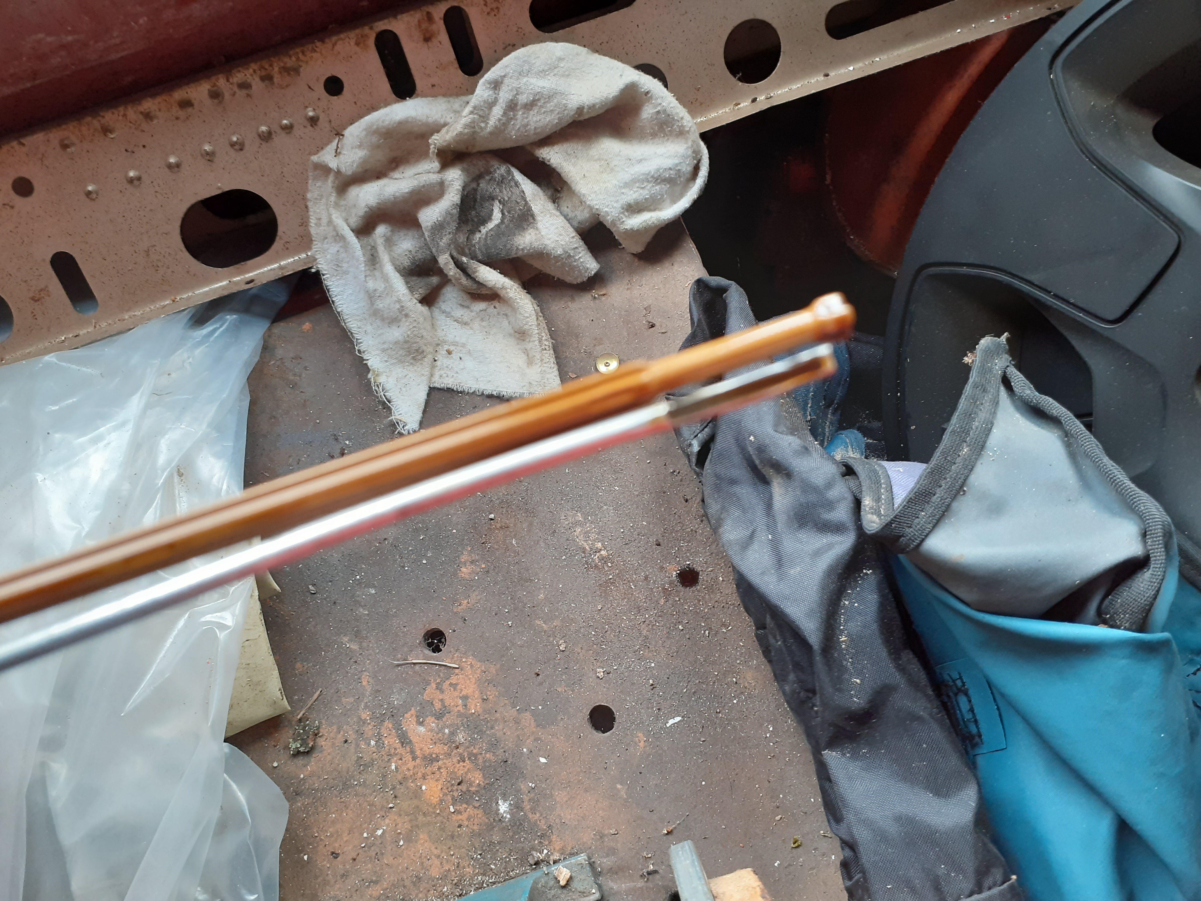

Both dipped in the oil top one is 100% useless the bottom one is my home made one. Its 100% effective. Fiat engineers 0 : Panda Nut 1
Measure carefully and make sure you have a great big handle so its impossible to fdrop it into the engine!!! I used a grinstone to make a flat for the section between min and max. Decided not to attach inside the engine and just hang it on the wall, It would easily lie under hte boot liner if needed on a long run
