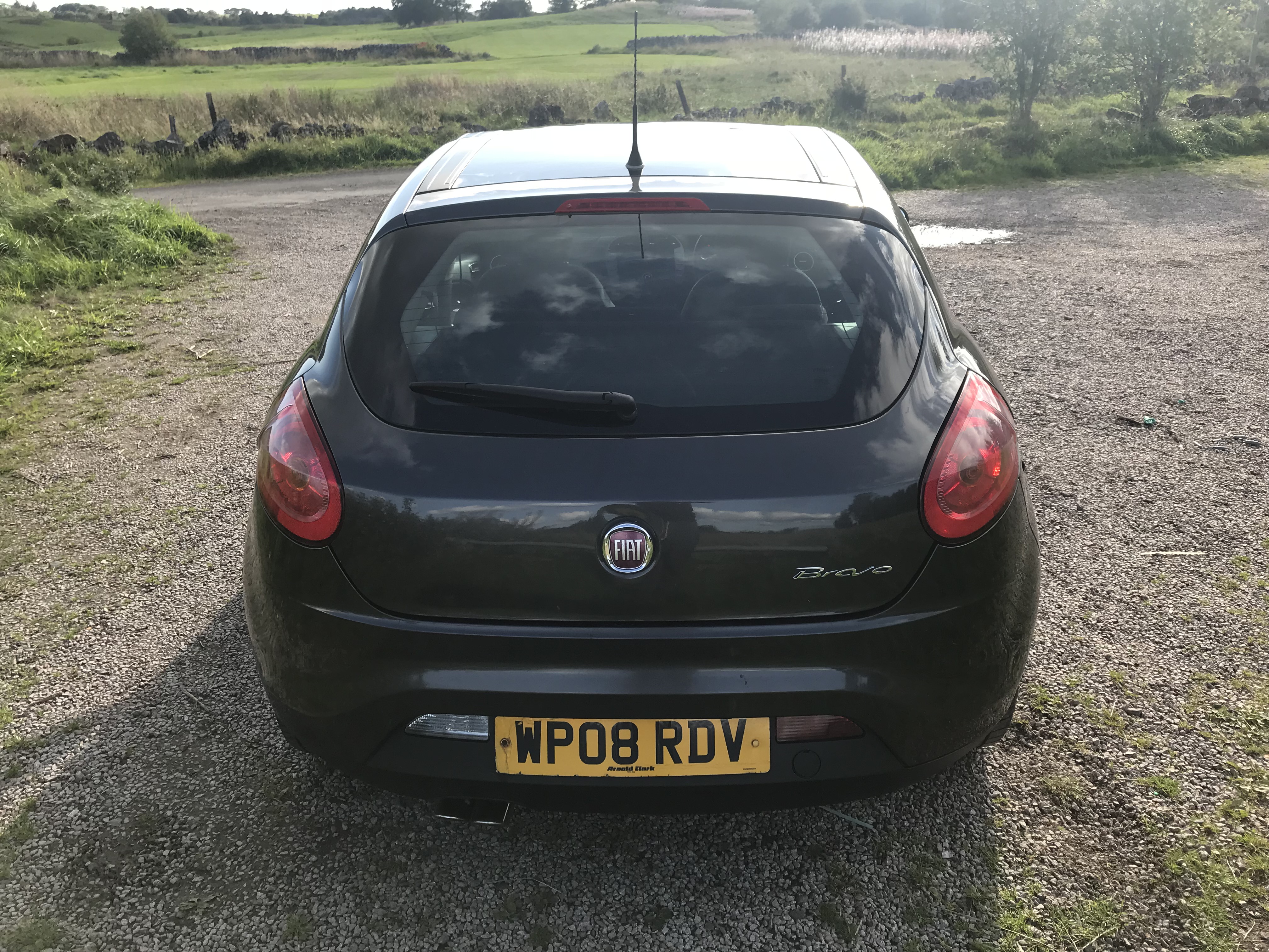

Hi everyone, picked up this beauty last Friday. This is my Bravo T-Jet Sport 150 and I must say I'm thouroughly impressed with it. She's not perfect, though I do like a project to keep me going. It has 83k on the clock and the timing belt and water pump were done 11k prior which is a bonus.
There are a few things that need attention to put it right; the front O/S wheel bearing is on its way out (on order, my friend is doing that next weekend at his work), the front N/S door lock whines when I unlock the car, makes me whine every time I hear it so I've ordered a lock off eBay and I'll sort that next week.
I'm also trying to get down to the bottom of a rear demister fault I can't figure out. It's not working and the fuse is ok (F40 under glovebox?) so any advice? I will add that as part of the deal buying the car I had the tailgate replaced as the original one had a big dent and scratched painwok surrounding the tailgate release badge/ button as if someone at some point tried to break in. Now I did think that maybe the bodyshop maybe forgot to connect the demister when fitting the new tailgate but the thing is is that my third brake light is working so I doubt they have forgotten :confused:
Aside from that she had all new brakes, service/ MOT, nearly new tyres all round, and a new tailgate before I bought her last week. I picked it up for £1500 which I though was a good deal, there's a lot of car in these for the money! Anyway here's some pictures of her, I have a few plans for what I want to do with it and it's got me all excited. Hope you like (y)

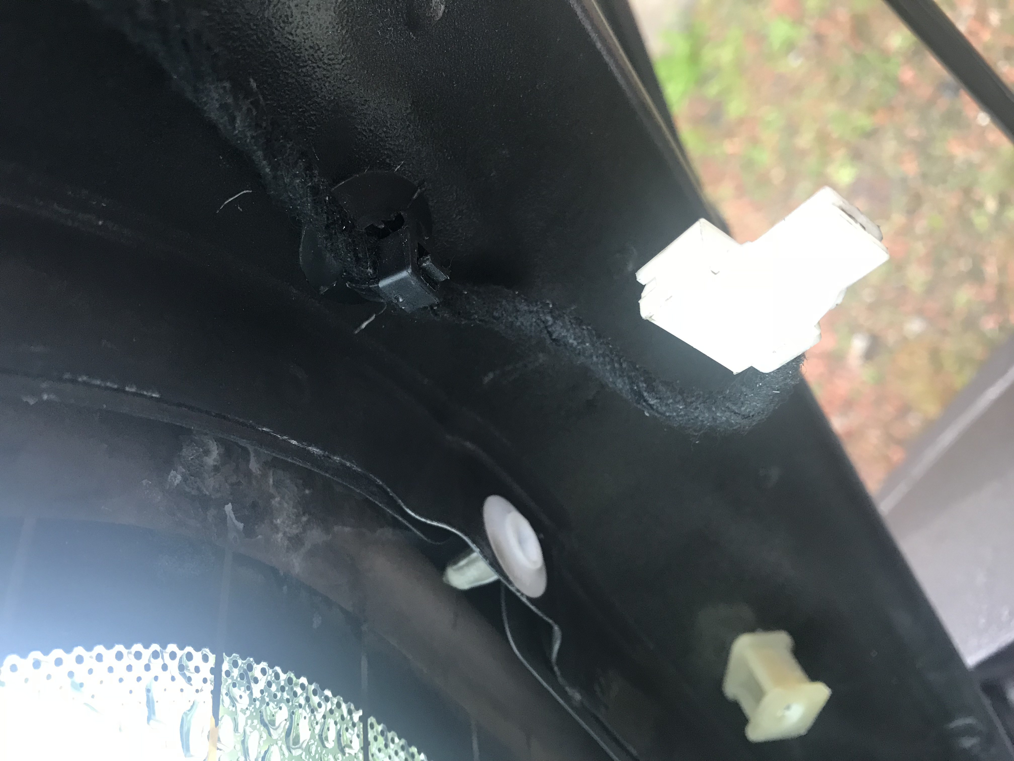

Had a look earlier today and the wiring looks fine in that rubber sleeve, though I have maybe found the problem...
Passenger side wiring plug connected to a piece of metal that extends off the heating elements
Similar plug on the driver side that's connected to nothing, I take it this should be connected to a metal extension like the oppoisite side? The glass looks a bit tacky where you'd expect a connection to be there.
Figures, looks like someone’s been tampering with the tailgate in the past. What can I use to make a suitable connection to the plug and is there a particular area I will need to solder the contact onto?

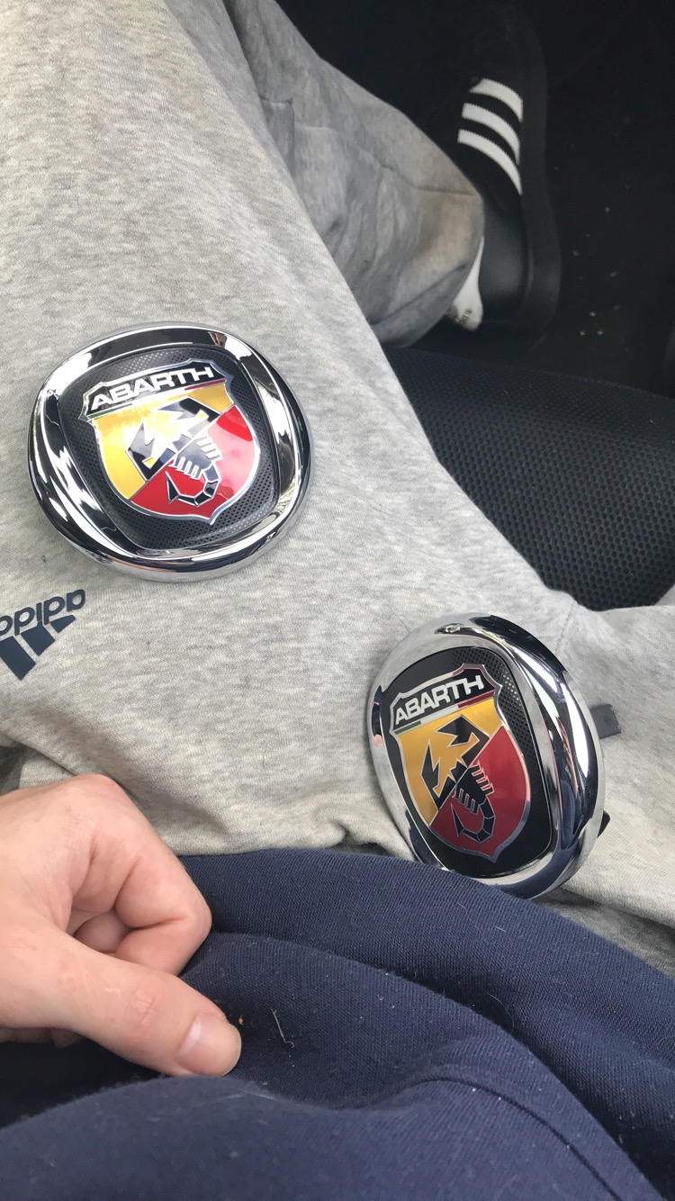

Got a couple of new badges :D
Front badge was worn and non existent.
Looking better
New badge/ boot release on the back finishes off the look on the rear. I also removed the wiper arm and motor at the same time and stuck a grommet in there and removed the Bravo badge from the side; I prefer a clean look on my cars :)

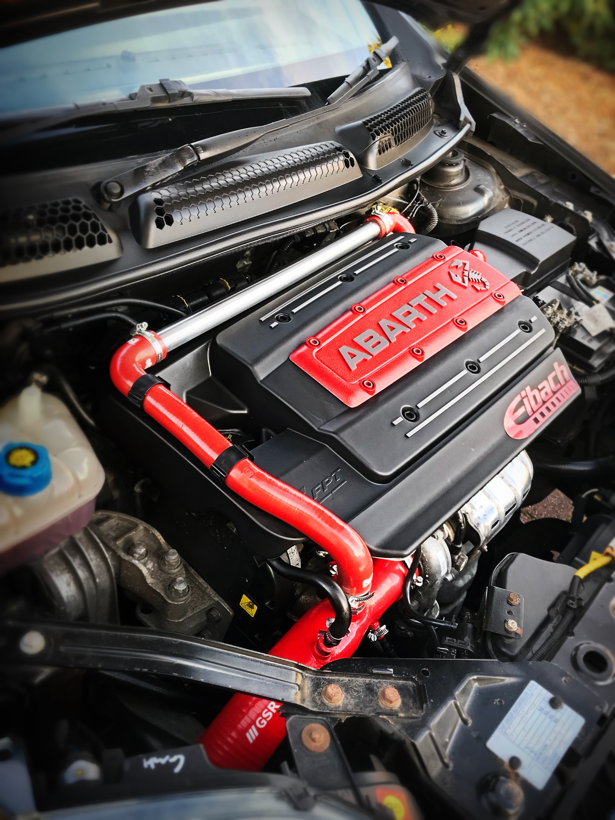

Forge boost hoses, recirculation valve and wastegate actuator.
GSR induction kit
Abarth Punto Evo engine cover

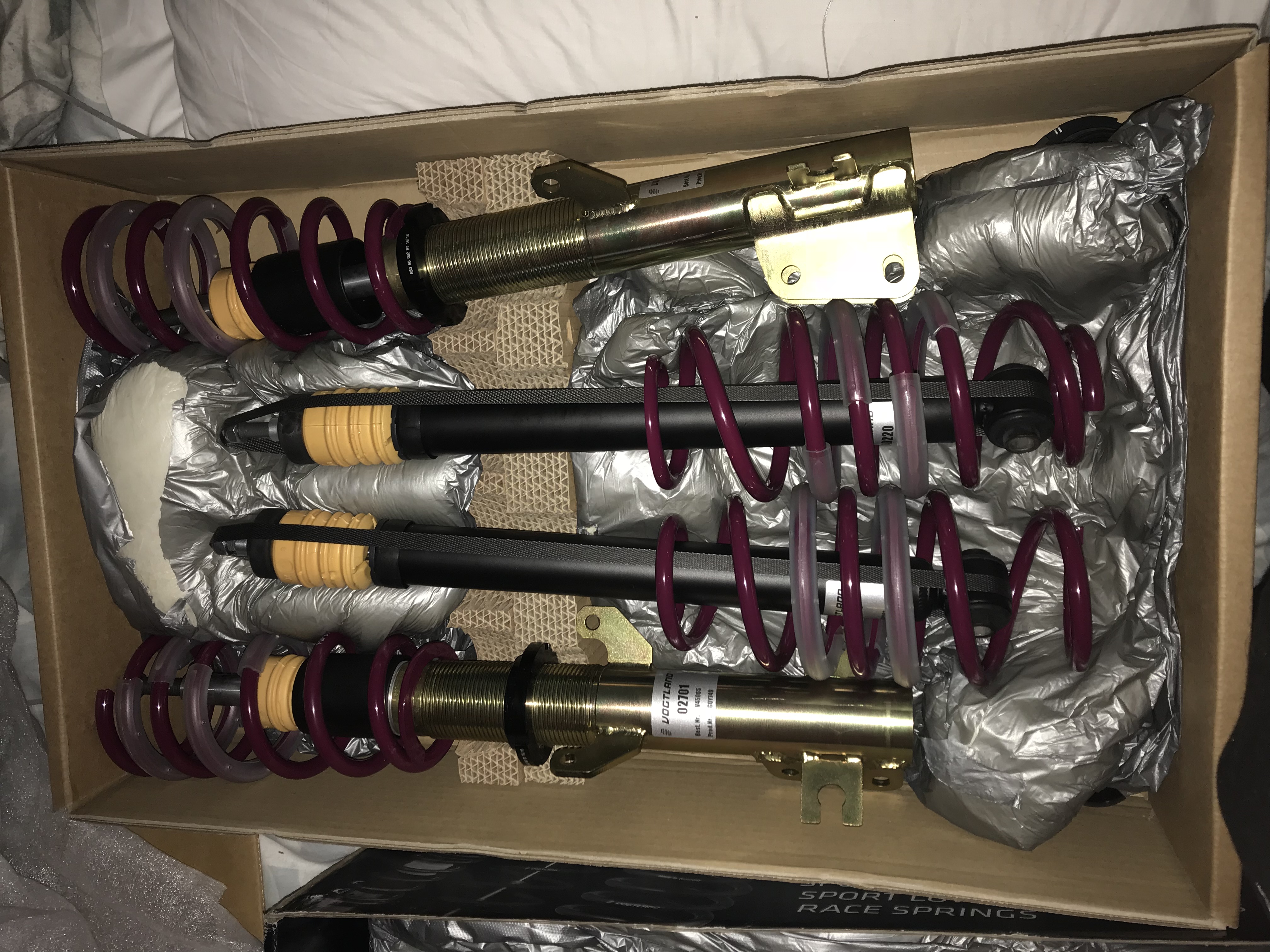

Powerflex front wishbone, Anti-Roll bar and rear beam bushes
Vogtland coilover suspension
Eibach Pro spacers, 20mm all round

Where did you get the tailgate and grille badges from,please?
