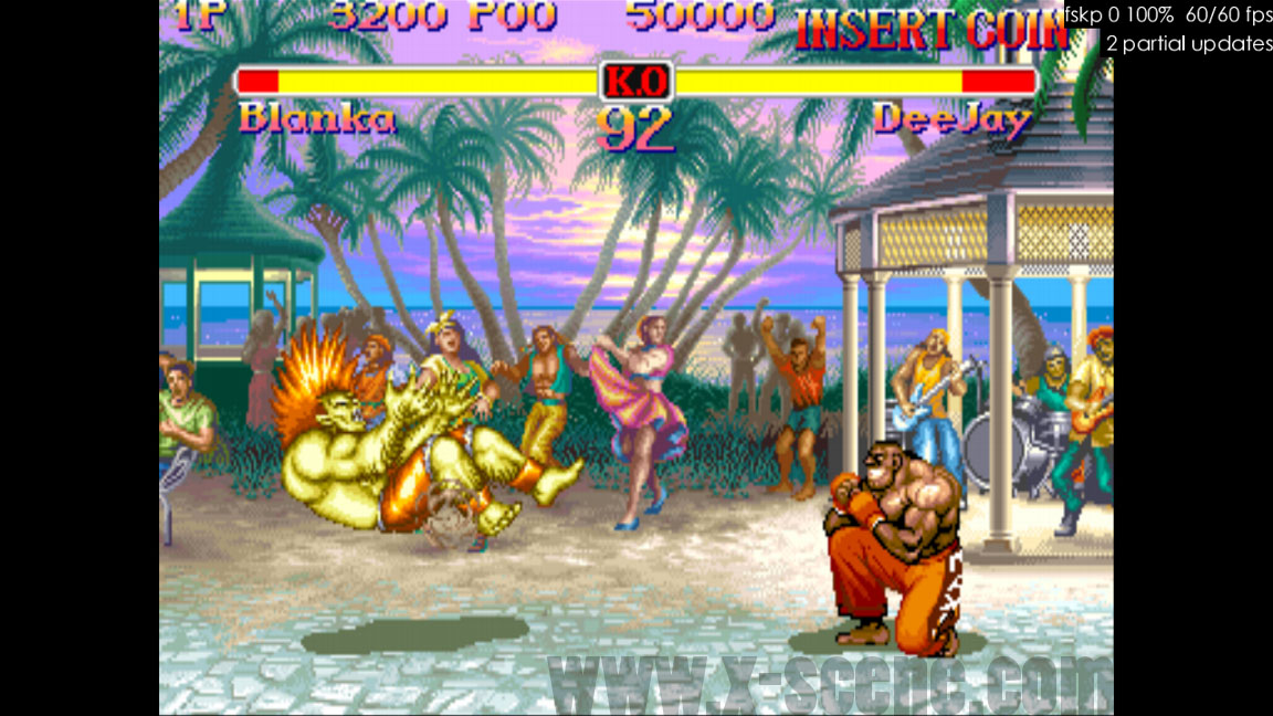

the beauty of the xbox 1 once hacked was the software available not just running copy games
some 360 devs have been fiddleing and trying stuff out though
note this is running on a development unit not a retail 360.
however all it takes is a hack to open up unsigned code and it will run
