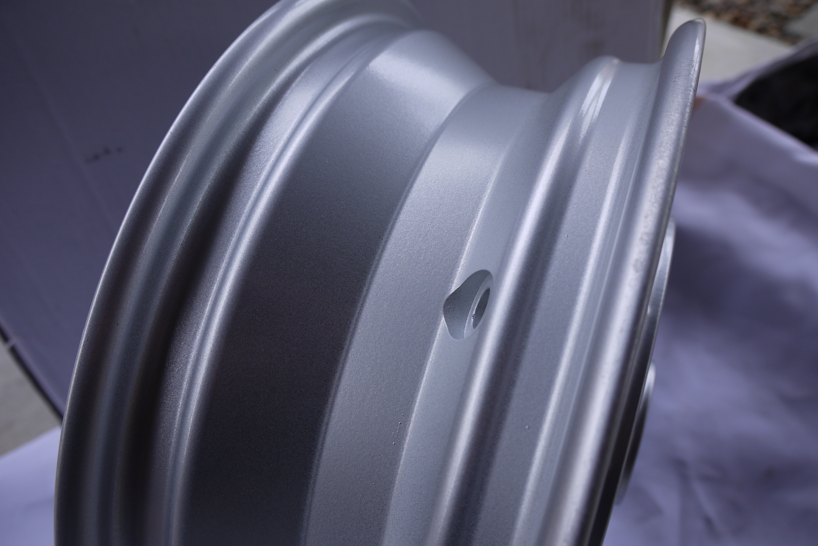

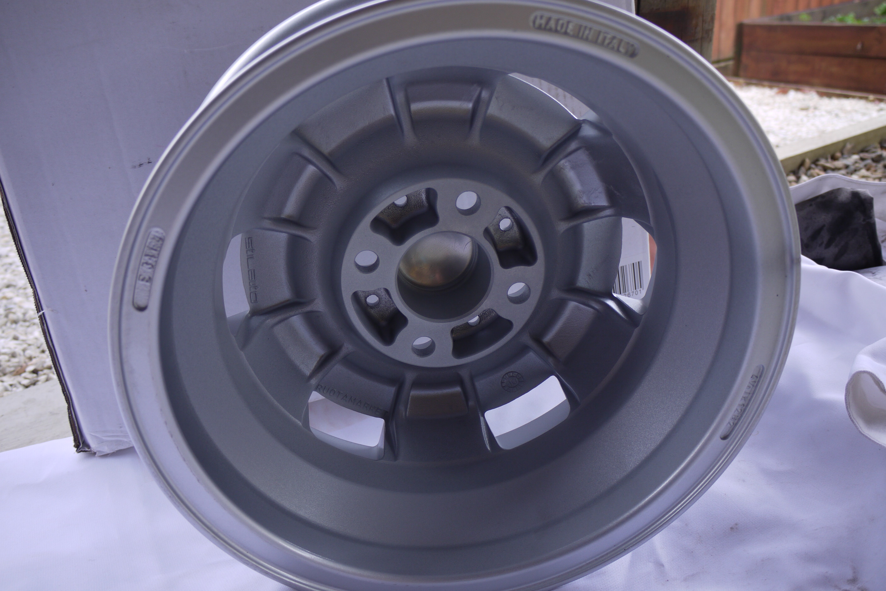

Hi Matt, these should help Santa and the elves find what you're after in their North Pole warehouse...
Roger, is there any chance you could measure the inside diameter of the alloys? I'm trying to work out if I can fit disc brakes inside them using the adapter plate method.
