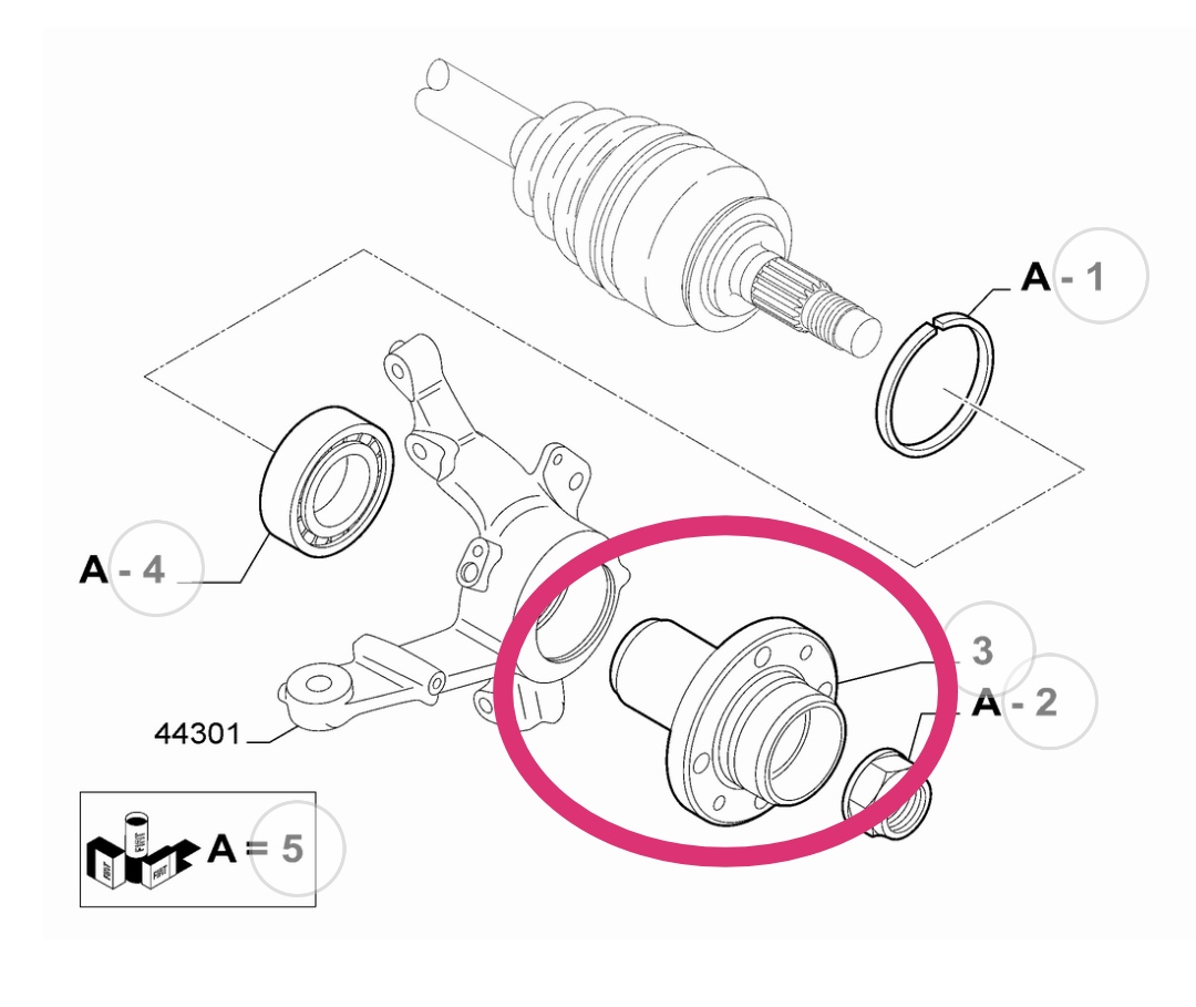

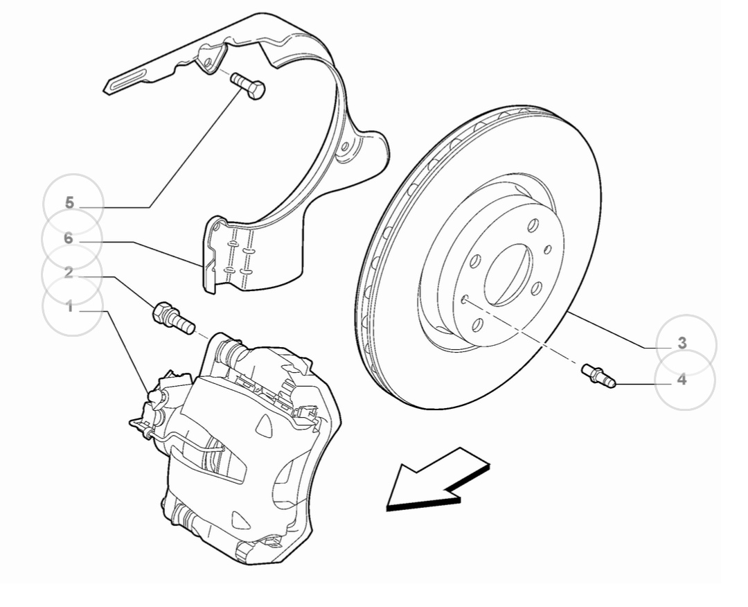

I bough new front wheel hubs, I put on new hubs at same time fitted new pads
Just to confirm, are these the hubs you replaced?
Or was it the brake discs at the same time as the pads?
The only time I've had this was due to a damaged thread in a hub stripping the wheel bolts.
Cleaning up the thread in the hub with a tap fixed it for me. M12x1.25
I would have thought new hubs should cure it, as long as bolts are the correct thread.
I would have thought new hubs should cure it.
