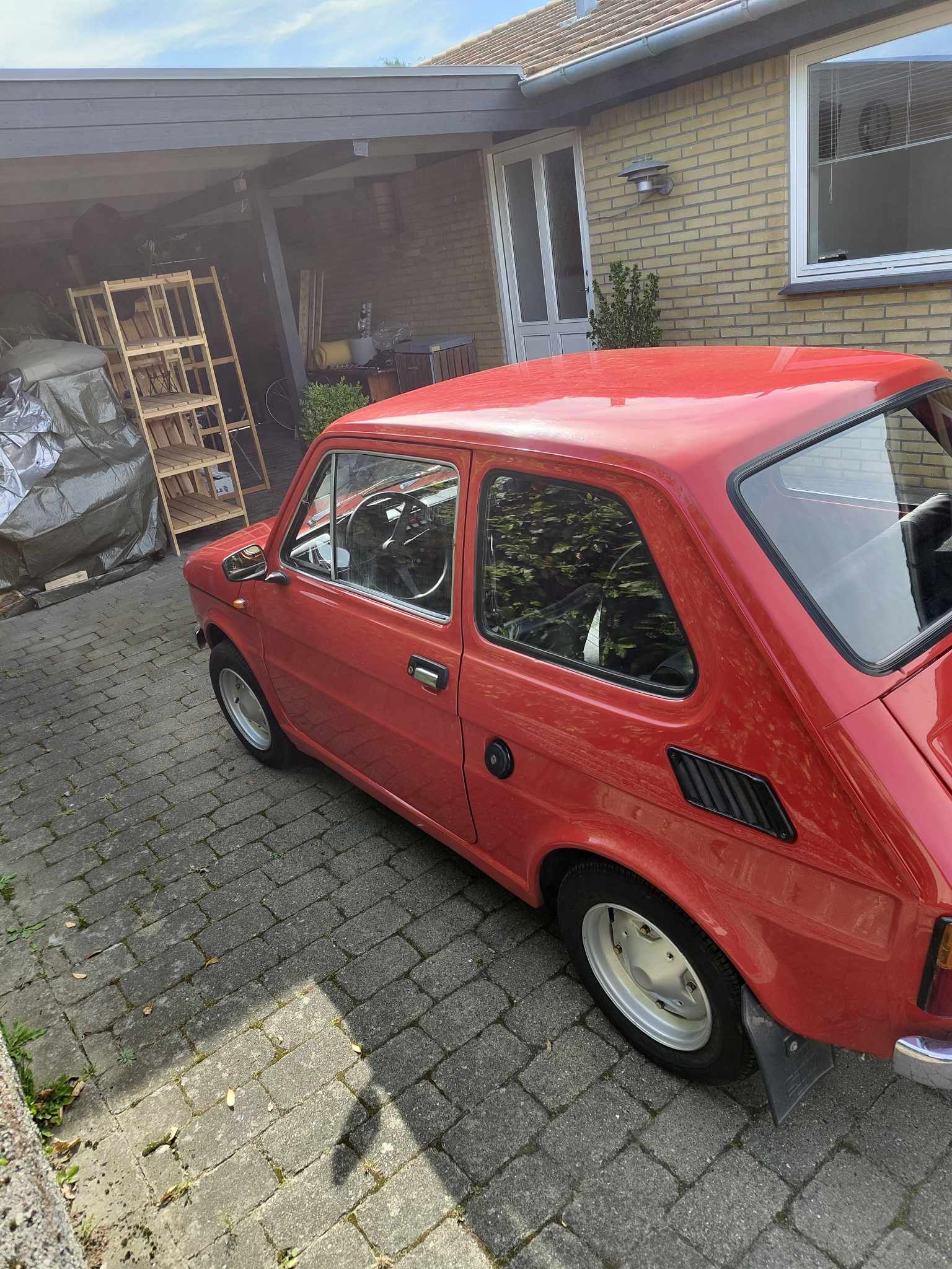

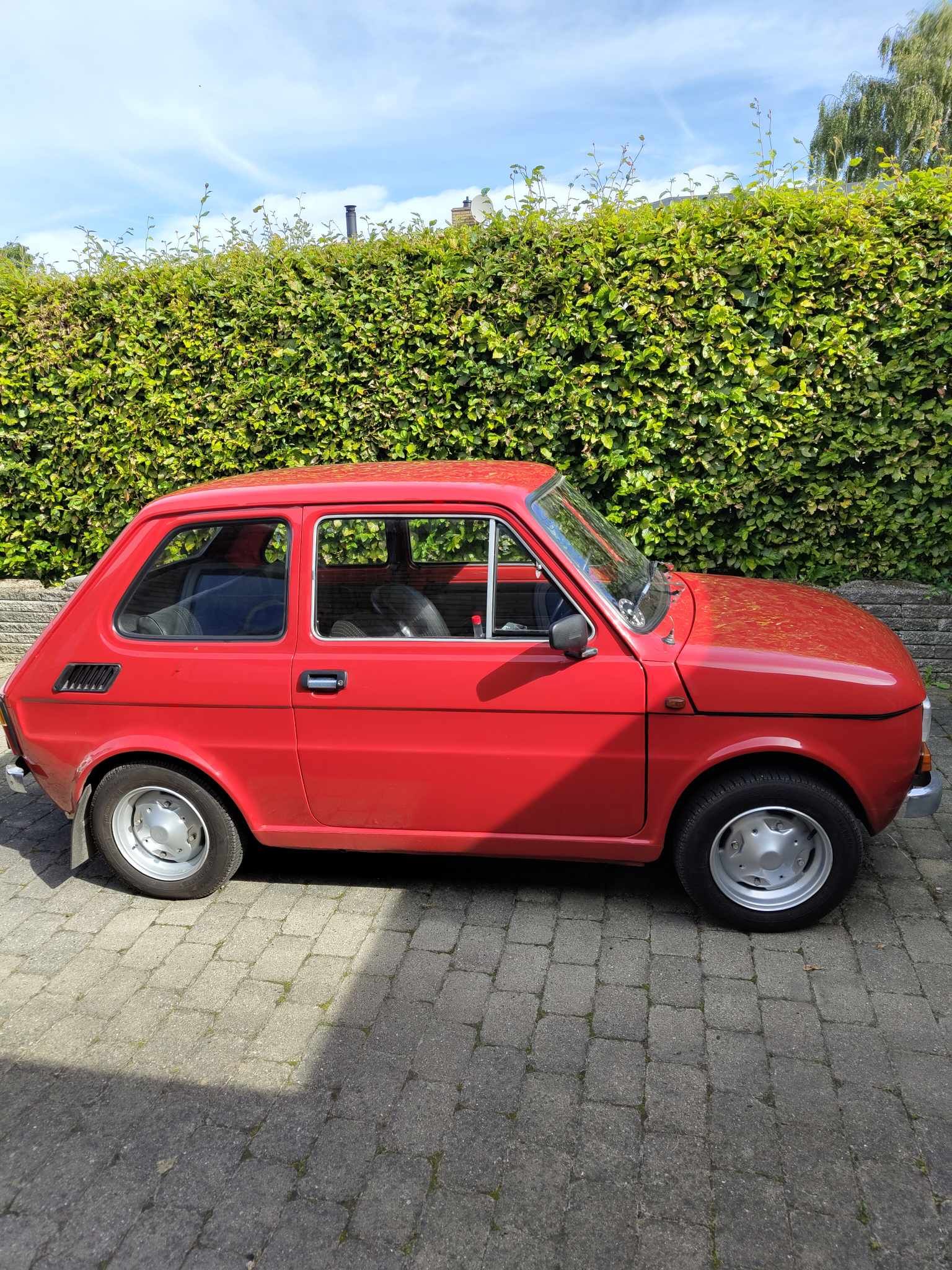

Hey, ive been told the color of my 126 is an Original Fiat color BUT i dont know which one. Can anybody identify or guess which color this is just from the photo. I need some touch up paint for rock chips. It may seem like a deep red color in the pictures but has an Orangey color to it.

Try Coral Red 135 (there is more than one Coral red Coral red 102, Deep coral red 165, corallo 193, etc)
135 is slightly more orangy-tanged (pun intended)

Thanks for your response, i can see your point with how its misleading and only now realised after reading it again (English is not my main language) It was painted within the last 5 years from what i was told, where they said that it was an originial Fiat color, wether they ment Fiat or 126 color idk. BUT i have to say that Coral Red 135 does look very much like it.

I think it may be Rosso Arancio 171 the same as my 126, it also looks red in photos but in reality has an orange hue to it.

I may be wrong but looking at both photos I'd say it's unlikely to be that (the camera always lies...), I hope we get some feedback...
Nice 126 by the way...

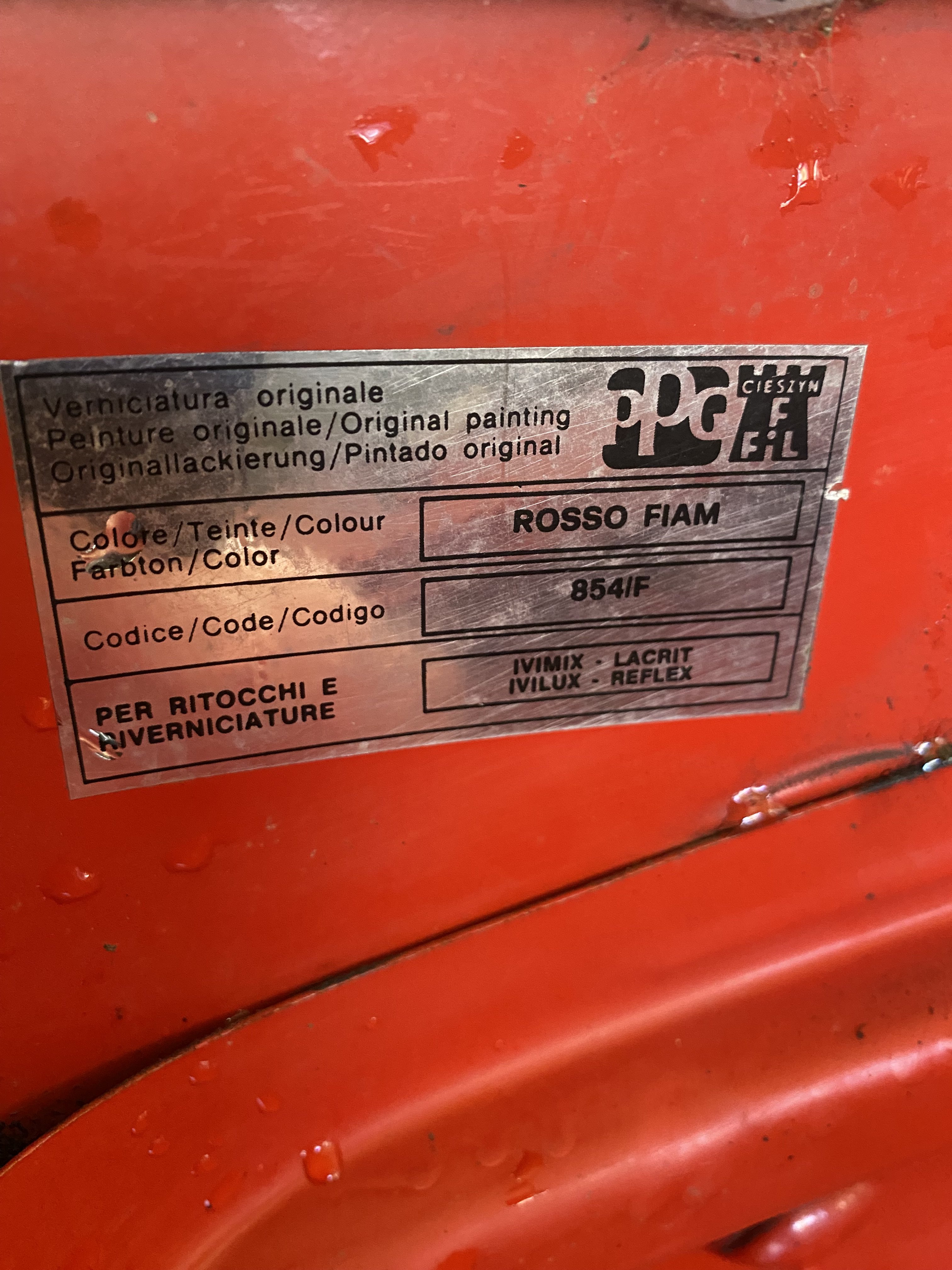

The clear coat on my 1988 126p is completely gone, but this is the tag I have attached to the frunk on the inside. Have you maybe looked there to see if you have one?
