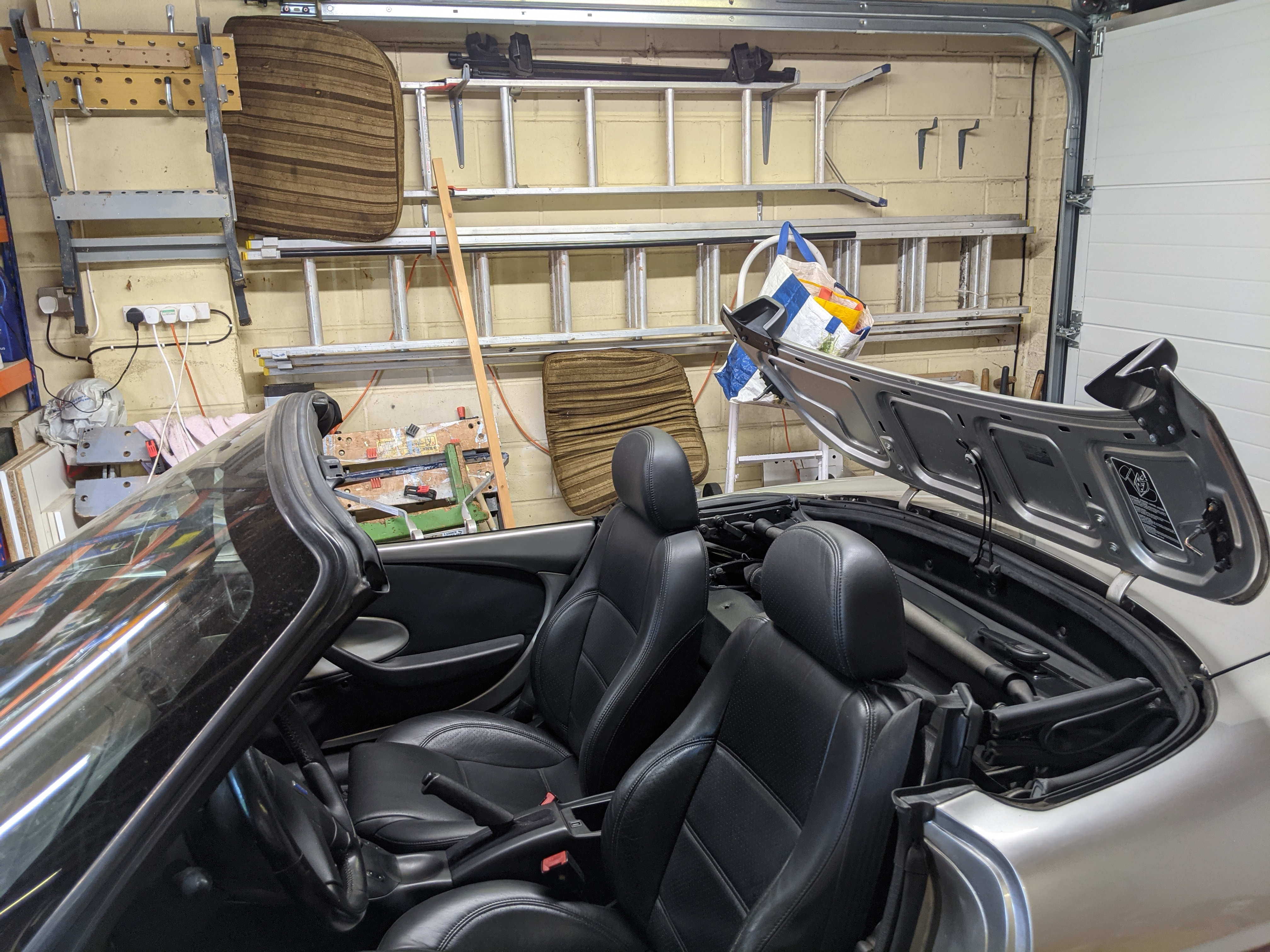

I'm having trouble closing the roof fully.
Can't get it past where it shows in the image.
It comes up easy enough and then stops solid, as if I need to pull another lever or something to release it or something silly.

It shouldn't be a sweat, but you need to get the geometry right. Have you tried lifting/folding up the rear section, then pushing the front section down, to get it in line with the middle section, and then pushing the rear section down again?
Ya, tried many combinations of lifting, pushing and dragging etc. It is like it hits a stop. Put reasonable force on it but didn't want to over do it either. Must be a geometry thing.

At the stage in the photograph I would lift the the rear section of the hood, close the cover and then get inside to bring the front down and secure with the 2 locks.
Took some photos of the sequence for my car if that's of any help. The last step where you straighten the top part of the roof is the one that feels stiffest.
