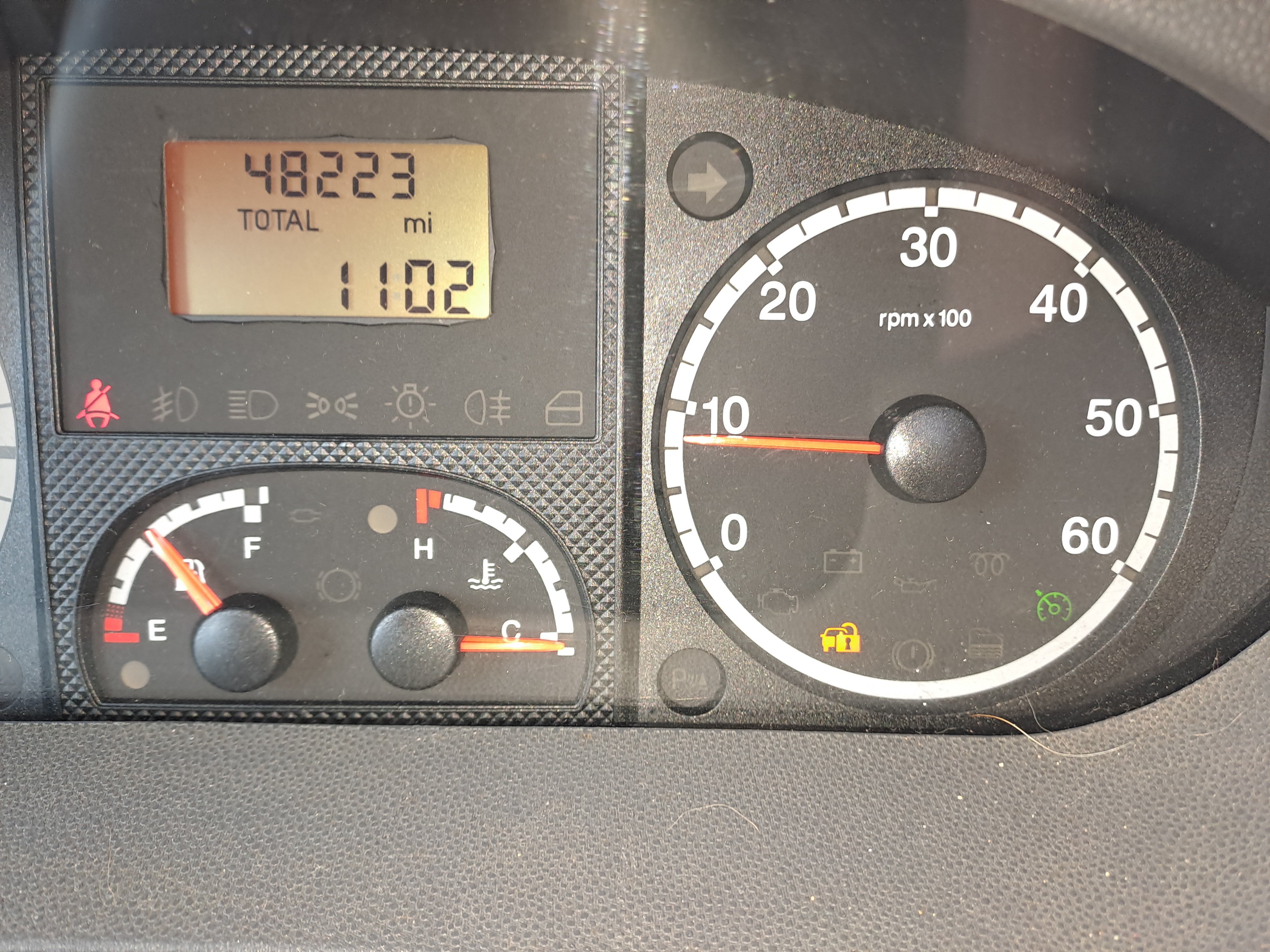

Does anybody have any ideas, I have looked in the hand book ??....Waring light, the light is a orange car with a padlock on top it just below left of the rev counter my vehicle is a Fiat ducato 2.3 multijet 2011...... see photo
Thank You Regards Mel

That is the immobiliser warning light. Usually it means you will not be able to start the engine. The engine will crank, but not fire, so do not waste time trying if that is the case.

The photo you posted appears to show the padlock on plus the engine is running? Did you start the engine with the warning lamp on?
Yes Ray ....it took some very slow turning over it sounded as if battery was totally flat but eventually it started and got me home in the motorhome.. I just hope I have not done any damage
Can you confirm that with a good battery the engine still starts but the padlock icon is still on?
If so my handbook says:
"Activation of the warning light while driving. If the warning light switches on, this means that the system is running a self-diagnosis (for example for a voltage drop)."
Shot in the dark but perhaps the low voltage caused the problem and the system is still running its test?

I think that @rayc , has already pointed in the right direction. Consider how old is the starter battery? Has it been kept charged? Also what is the condition of the battery connections, particuarly the earth. Then there is the infamous engine block earth strap, which is part of the starter motor supply circuit, but I cannot immediately see how that connection would present a low voltage elsewhere.

Hi Ray (sorry a bit late coming back to you) Yes a fully charged battery..... now it makes 2 very slow engine turn overs but it won't start at all now

All sensible input should be welconme, but I understand from post #5, that the engne was started with the padlock icon lit. So not a key code recognition failure.
A normal cranking speed is quoted as 150rpm. Determining the speed without instrumentation could be problematical. If speed insufficient to achieve minimum fuel rail pressure, then injection will not be initiated by the ECU.
If cranking speed is considered sluggish, then the fault is basic. The battery may be fully charged, but could have developed a fault. The engine earth strap below LHS headlamp is a weak point on x250 and later models. Replace, unless already done. Check all connections in the starter motor circuit, including the battery earth connection. For safety follow shutdown procedure in handbook, and then remove battery negative while making checks.
If all is good then suspect starter motor.
Thinking outside the box, has there been any loss of coolant? Does engine turn over evenly, or struggle on one cylinder (partially hydrauliced)?
I would just like to say thank you to all who replied ..My problem is now sorted.. even though my engine battery ( as its on a Fiat 2.3 multi jet on a motorhome) was reading 12.8 volts the engine would not start it tried but sounded just like a Flat battery ( it Was) and immobiliser light was staying on ?? because I could not get to my garage, my garage I use for all my vehicles (1st class they are that's why they are so busy) although the owner was very busy he came up in his own time on his way home asked me to try to start no joy.. he put a rapid booster on the jump start terminals under the bonnet 1800 cranking amps the engine burst into life and the immobiliser light went out .. he said even though the battery was showing 12.8volts on a 850 cranking battery 110 amh it must have been shorting out inside as you tried to start.. he will order a new battery tomorrow and come tomorrow on his way home and change them over for me ..What a Man...one of the best...thank you to all
