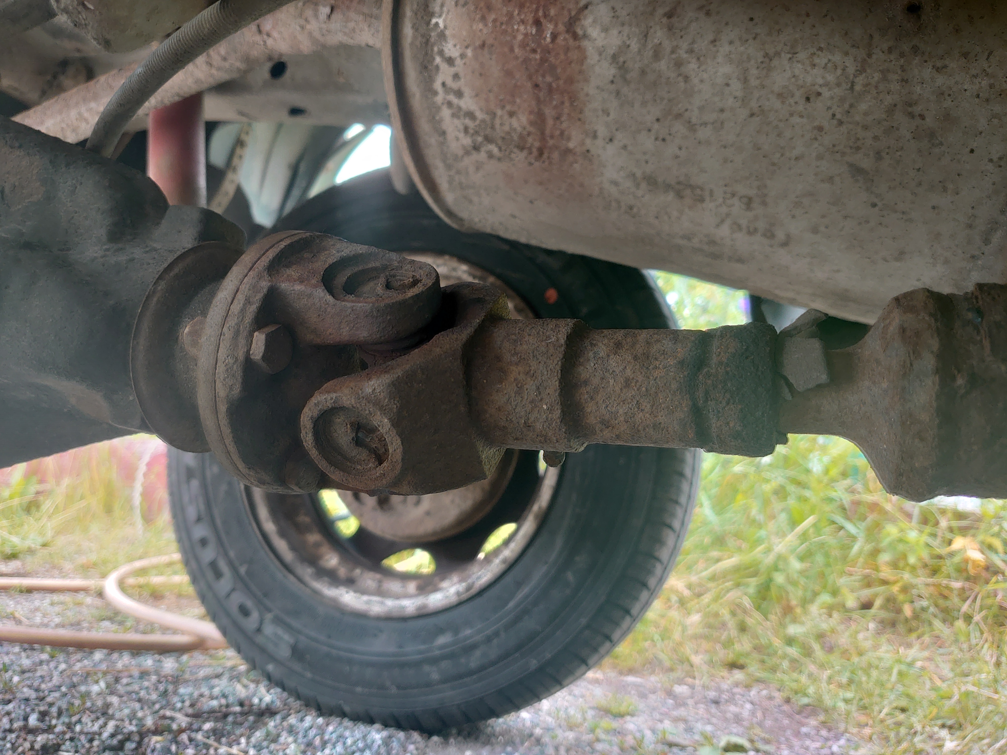

Hello all.
I have recently had some issues with vibrations in my panda 4x4 1988. The vibration starts when I hit around 80 km/h. The tires are newly balanced so that's not the issue unfortunately.
However I think (and hope) I may have found the culprit as the u-joint closest to the rear diff is failed and has lots of play.
Is this likely to cause a vibration?
Does anybody know if the part of the shaft that goes forward from the u-joint is available to buy somewhere? As you can see in the picture the rubber is broken and I would like to replace it.
Input would be appreciated.

Hello,
On the bottom of the forum banner there's a link to ePER - it's a spare parts catalogue. Your panda model seems to be covered - you should be able to find the correct part number and then start to look for it over the internet :) Good luck :)
Try searching with the VIN - it will allow to show only the proper parts. Assuming the shaft you have in your car is original. Or same.
yes that boot was broken on mine too. a cut down steering rack gator works perfectly as a replacement. if it still extends and retracts with no rotational play i would not bother replacing it. just clean it up maybe give it a nice coat of fresh paint and give it a good greasing with that steering gator boot over it all.
i would actually highly recommend completely removing and overhauling the full prop shaft.
4x13mm bolts and nuts at the UJ diff end, 8x 13mm nuts hold the central mounting point to the underside of the car (dont loose the bolts, they slide into the holders), and i think 6x 6 or 8mm allen key (hex slot) bolts hold the front CV to the gearbox.
the CV joints may be ok, just the rubber gators need replacing. again you can just use universal CV boots as a good replacement over the whole CV joint as the original ones were hard to get.
for the centre prop shaft bearings you can quite easy make replacements using the same sized bearings, steel braided wire, and polyurethane bonding (like tiger seal)... (as i know centre bearings are practically impossible to find now). for added durability you can fit a worm drive clamp around the whole thing over the central mounting plate and over the top of the bearings. i made these for mine and they are still in perfect condition.
the UJ is a standard size thankfully and can be bought from ebay or other places. they can be a pain to get the retaining clips out but its not impossible mine were stuck in pretty good and broke into many bits but i managed to pick them out and press the UJ out with a vice and 2 sockets.
one thing to do if you dismantle your prop shaft is to mark every component! just a simple indent from a hammer and chisel is enough just so when you rebuild it, you get everything aligned up. getting things out of alignment will cause it to vibrate. i have rebuilt 3 so far the first one i did not mark and it vibrated badly. i had to make a balancing jig using lengths of angle iron and a battery drill to spin the prop at different speeds to check for vibration to see if it was in the correct alignment. after taking it apart many times and trying different parts at different angles i eventually got it correct again.
should parts be hard to find,
i hope this helps...
Thank you for the thorough reply. I actually refurbed the front half of the prop shaft only about two years ago so the CV joints and gaiters are basically new. I will remove the back half though, as the rubber mountings on the support bearings are held in place with cable ties at the moment, and I have had new bearings laying around for a few years just waiting to be put in.
When I replaced the CV joints I too forgot to mark the alignment.. luckily there was a rust spot on the face of the mating surface that helped me identify the correct alignment. Balancing sounds like a nightmare.
