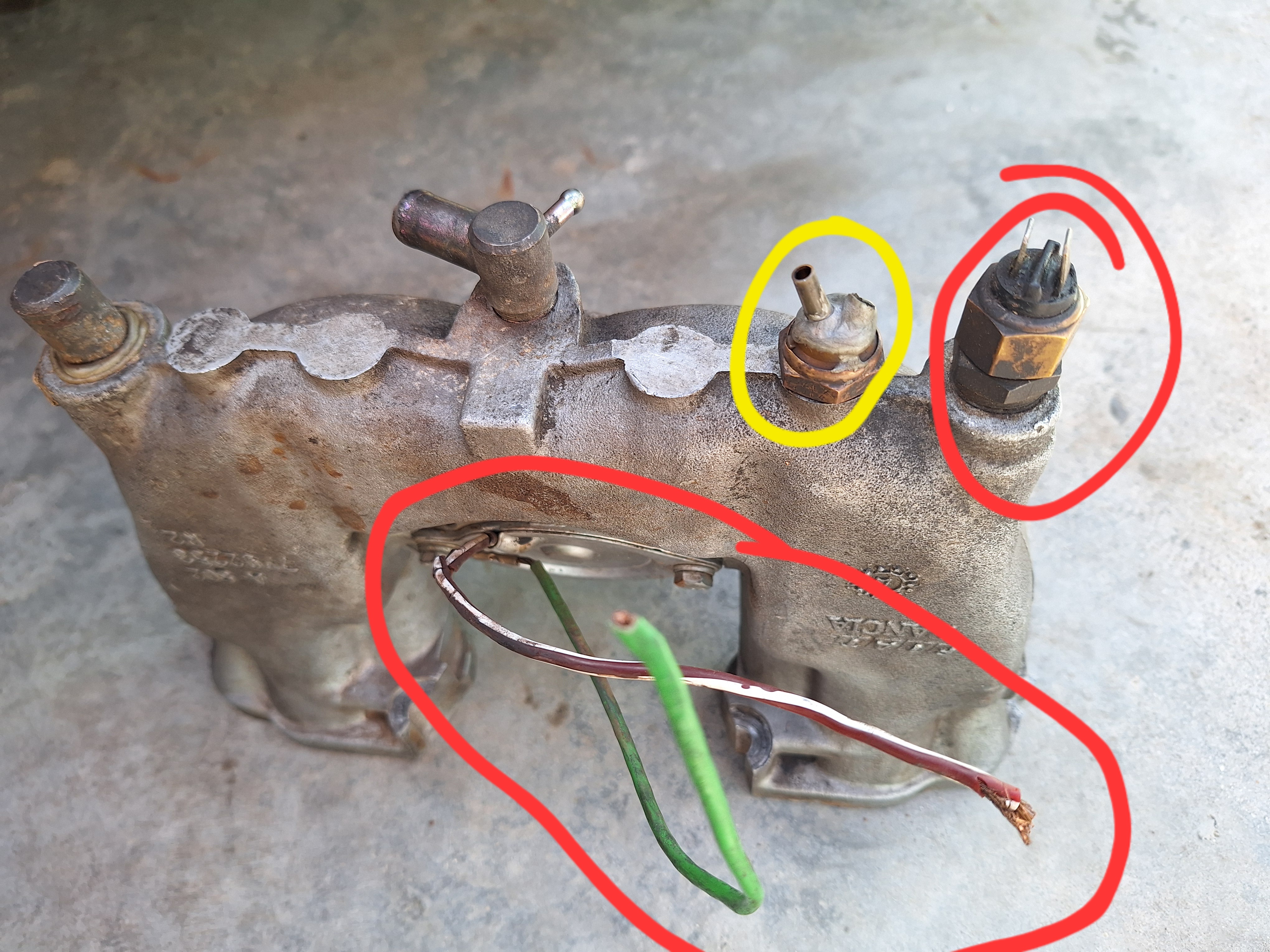

Hi All,
I'm busy restoring an Uno pacer 1.4 carburettor model 5 door with electric windows. It's been a bit of a challenge since the wiring harness has been hacked one too many times. I'm working at my own pace and deal with one issue at a time.
I'm struggling to figure out the wiring of the inlet manifold sensor and resistor heater see the attached image red highlighted circles. Then the vaccuum highlighted in yellow i managed to get a new one but not sure how to route this to the carb. Any tips or advice will be appreciated. Thanks in advance.

In your picture the large central manifold pipe assembly has two functions. 1) the larger diameter pipe is for the brake servo vacuum tube 2) the small diameter pipe should have a hose on it going to the item ringed in yellow.
The yellow Item is a thermal vacuum switch. The outlet pipe on this is clearly broken off. A small hose would connect to this and go bank to the carb.
The two terminal switch ringed red is (I believe) the thermal switch that would turn the power on/off to the resistive heater you have ringed in red. On that one lead (green) would go the earth and the other (brown/white) would go the the thermal switch. The other side of the thermal switch would go to +12V fed via the ignition switch.

Hi @s130 , thanks for the detailed explanation, I have attached the images requested. I have also purchased a used thermal vaccuum switch to sort the broken one in the previous image so will try your suggestions and let you know if I succeed.

Ok I managed to get the car started and the routing according to your instructions, everything seems to be working as expected just need to sort out the carb tuning. Thanks for all your help @s130 and @peterdt0260 .
