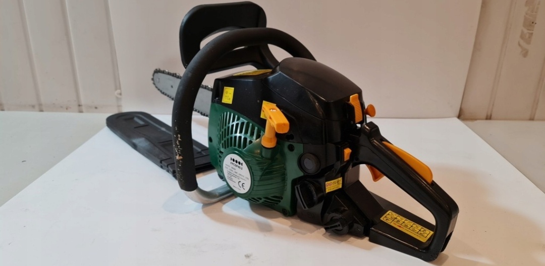

I have a couple of problems:
1. Chainsaw wont rev and dies on idle. I have to keep squeezing the throttle to keep it running. It'll rev for a while but then die and struggles to start.
2. When it does idle, the chain is turning.
I have a couple of ideas why:
1. Low jet needs adjusting? Running too lean?
2. Idle speed too fast?
It's a 40cc petrol chainsaw. It's also a cheapo, bought from B&Q in the UK, I suppose their own brand, manufacturer's label is Kingfisher from Netherlands (model fpcsp40-2)
I've had it 3 years, didn't use it for a year (drained fuel tank), fired it up to clear recent storm damage and it won't run properly.
To my surprise, nobody around here knows anything about tuning the carbs. My neighbours all take them in, spoke to the shop and they don't adjust them, they send them away. Which they won't with mine because it's an unfamiliar make.
They don't sell any tools for adjusting the carbs. Mine needs a 'PacMan' tool.
I tried a new plug and new fuel, but no improvement.
I'm at the point of ordering the tool I need and adjusting it myself. I have a bit of experience adjusting jets on carbs on old cars, but no experience of two strokes.
Am I on the right track? Any advice would be very gratefully received.
