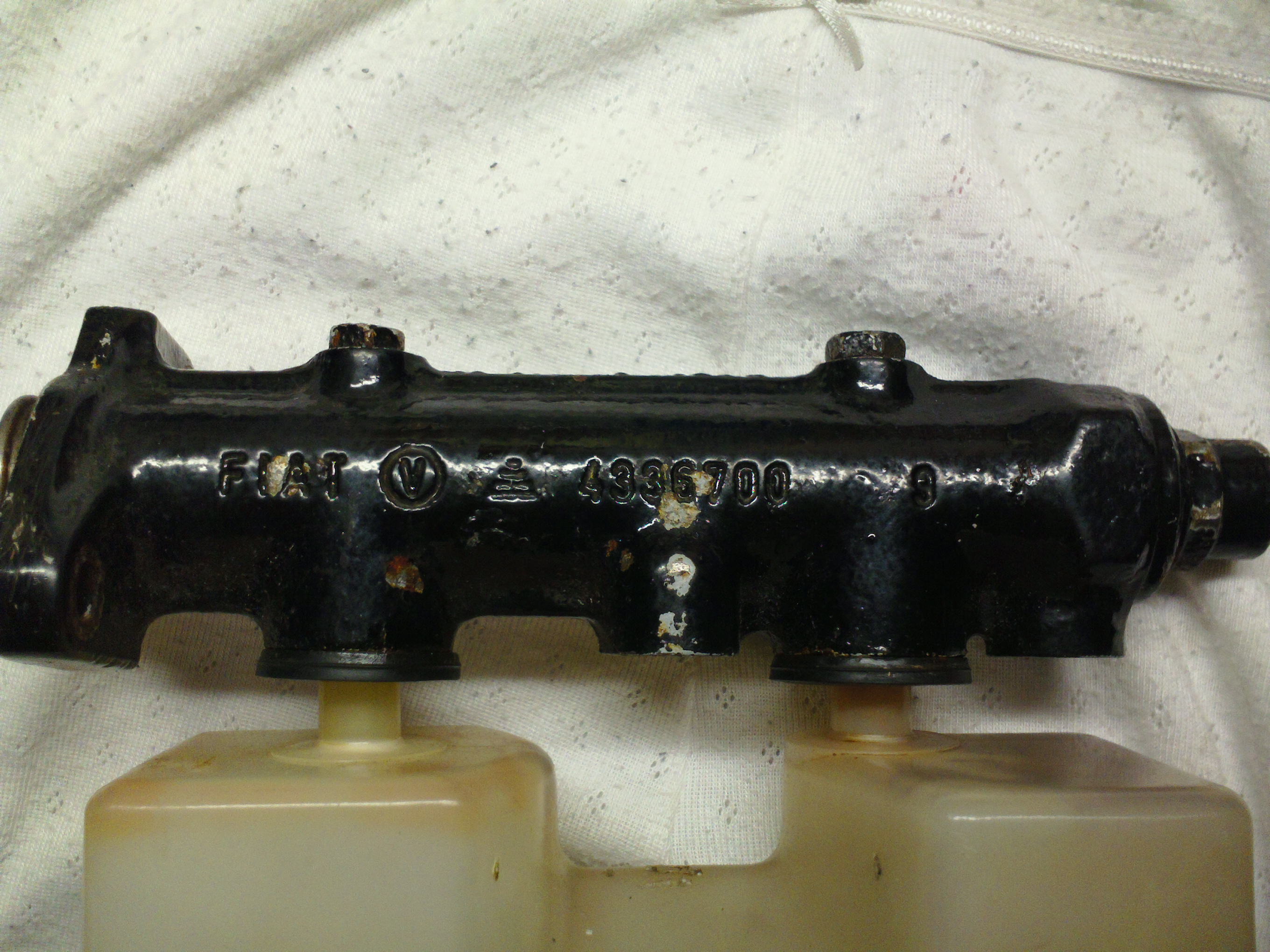

Hi, a newbie here who has joined the forum for a specific purpose. I have a Citroen 2CV which has been fairly drastically modified and is fitted with a Rover V8, Jag back end, Viva front end and numerous other odds and sods. The brake master cylinder is Fiat.....and has given up the ghost.
I have 2 easy choices, get the one I have rebored and lined....or get a new one. The problem is I don't know what model or even year of Fiat it is out of. The 2CV was originally built in about 1990, so I'm guessing the master cylinder is from the 1980s.
I am attaching some photos, but a brief description is:
Fiat dual circuit master cylinder with number 4336700 on side and then the number 9 about 30mm to front. Total length 190mm from servo flange to rear brake pipe exit. 19mm bore.
Dual front pipes come out on top, 95mm from servo flange, single rear pipe exits at front of master cylinder.
85mm between centres of front and rear reservoir inlets.
I've just been to my local Fiat garage and some specialist motor factors, but have drawn a blank. Can anybody on here help identify what car it is from.
Thanks, Colin.

Thanks, I had tried all sorts of Google permutations with the number, but never got anywhere. I followed your lead on the Fiat 131 origins though, got through to Recambio and identified one that isn't quite exact....but close enough.
£50 delivered to my door.
Brakes now working and project slowly gaining ground again.
