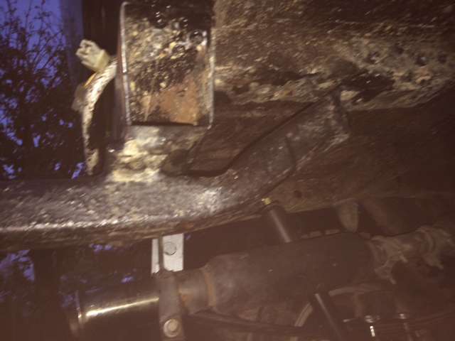

Just wondering what the tow bar options are (rear and possibly front)?
Looks like one was fitted to the rear of mine but no real clues and no bolt holes in the floor?

The rear fits on the upstand in the centre of the bumper if you still have one then cranks down to the central floor member for about 250 mm where it is bolted also
Front front near side if fitted here from the front cross member then bolted as a bumper sandwich
Best tapped m16 holes so it can be removed. With bolts left in and then well greased.
Both are usually made up from 50mm box section
If a bull bar is fitted sometimes they can be incorporated with the n/s upright

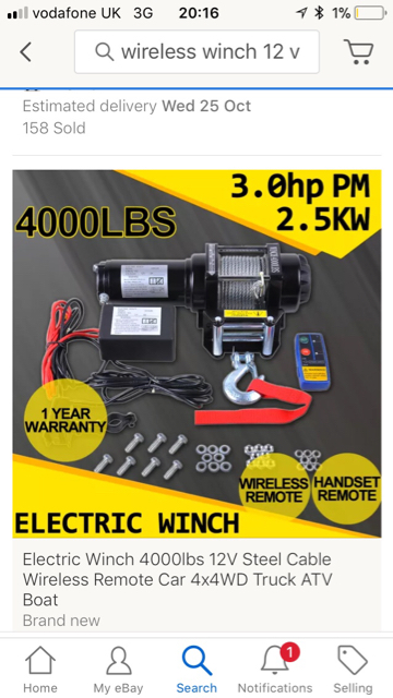

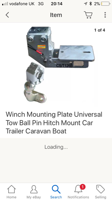

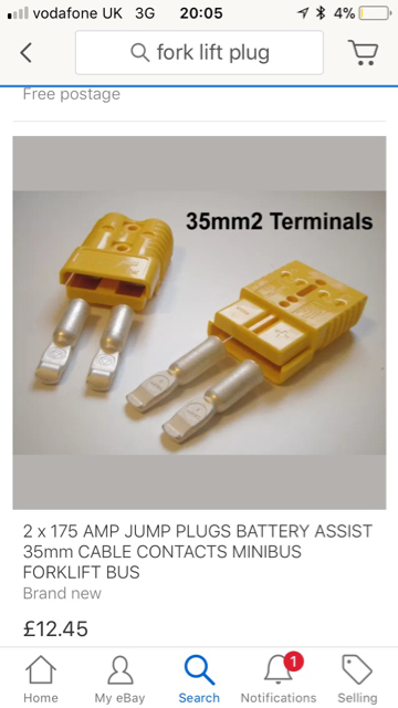

Dc if you thinking of a winch get a tow ball mounted one it then can be fitted at either the front or rear wire some 10mm cable to both point then fit a fork lift or floor polisher charger plug to each point. Just plug up and go if get a wireless model
Winch
Plug
Adaptor plate
This could easily made up just with a hitch and steel plate

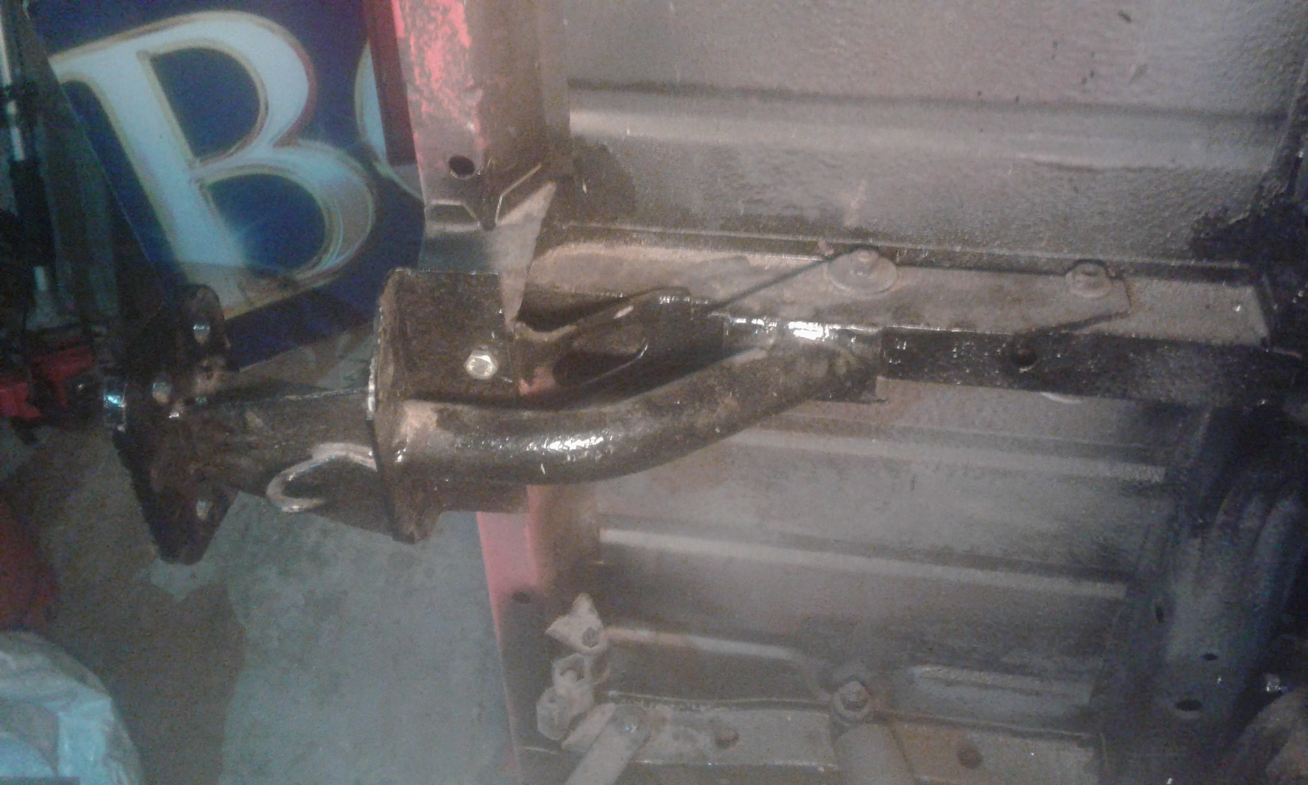

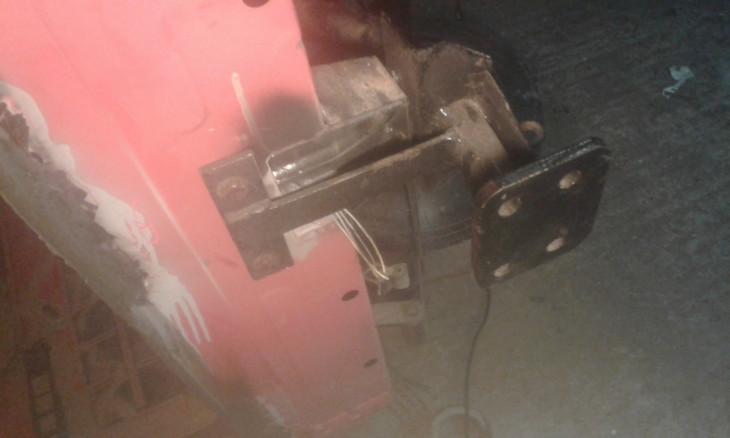

I have this;
and this:
So I guess I am looking for the same 'arm' as binhoker?

I have this;
and this:
Well yes unless you have accses to a welder . Then it’s 2 hours fabricating one. Try. Subito. Or eBay it. Or ask Luca for help finding one sj
