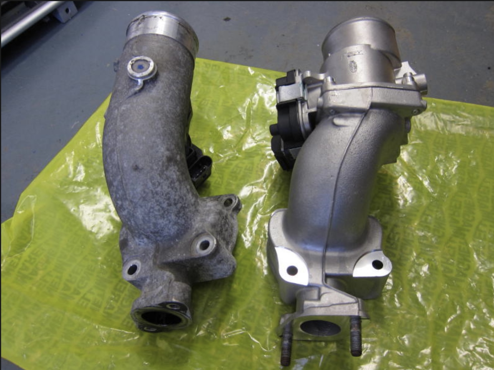

L LandyAndy Member Joined Aug 16, 2022 Messages 122 Points 74 Location Hertfordshire Jul 27, 2024 #2 Genuine. Got mine from coastal motorhomes who had everything in stock, great service and also have eBay shop if preferred. You also need the conversion loom, and whilst doin* the job check your EGR valve is sealing shut, and cleans your MAP sensor.
OP OP R Rowey73 New member Joined Jul 25, 2024 Messages 2 Points 1 Location Newcastle Jul 29, 2024 #3 LandyAndy said: Genuine. Got mine from coastal motorhomes who had everything in stock, great service and also have eBay shop if preferred. You also need the conversion loom, and whilst doin* the job check your EGR valve is sealing shut, and cleans your MAP sensor. Click to expand... If I am using original parts why is the conversion loom required Thanks
L LandyAndy Member Joined Aug 16, 2022 Messages 122 Points 74 Location Hertfordshire Aug 1, 2024 #4 Rowey73 said: If I am using original parts why is the conversion loom required Thanks Click to expand... Because the replacement is a newer and updated/improved part with a different wire connection.
