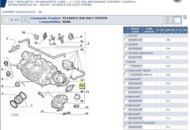

Im not sure it is right but have a look at this PN:46473851 (18 ELECTRO-VALVE)
I thought it was that aswell adrian but it doesnt 100% look like the part as there is no diamond shaped bracket with the 2 screws on it...not that eper drawings are that clear anyway.
That part is £130.
I've just checked and old Fiat Compact Parts CD Ed.22 Date 03-1999
This shows a solenoid throttle body valve with Part No: 60608904 costing £123.89 in 1999
In Jan 2009 this part is listed at £220.32 (including VAT) and show as used in:
Bravo, Brava, Marea, Coupe, Barchetta, Delta and Dedra models.
Bit that really puzzles / concerns me is the MASSIVE price hike, almost doubling in 10 years, plus the fact that the part on the latest ePER is not listed/viewable.
