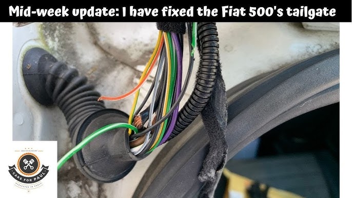

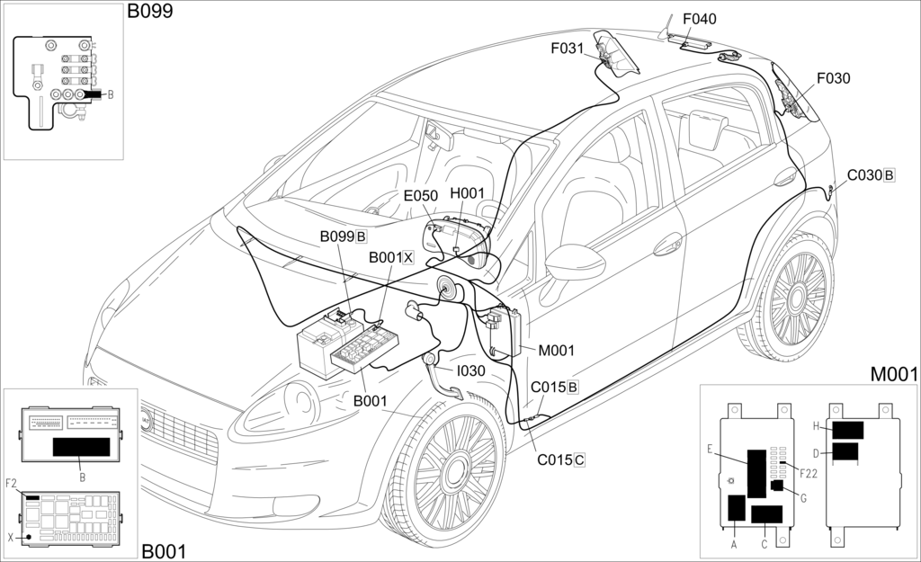

If the other brake lights work, then it is not a blown fuse. Only thing that is left, is the usual suspect, broken cable inside the rubber boot of the back door. I'd start from there. The one near F040.
If the other brake lights work, then it is not a blown fuse. Only thing that is left, is the usual suspect, broken cable inside the rubber boot of the back door. I'd start from there. The one near F040.View attachment 452450
Broken cable as in actually broken? Cause when I replaced the third stop the cable looked fine from what I could see, but couldn’t see much.
