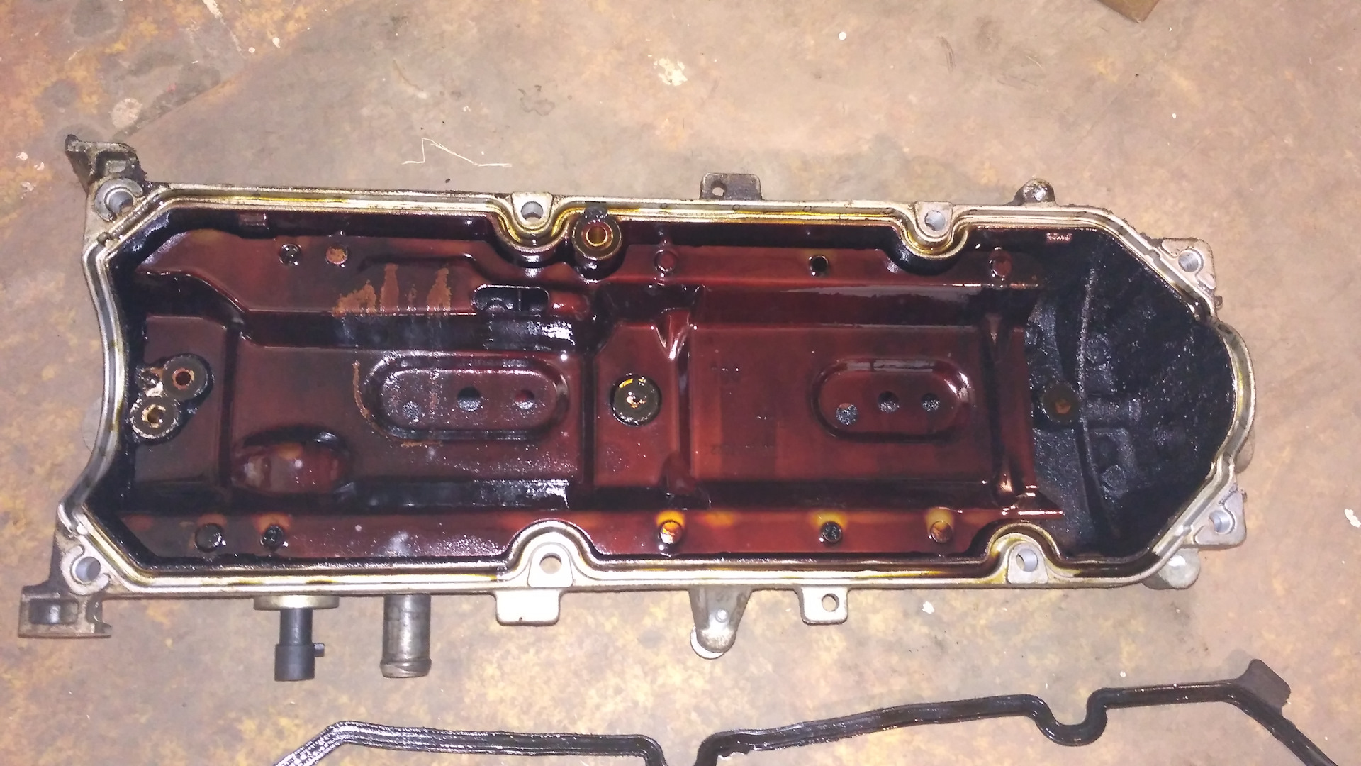

4. Maintenance history (is the car treated well or neglected/abused), are there regular oil changes, sparkplugs and so on. Valve lash/clearance ever done or not yet? Is the engine clean inside or it's a mess like that (picture below)?
d4aaagol8oa-1920-jpg.458887
