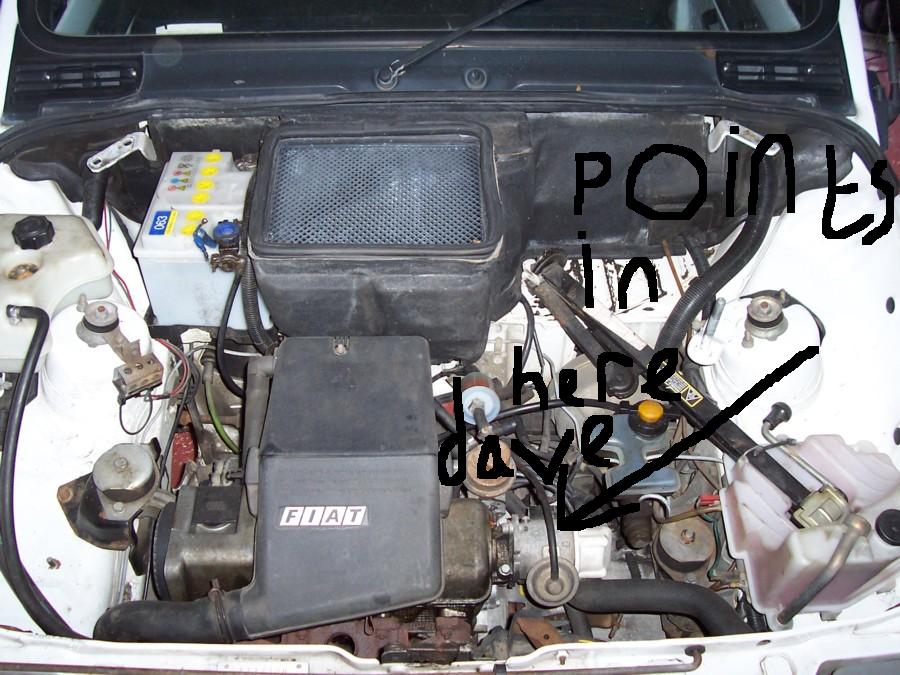

6 months ago my 750 running very rich when it went for mot (passed though). i tried adjusting carb but couldnt get it right must be blocked jet, i didnt want to have it off road to long so got another carb or ff member, i just got around to fitting it :eek: but bugger wont set up, i using colour scope thing but cant get yellow flame only blue. ticking over fine but as soon as i rev it it cut out, it set it now at 2 turn out on mixture screw flame nice bunsen blue and it didnt cut out when reving, but then i die. i sent her out for more petrol hoping it that but still cant work out why i couldnt get a yellow flame:confused:
check your vac unit on the dizzy if thats split you wont be able to set the mixture up as it will be pulling too much air in and will run weak. i have had this alot on fire engined fiats when they come in for service. if you need a vac unit Dave let me know and ill bring you one to mitcar (if i can find one):p
i needed it to go out as punto fecking broke so cleaned old carb put that on an popped out, it still running crap, and had pre igintion very bad when i got back ( why it called that when it happens after ) i look inside dizzy cap and contacts are very worn so think i best go get new one and rotor arm.
there isnt any points on this is there?
white cap marelli dizzy, black cap ducellieur dizzy iirc dont hold me to it though:chin:
Remove dizzy cap, rotor arm then a plastic disc. The points live behind the disc.
Dave.
Your distributor has a black plastic cap.
Does it also have a black plastic unit screwed to the side of the distributor with a cable and plug from the wiring loom connected to it?
Rgds.
Then the points are under the alloy plate that you can see when the cap is removed.
Rgds.
