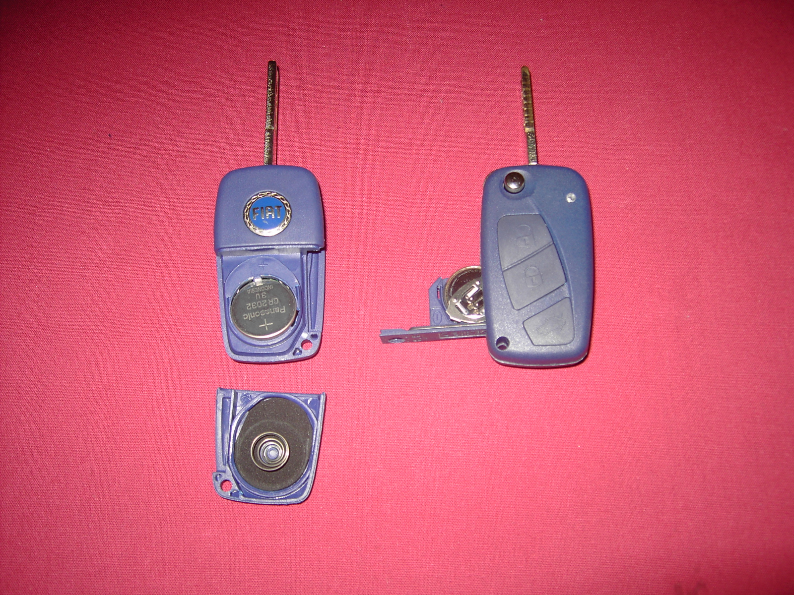

Assuming it's the old style key, flip the blade out and there's a quarter turn screw in the blade recess. Turn the screw then hinge the battery carrier out.
If it's the new style key, remove the battery cover to reveal the battery.
Both versions use a CR2032 battery.
