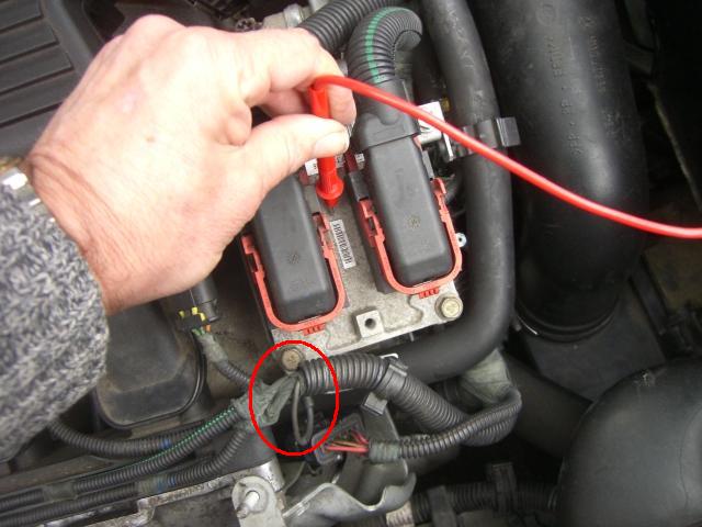

The ECU earth is here circled in red but to check the earth then all you need do is have the engine running, multimeter set to volts and check voltage drop between the ECU mount where I have the probe here and the battery earth. You should see near 0v and definitely not more than 0.5v. That's it, earth checked
