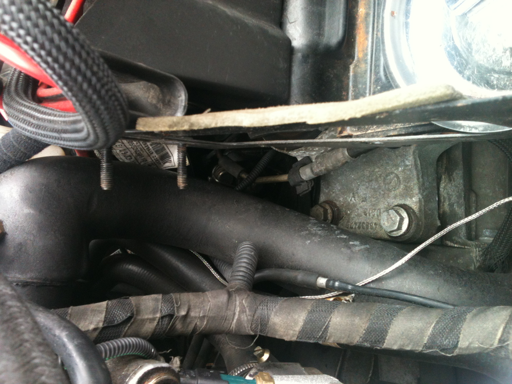

just done this on my jtdm 150hp
wasn't too bad a job on drive on ramps, not sure if similar linkage to the others but mine uses 2 platic top hat bushes, seem to be squeezed tight by corroding ally housing
had to remove my ecu and battery and even then I was mostly still squeezing down gap by brake master cylinder and under car reaching up.
an extending magnetic stick helped a lot as only room for one hand .
might have been the effort to remove the hard plastic boost pipe that was in the way but I didn't.
opened the ally hole with some sandpaper , polished the bolt and ball nipple used silicone grease on bushes and inside.
all ok self centering has returned.
I measured the old and new top hats and got a feeling the new bushes were 0.1mm thinner(considering my old ones done 55,000 miles,maybe more) giving it clearance before pinching up the shaft ?
thanks for the guides and links.

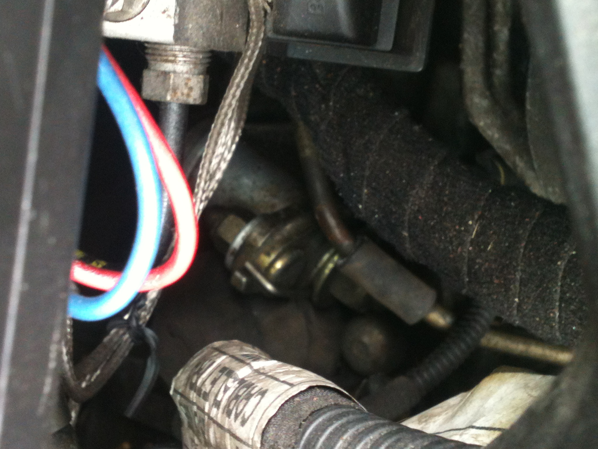

as was before new bushes

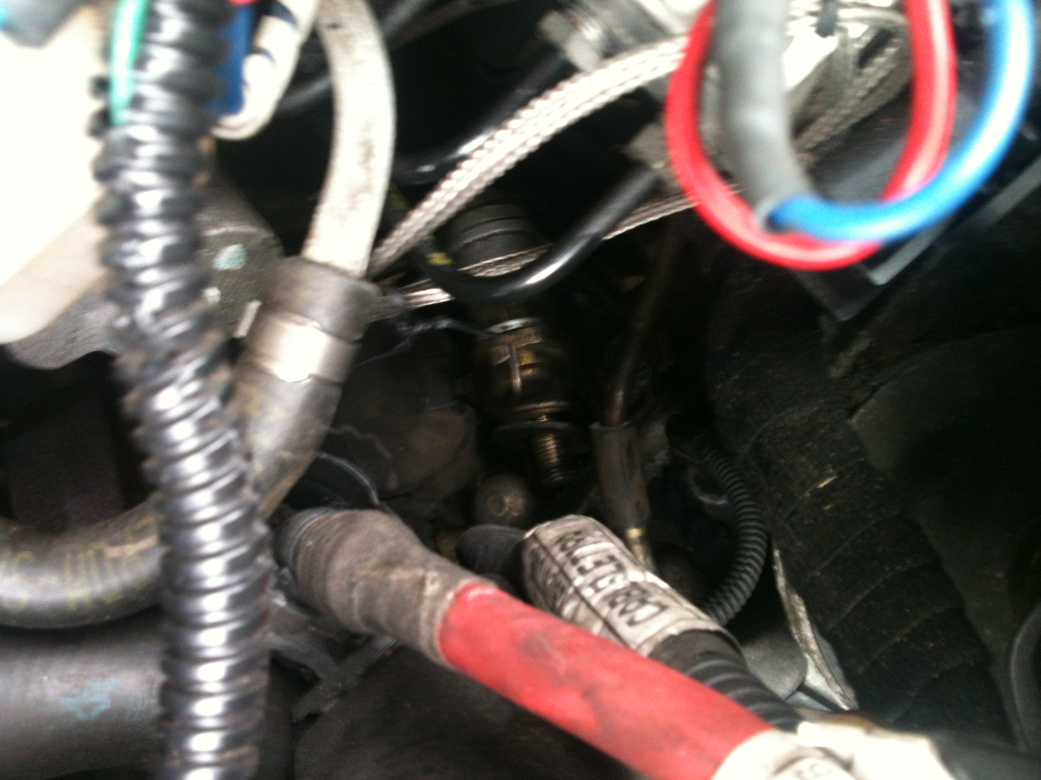

as now after new bushes

had to be done as was struggling to get 5th to 6th this week , problem got worse with hot weather and also longer journey , ally expanding and pinching linkage even worse.
Wow thats amazing wish my gear did that lol - so you used ramps, so the issue isnt at the top of the gearbox?
Sorry just read that properly of course its at the top ... Silly me! , why did you need ramps?
to pop off the cable ball end to the lever, and lever out the shaft i think if it was left attached it might bend or kink the cable ? , the alfa guys tap it out from above but that boost pipe is right in the way.
ive never had that pipe out so didn't want to waste time trying to get that out .
I needed some long extentions and flexi knuckle to get the 17mm undone, really I was struggling a bit for tools.and also it might depend a lot on size of your hands i could just squeeze down the gap, the magnet on a stick was a big help as it helped get out the nut washer and arm, helped get the socket and knuckle onto the nut etc.
i wasted a bit of time trying to make a tool to sand the bore(sandpaper taped to sockets etc) , but ended up with a roll of sandpaper sqeezed in there, and worked from both ends from above and from below.
