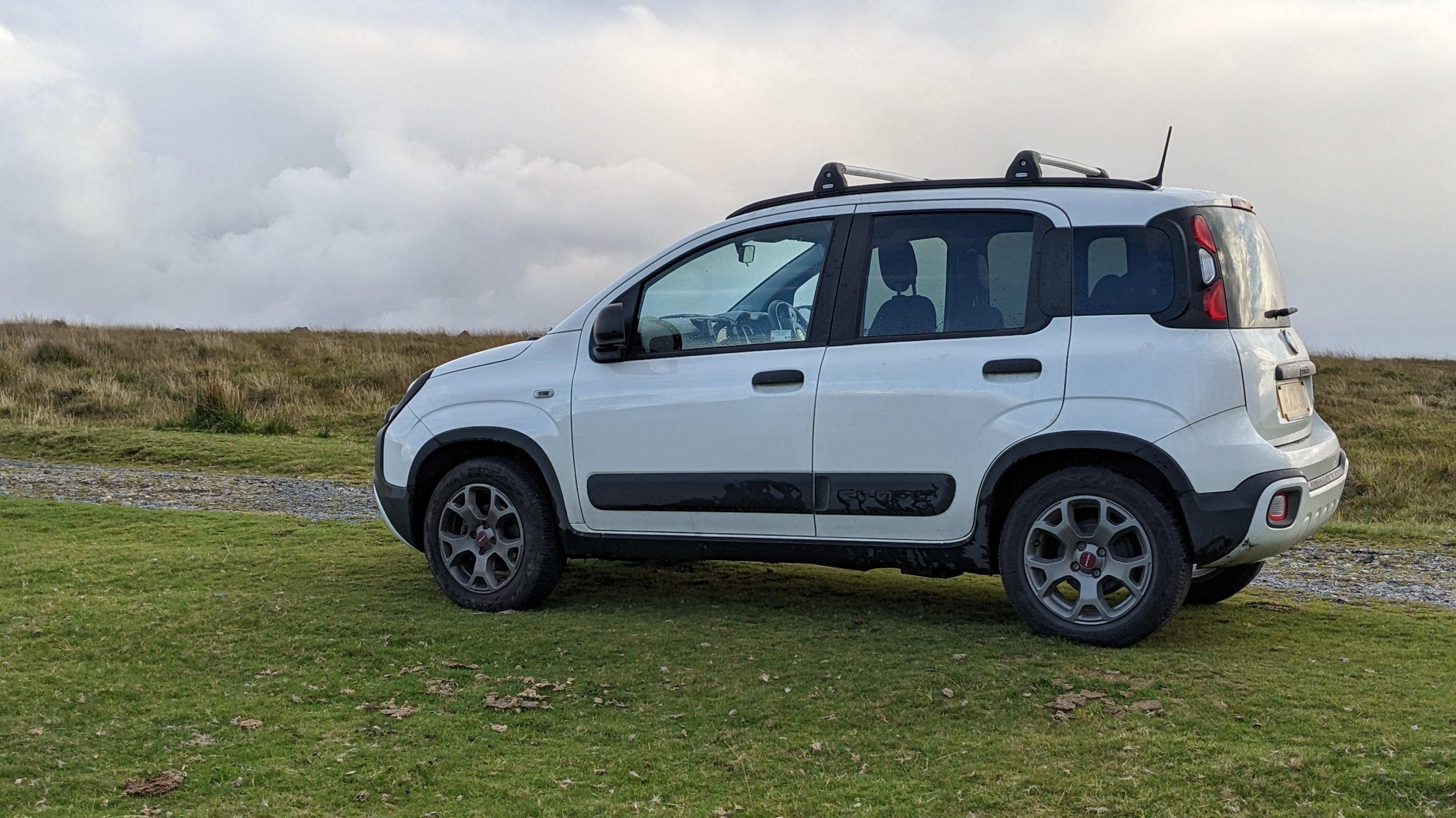

Hello!
I have a 2021 panda cross hybrid. !6k miles done so far. It is awesome for the most part although I wish it had a little more grunt uphills!
Recently it has started squealing like crazy when I am coasting in gear - the way that the hybrids charge their batteries. I have been looking for not found any other descriptions of this fault. No recalls or anything.
I'm assuming that there is a belt or a pulley issue. The fault comes and goes - I took it to my local garage this morning and naturally it wasn't making the noise at all.
It tends to happen on a longer run, once the engine has warmed up a bit.
Has anyone else come across this problem? Any clues?

Nice looking car btw.
