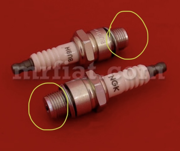

Are you guys using this plug? Mr. Fiat.com sells this NGK for the 500, but I’ve never seen a plug like this…..check out my pic please. Thanks!

Those are very similar to the plug style found in 2 stroke mercury outboard engines. Flat electrode and no adjustable spark gap.
I honestly dont know how those would perform in a fiat engine. They are usually used for engines that have odd geometry and dont have sutable sparkplug tang to piston top clearance at times.
