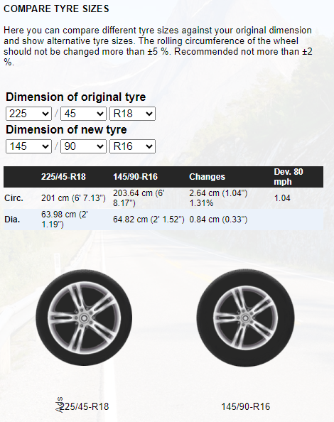

I believe it is the "rolling circumference" that is the critical thing.
Space saver wheels are always much skinnier than normal road wheels which is why they have a lower speed recommendation.
So even with a smaller diameter providing the profile of the tyre is larger to give the same overall circumference then all should be fine.
On my 500X 2015 the supplied space saver is:
Space-saver wheel (where provided) Rim: 16 x 4.0Tyre: T145/90 R16 106M
