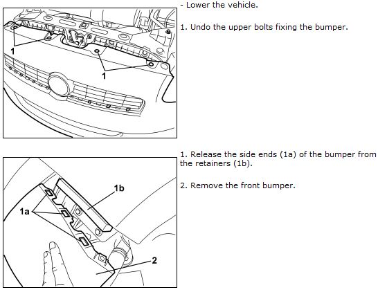

Hi,
This Sunday I found my car with the smashed front bumper smashed, the headlight retaining/fixing tabs broken, the fog light is also broken.
I think the bumper can be rapaired with a bit of plastic welding.
But before i atempt this i want to know as much as possible about removing the bumper.
Can anybody help with a bumper removal/refitting guide?
a schetch with all the screws... any retaining tabs..etc.
car: Bravo 198, from 2008 1.4 120 T-jet
I never find what i want in the version of e-learn i have at home.
Any trick to using it?

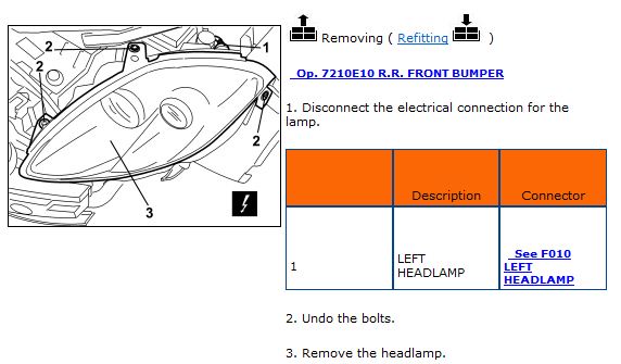

Fiat supply repair kits for the headlamp brackets. I think the part numbers for the Bravo are: 71749158 for the right headlamp and 71749159 for the left headlamp, but check with your dealer before ordering them. They are about €25 each.

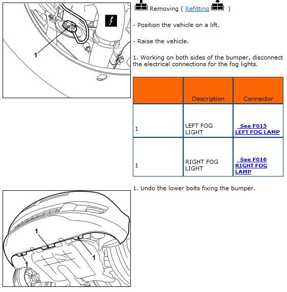

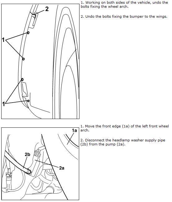

This is from eLearn for removing the front bumper and headlamp.
