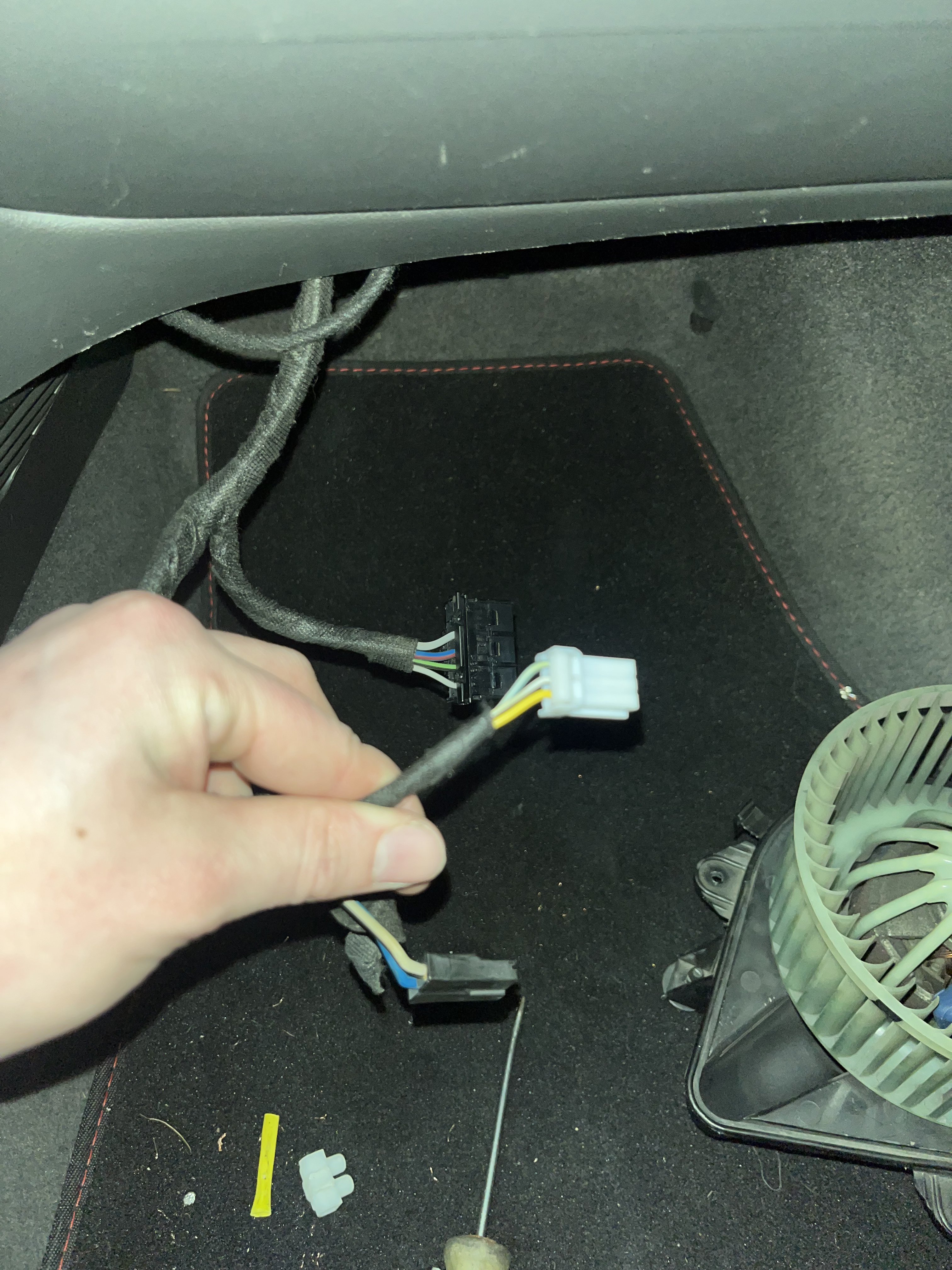

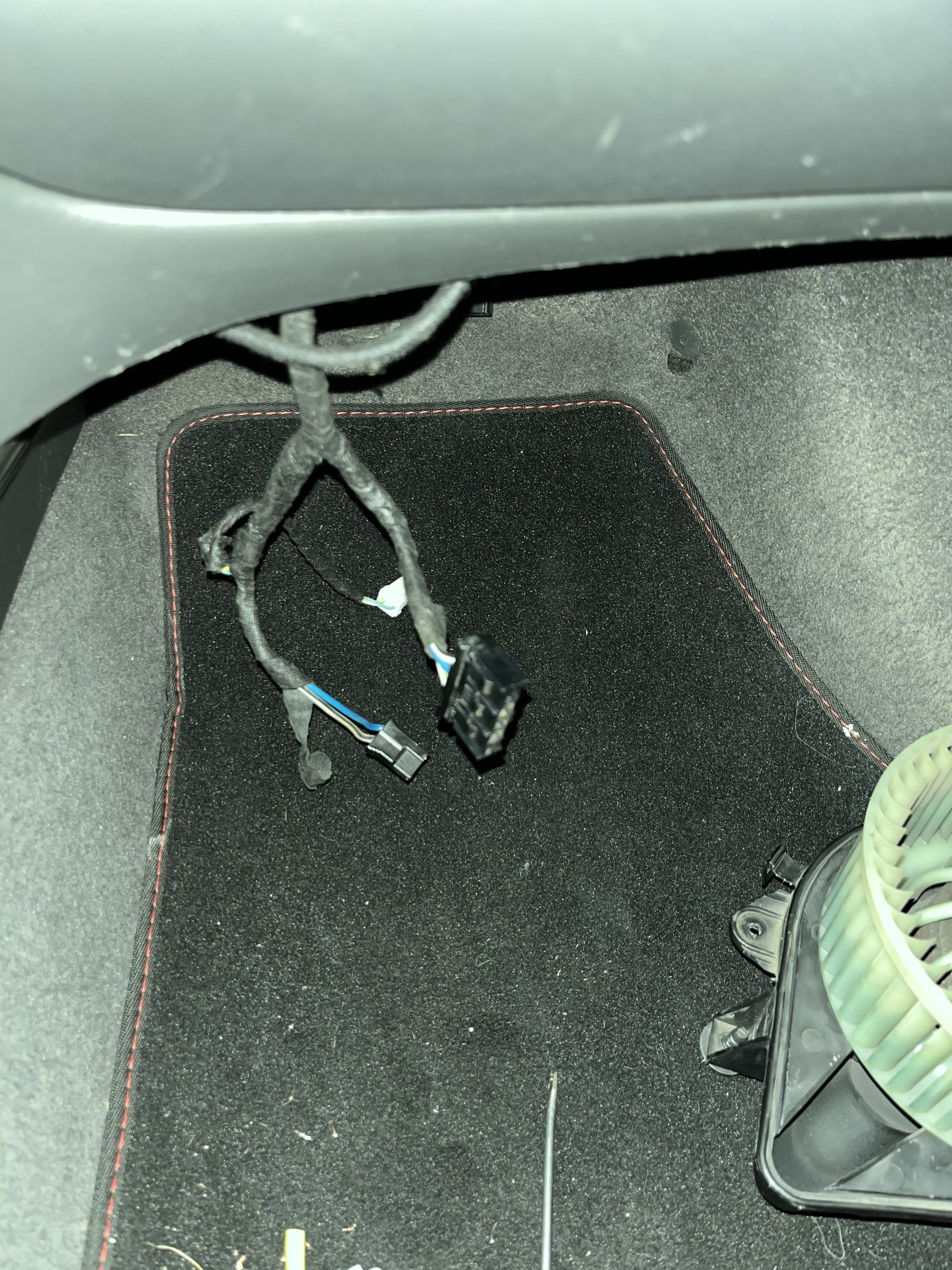

Does anyone perhaps know this problem?
When I turn on my interior fan my sidelights come on. Furthermore, the lights on the fan also don't work and thus are unresponsive. Only the lights and instrument panel comes on. I already tried Alan's post but I have other tuners (A/C). Also the fuses are not working properly (F49)
Can anyone help me? As it is very cold in the morning so🥶🥶
Here some photo’s and vids

Ta da! Got it sorted… two wires were fused together in the multiplug for the blower under the dash……thank goodness and thanks for those who suggested all the potential remedies
