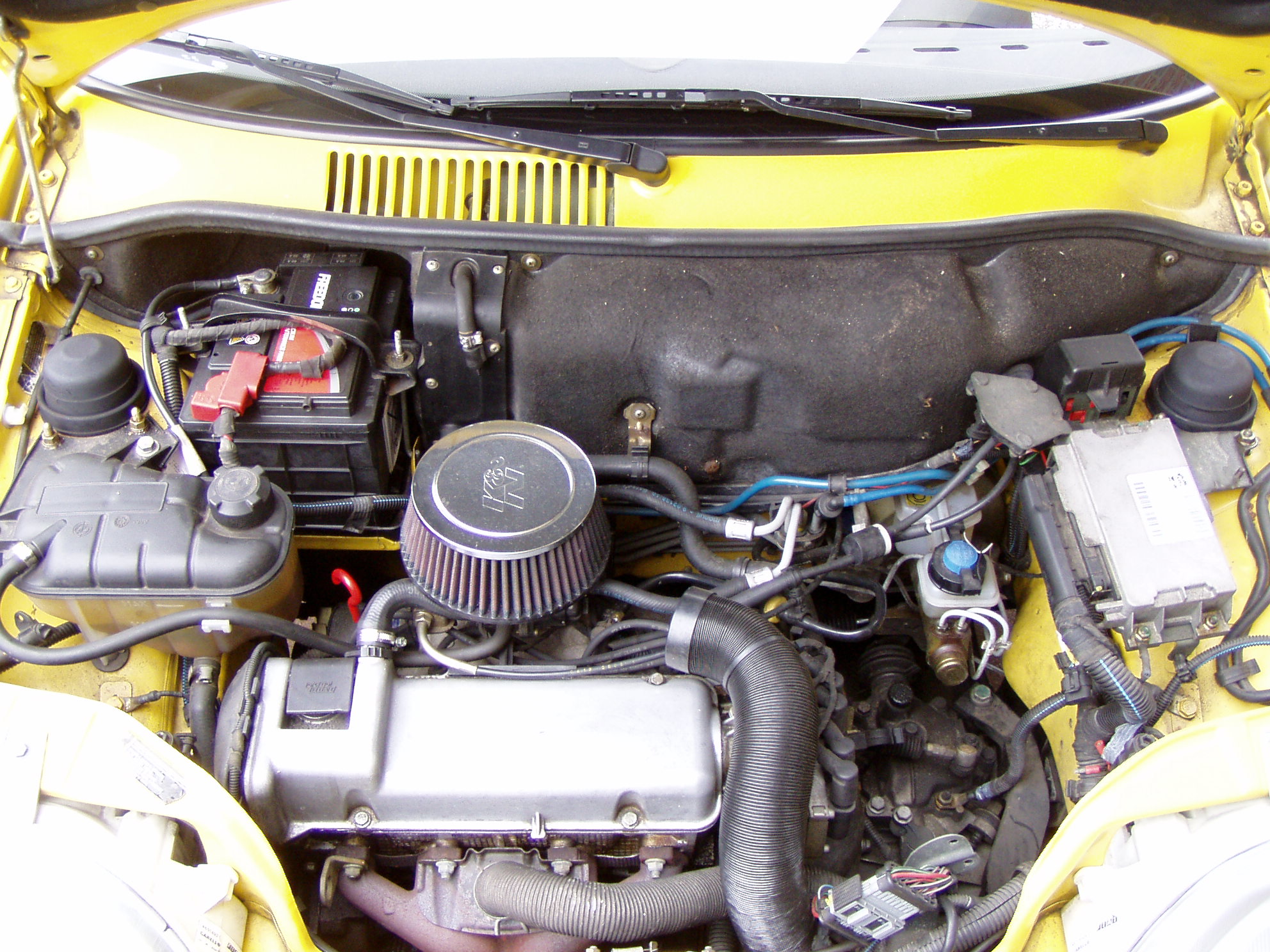

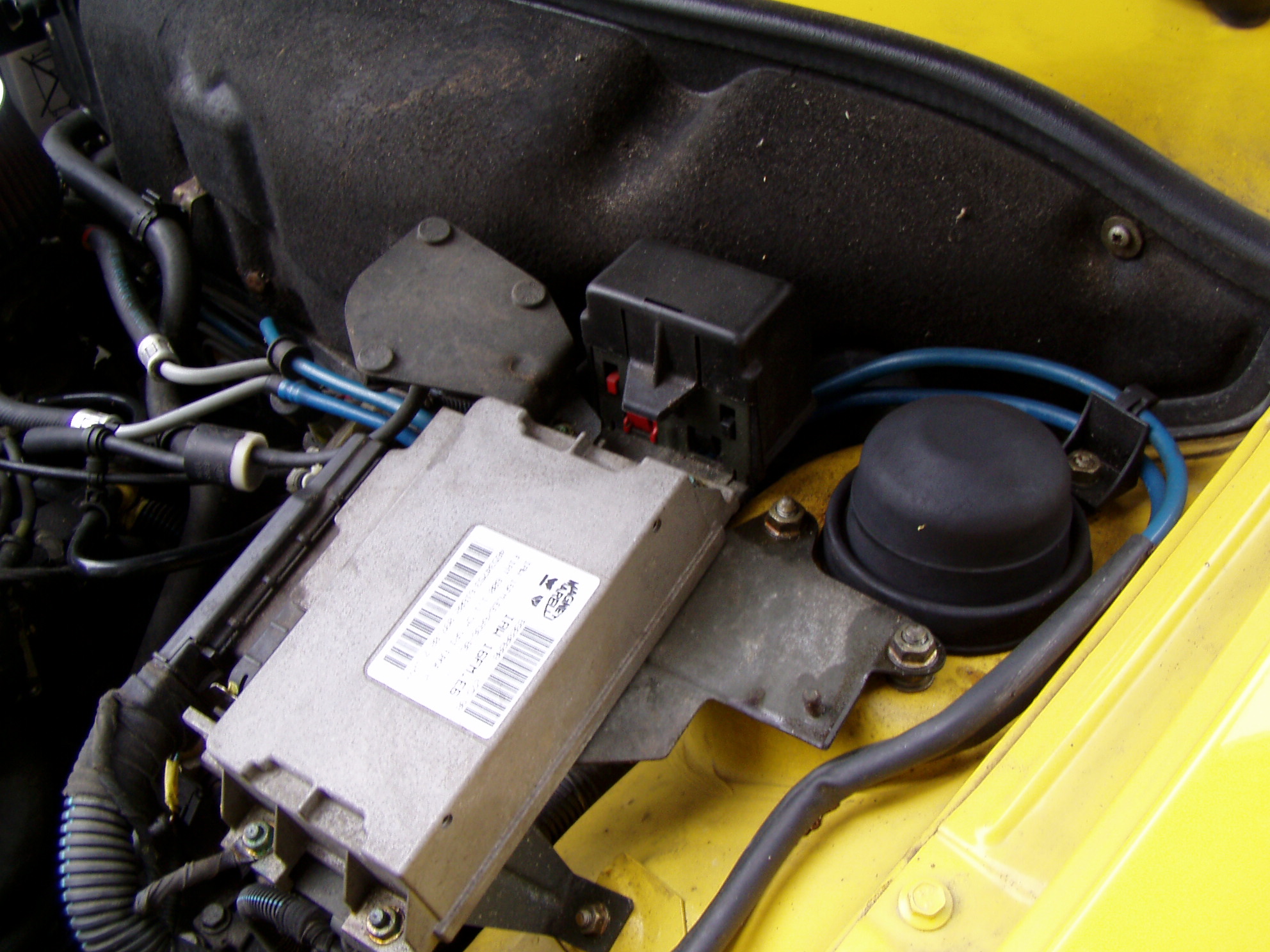

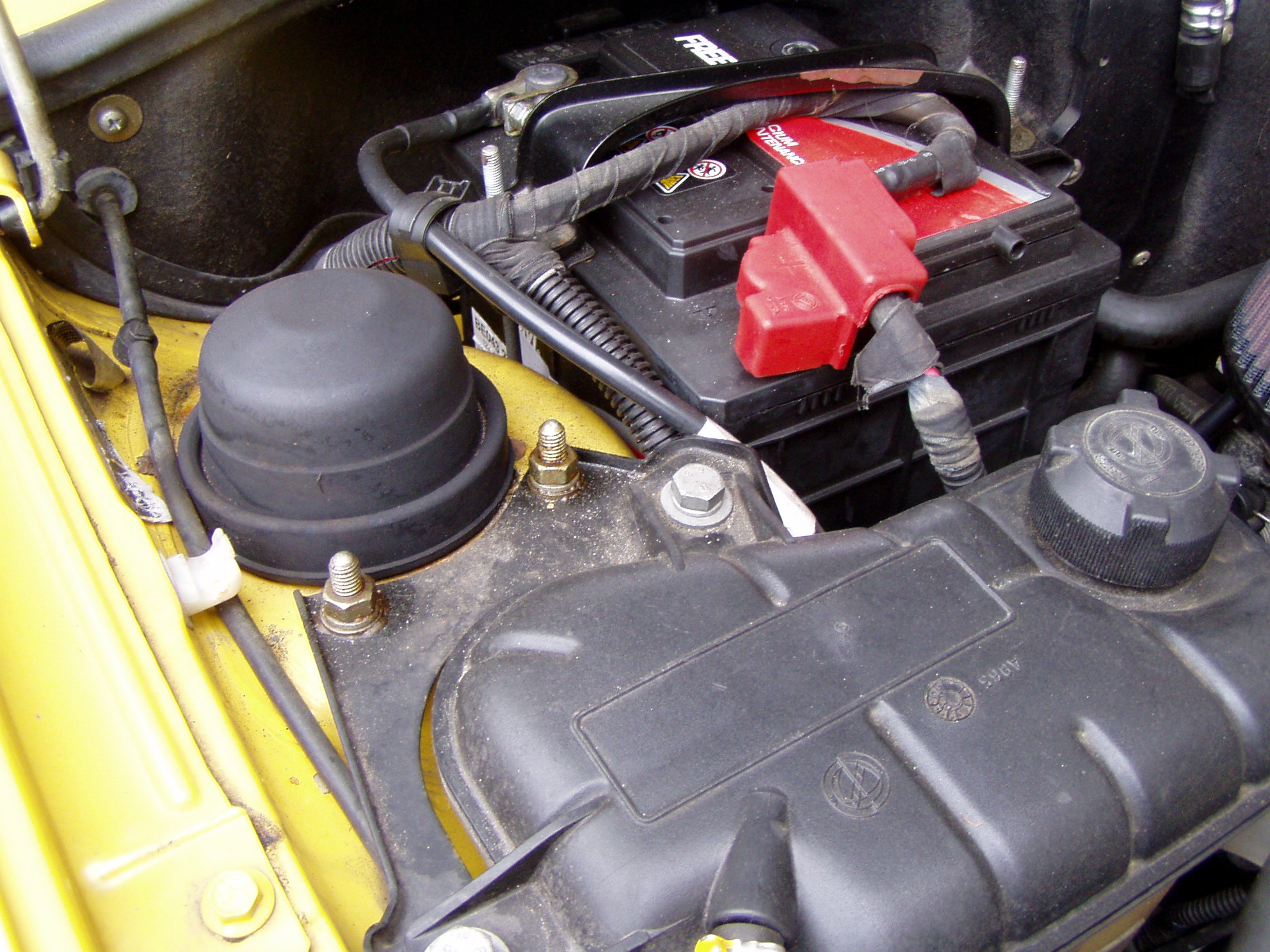

I have a 1999 SPI Seicento, still fully standard, waiting to be modified on the suspension. I just had a look under the hood, and if I'm not mistaken, non of the strutbraces will ever fit around my engine ECU and fusebox. The bracket that holds the watertank for my windscreen sprayers can be slightly changed to make the strutbrace fit properly to the body of the car, but on the other side, the fusebox and ECU unit is going to be a serious problem I think. Or some people here can tell me the oposite. If I can, I will post some pictures of how the layout of the ECU, fusebox and watertank bracket now is in my car.
Here are the pictures. I hope its clear for you all what I mean ;)
As you can see, I can probably cut away some material from the watertank bracket, so that the bracket can fit over the strutbrace, and the tube of the strutbrace itself can pass through the two bolts that are closest together on the spring bulb.
On the other side, O dont know how I can move the ECU and fusebox so the strutbrace can pass there. Anyone got ideas?

Well, like a said I cant see how it will fit around the ECU and the black fusebox. When I look at pictures of people who have a strutbrace on, they seem to have moved their ECU and fusebox, or they have a different one. Can that ne true? Or will it fit without any major problems.
Okay, thanks very much for that.
Bye the way, is that an OMP strutbrace you have? because that will probably be the one to go for me. Because if I look at your pictures, it seems like the strutbrace will pass right in between the fusebox and the ECU. So if thats also the case with the OMP one, that would be nice.
Okay, thanks for the quick response mate!
Here in holland I can't seem to find a Novitec strutbrace, the Dutch importer probably doesn't sell it. anyway, I will be fine mounting the OMP one now.
I also found a brand on the net called "wiechers" from germany. I never heard of it before, but they seem to have upper and lower front strutbraces for the seicento. And they have a sellingpoint here in Holland. Does anyone have experience with those? Could maybe also be an interesting option! :)
