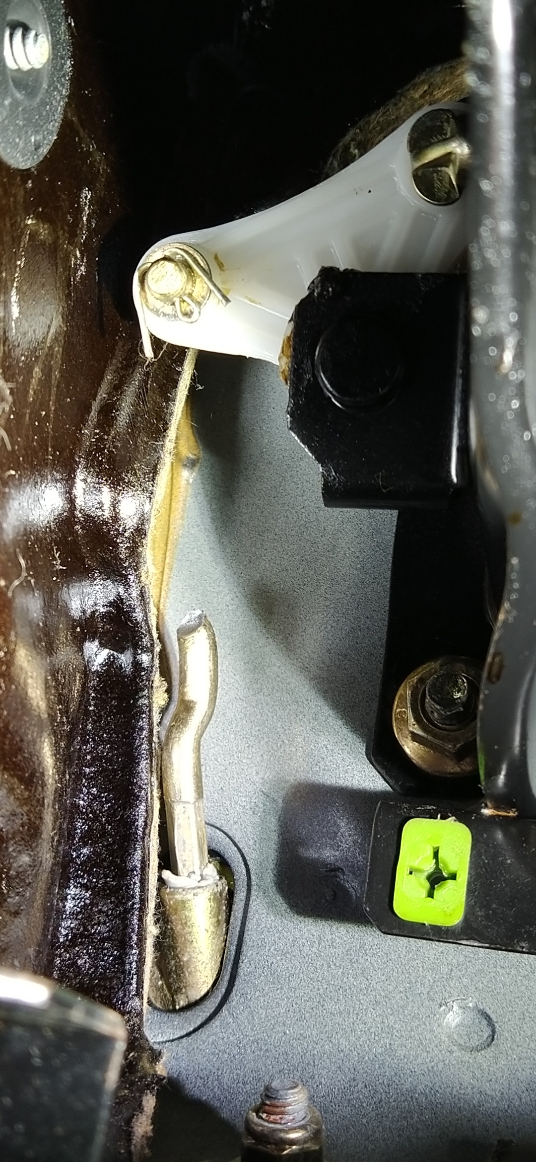

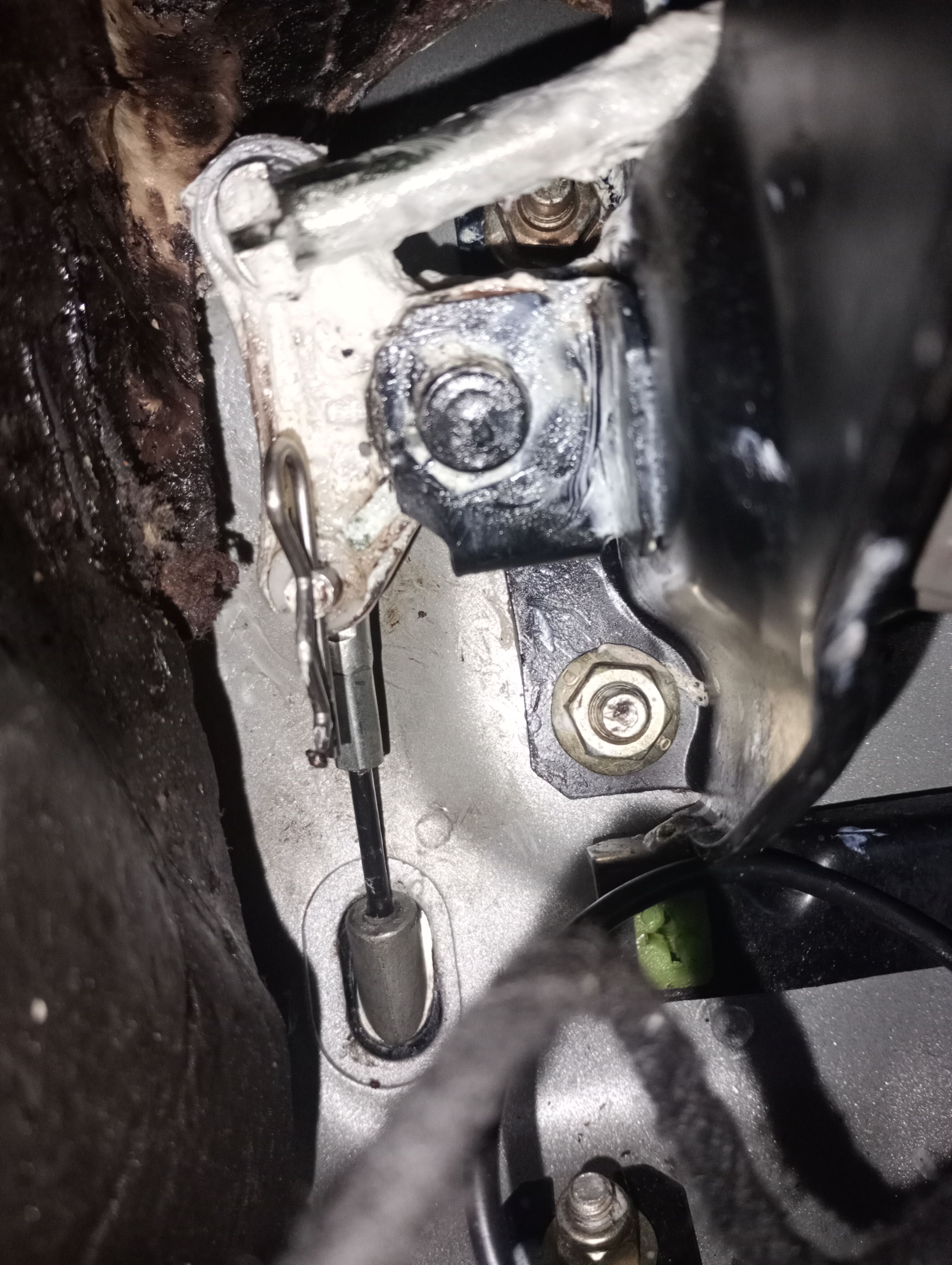

Managed to get the cable out today but the replacement's too short by the looks of it. Had ordered a 712mm but this is only 500+ml. I was concerned about getting the black metal casing off at its upper screw fixing, but it's cleverly only lightly screwed in to allow removal. The split pin took ages to get out til I decided to cut the head off, then easy enough. The two 10 ml nuts in the engine bay came out ok too. So just need them to send the right cable now! The breakage point is obvious.
It sounds like they've given you the cable for an 899 as they are shorter than the 1108, with my metal casing I undid 2 screws but the 3rd one which is the hardest to get to didn't have to be undone as it came away with the casing which was a result 😁
That top screw fixing is clever because of the access issue as it can't be screwed in just pushed in and eased out after undoing the two lower ones. Anyway, picked up a cable today and Sei's back on the road now and the clutch feels good! Bought a QH 707mm cable on eBay and all good for about 15 quid 😁 Cheers again for the help and advice 👍
