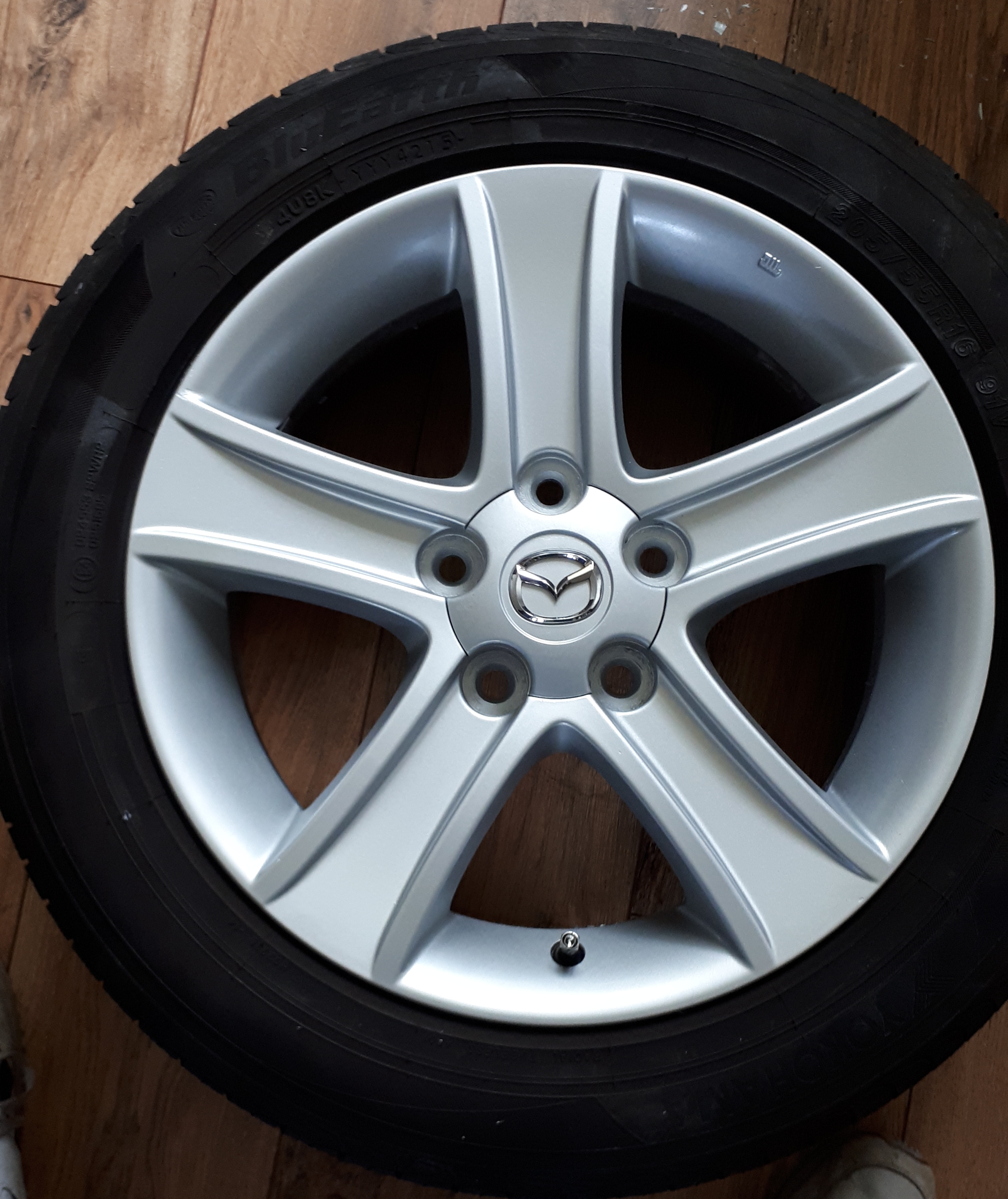

I did a similar job on my old alloys on the Mazda
