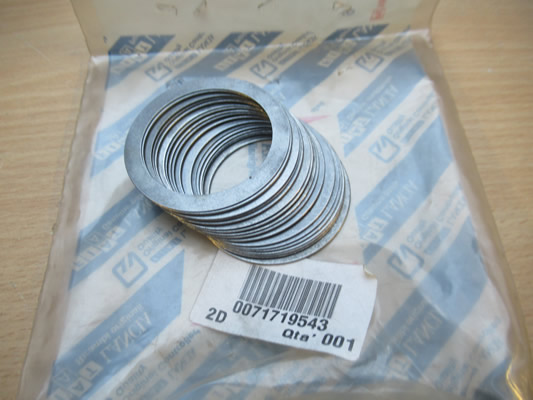

Hello friends,
I need the dimensions of the part shown in the picture.
There is a space in my differential. I'm trying to fix it. but I couldn't find this part. I want to do it myself.
differential adjustment ring

Have you got the tapered bearing off? You will need to measure the end float and set it correctly , for two reasons, if too tight the bearing will fail and if too loose the extra movement will damage the teeth on the crown wheel and the pinion. Also if set wrong it will cause a very noisy diff.
So I would consult a good workshop manual and use a dial gauge to check end float etc. plus a micrometer to measure the shims required.
It's years since I set any up and they were in rear wheel drive vehicles.
I suppose it is always possible that when it was assembled new the clearance was correct without shims, but do check a good workshop manual.
