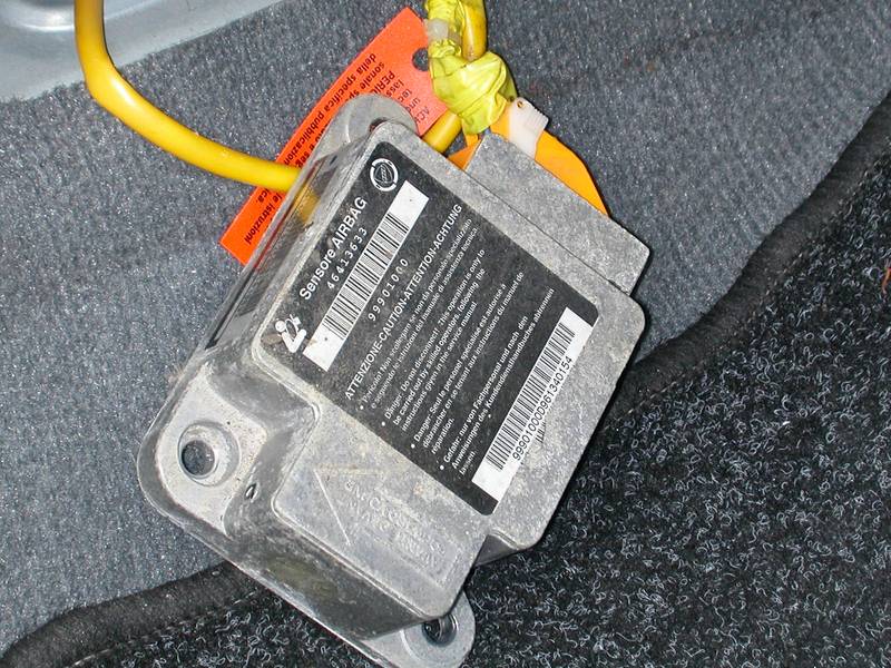

I tried looking for the airbag ECU today but I coudn't find it. I took the box of the glove compartment out and I found its control socket, instead. I tried following the yellow cables, one goes to the passenger side airbag, another crosses sides to the driver side, another one goes to the floor between the two foot spaces so I took of the little plastic covering of the foot space of the passenger side ... there was a metal case alright, however, I do not know if that's the ECU or if it is some kind of decelaration sensor.
EDIT: ok I found some description of it, the whole metal case is indeed the ECU. I wonder if it would be easier to dismount if I'd go for it from the left or the right side?

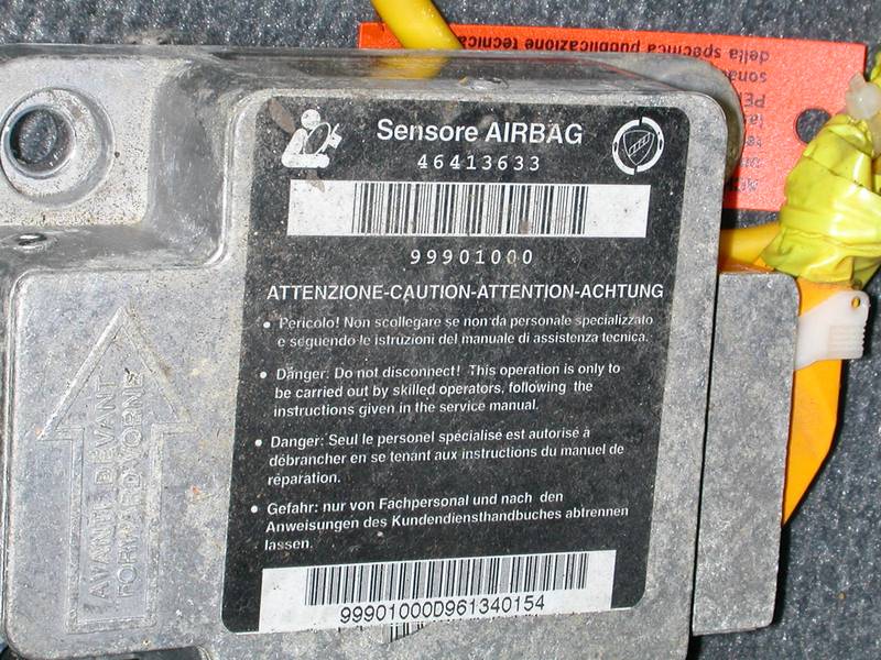

all right I found the airbag control unit, took some pictures of it, too.
However, I have some trouble finding a identical replacement part on the scrap yards. "46413633" would be the number needed. On later models as about 1996, the numbers have changed. So I suppose a part with a slightly different number from another Bravo (like 1998) would not fit.
Any suggestions?

Watch the airbag ecu you get to. On the early cars i was told they weren't earthed so you can spike them like you did easily. The wiring is slightly different to. The later cars have earth straps on them and shouldn't be able to be spiked the same way. I know a good second hand one here is about $400-450 NZ dollars, and a new one was over $900. There is a company in england that rebuilds them to but doesnt give any guarentees. I think they were a bit more than a good second hand one. I ended up building a timer instead for $20 and jerry rigging it. Light goes on and out like the ecu was there, lol. The airbag in mine is still there but disconnected from the steering wheel so it can't discharge. Not a particularly legal way but definitely cheaper. :). I intend to pull the steering wheel to so i dont car to much about the fact the car doesnt have an airbag in it.
