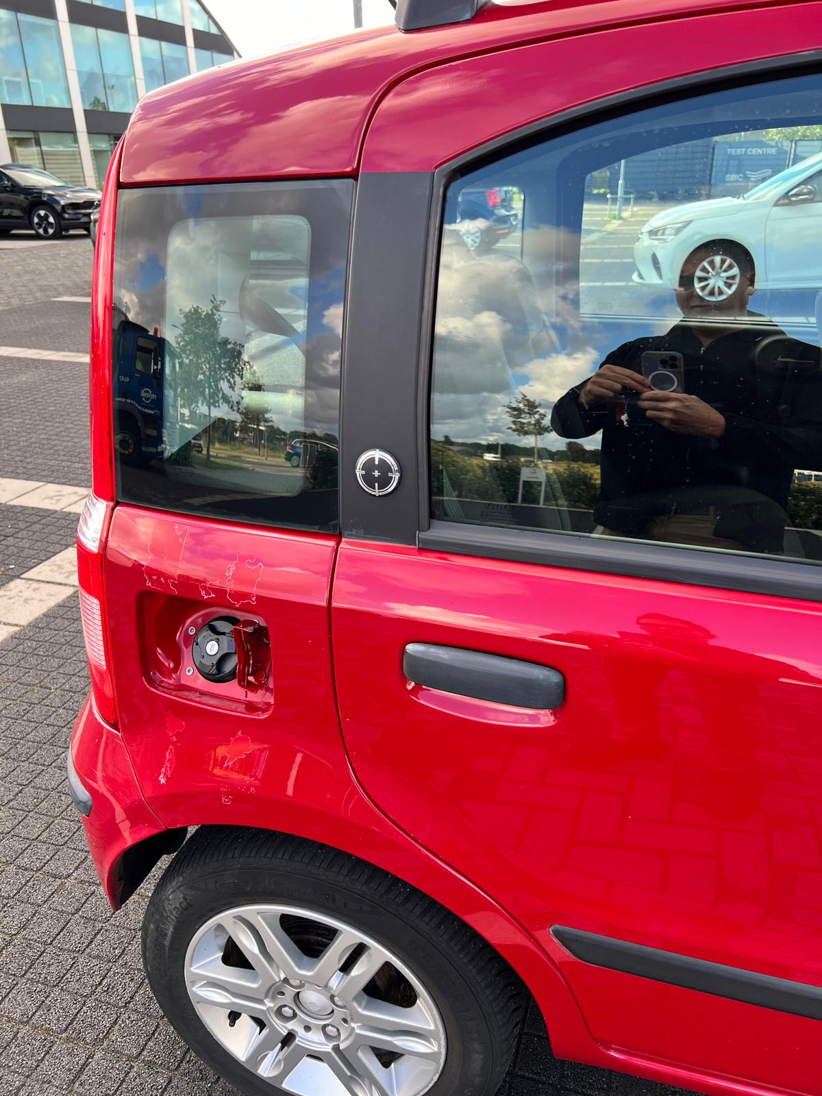

Hi, I barely brushed against my petrol fuel door on my Panda 2008 and it snapped off. It's obvious that it was replaced by the previous owner, so it may have been a cheap second-hand part. Two questions:
- Is the fuel door really needed, it doesn't lock, and I have a locking fuel cap?
- Do you know where I can get a replacement? Something that is somewhat a red color.
See photo:
Thanks!

Is it needed, no, but it does look attractive to yobs to mess with the cap
In the right colour, ebay, I guess, I suspect dealer prices will be expensive

There will probably be several shades of red, if you want it exactly the right colour code is on a barcode on the edge of each panel
You got black door handles I guess black wouldn't look too bad either ?
Has the plastic flap actually broken?
I've removed mine a couple of times for cleaning and it's only held on with thin wire springs. Might just pop off if knocked.
If you do need a new one, I'd agree with Koalar, I'd try and get a used black one rather than trying to match the red. Even if it's the same colour code it might look different

That's good to know. I don't see any other Pandas with this hatch missing, in my region, so it concerns me a bit about the APK/MOT.
No, but you might need to unbolt the hinge to get an MOT if the tester is being pedantic - the sharp edge could injure a pedestrian
Here in the UK
Correct, MOT is only a visual check for sharp edges, its subjective so probably will not fail
But technically it's illegal as anything a 100mm sphere can touch, which it does, has to have a have minimum of 2.5mm radius on it, which it doesn't, again unlikely to ever get picked up by the police.but technically a fixed penalty notice can be given
