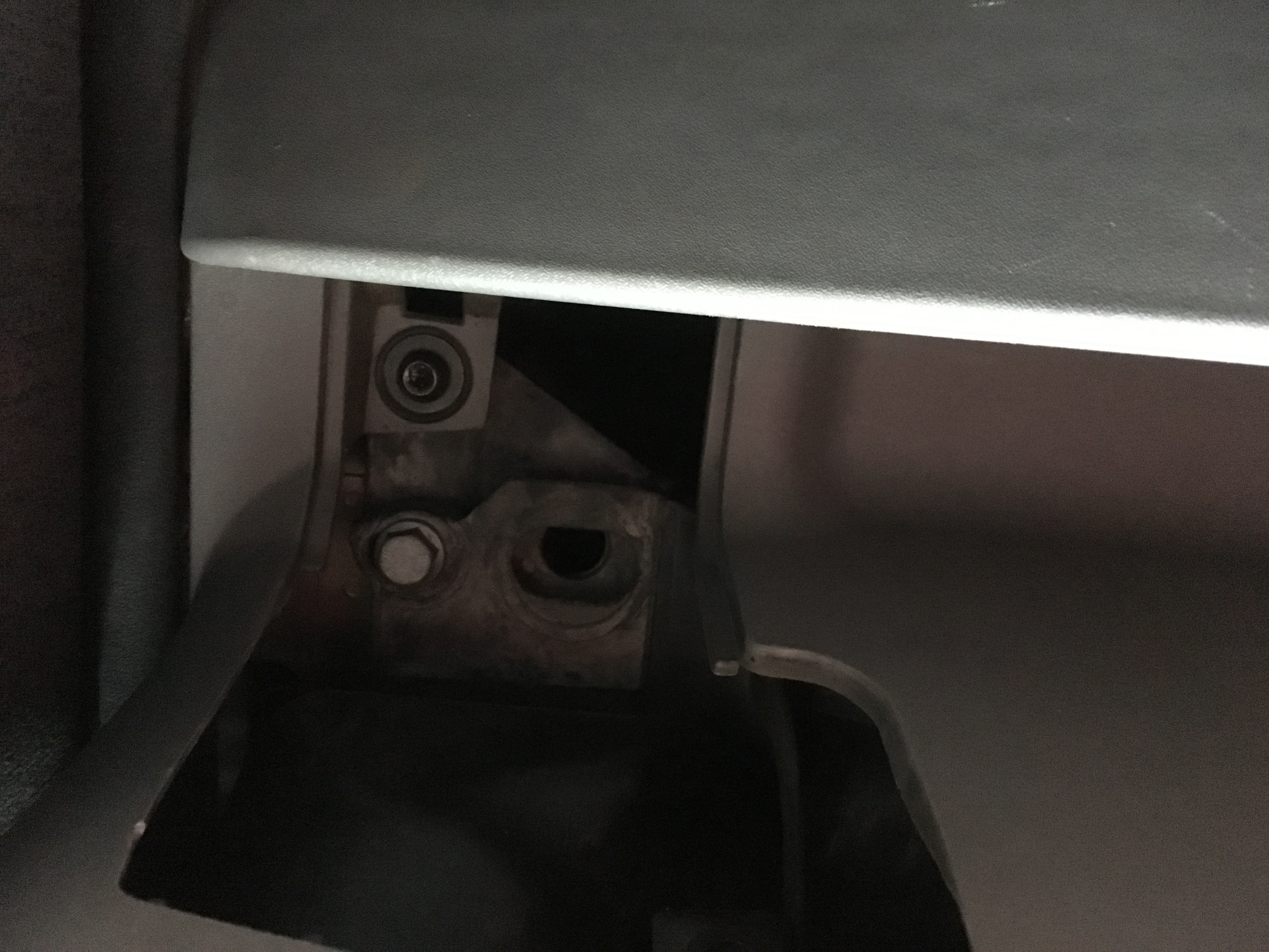

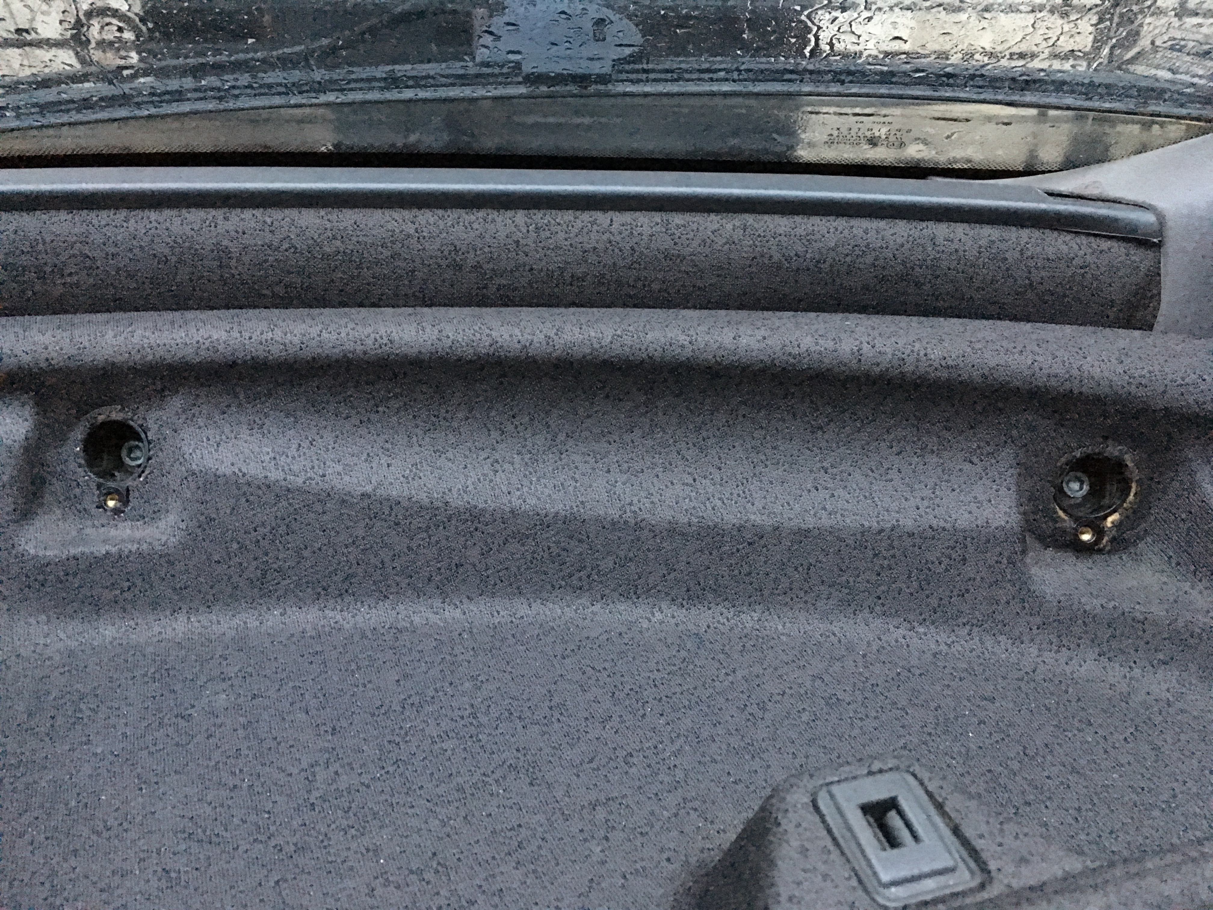

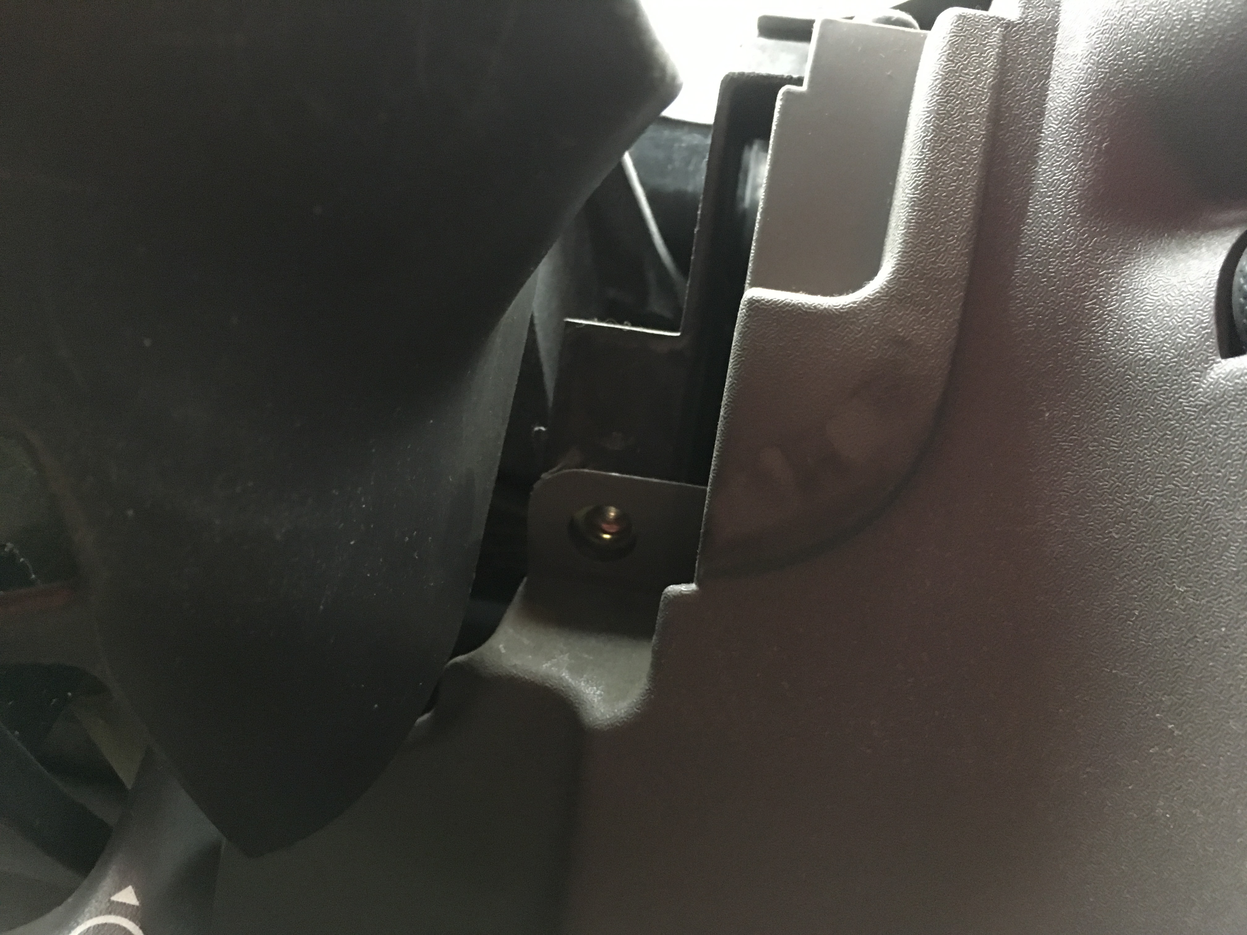

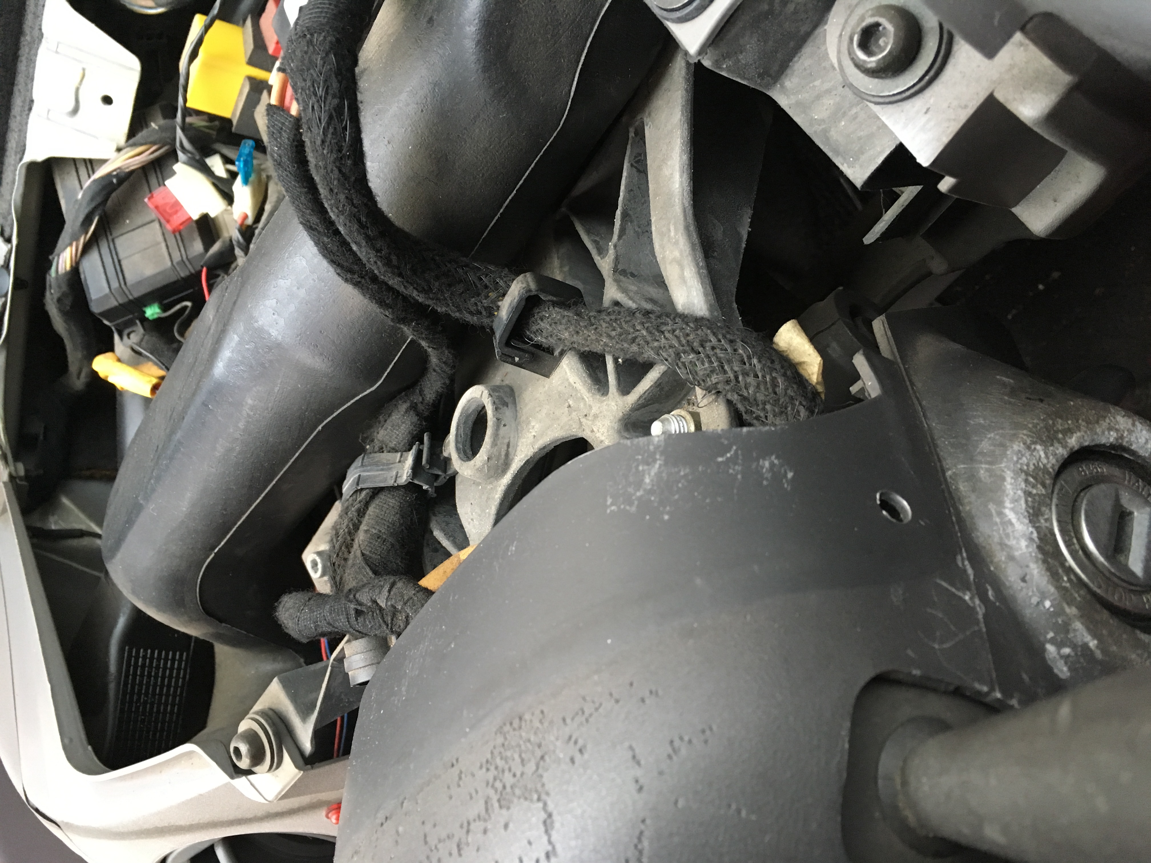

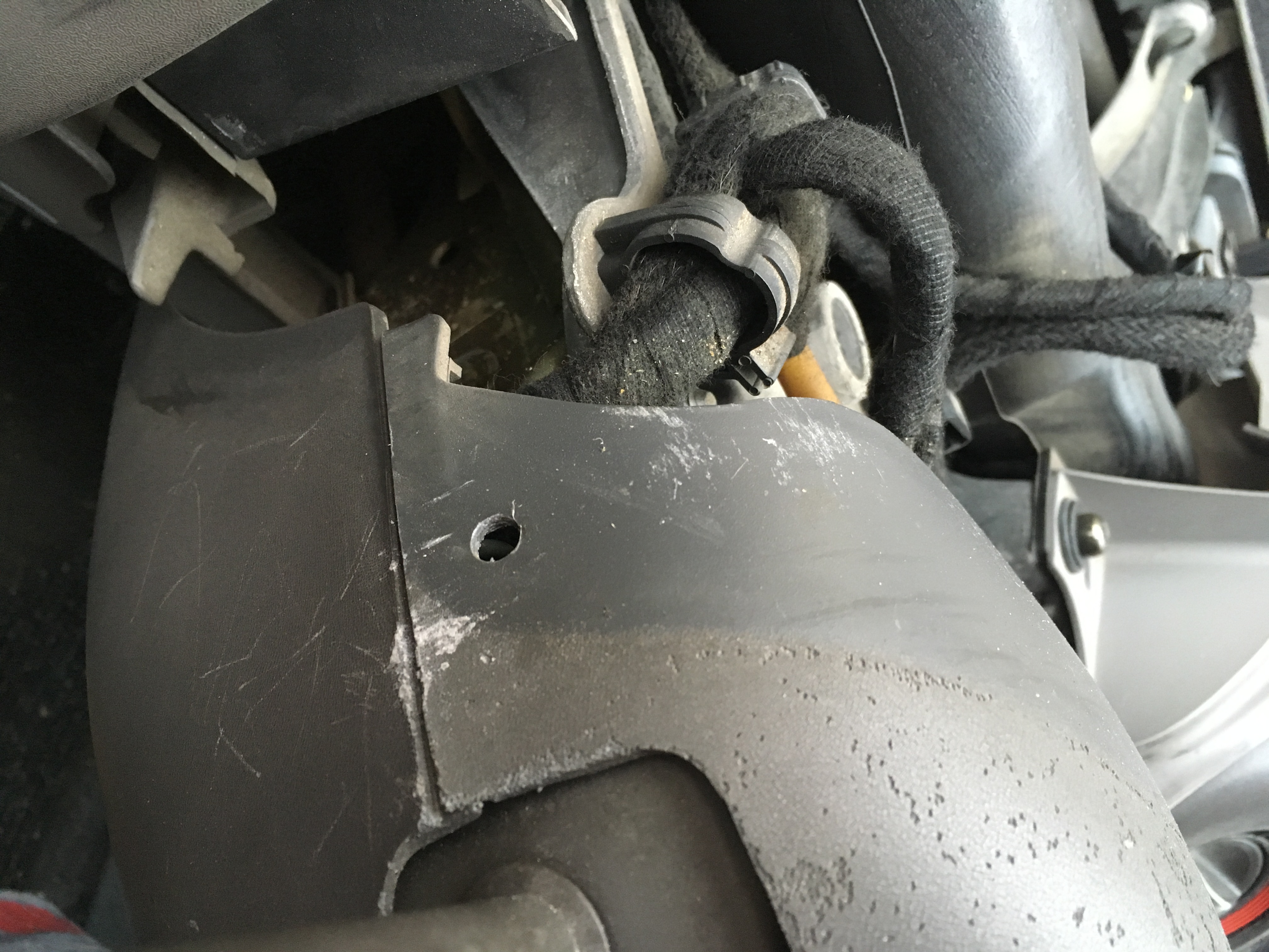

It's pretty easy. You have to disconnect the "textile" area from the rest and lift it up.
You start on the driver side:

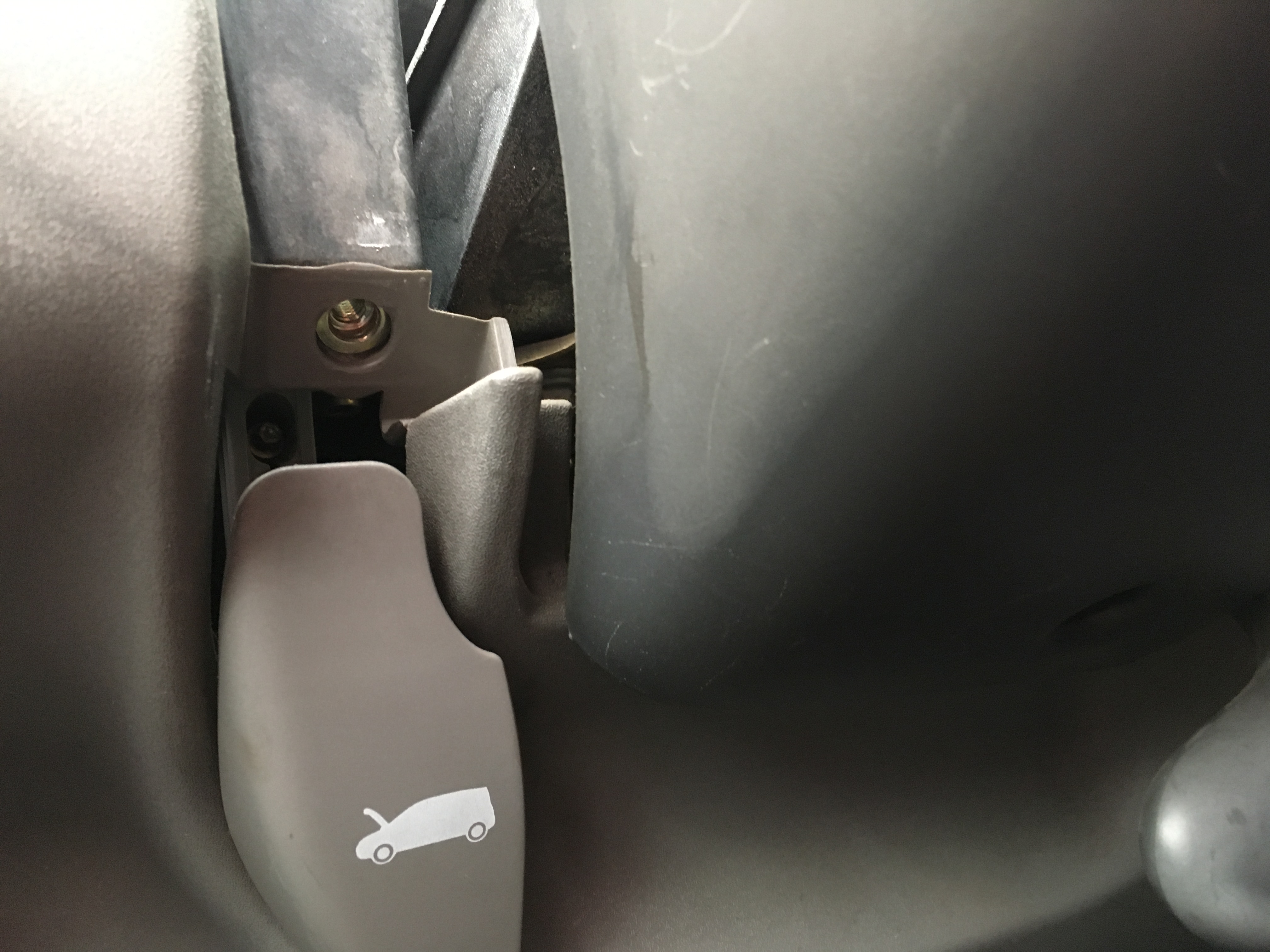

- 2 plastic clips near the steering wheel, on the platic surrounding it
- 2 screws left and right of the steering wheel, at the knee level
- remove the lid of the glove box on the driver's side: 2 small visible screws and then pull (hard)
This will give you access to the last two screws. Undo them.

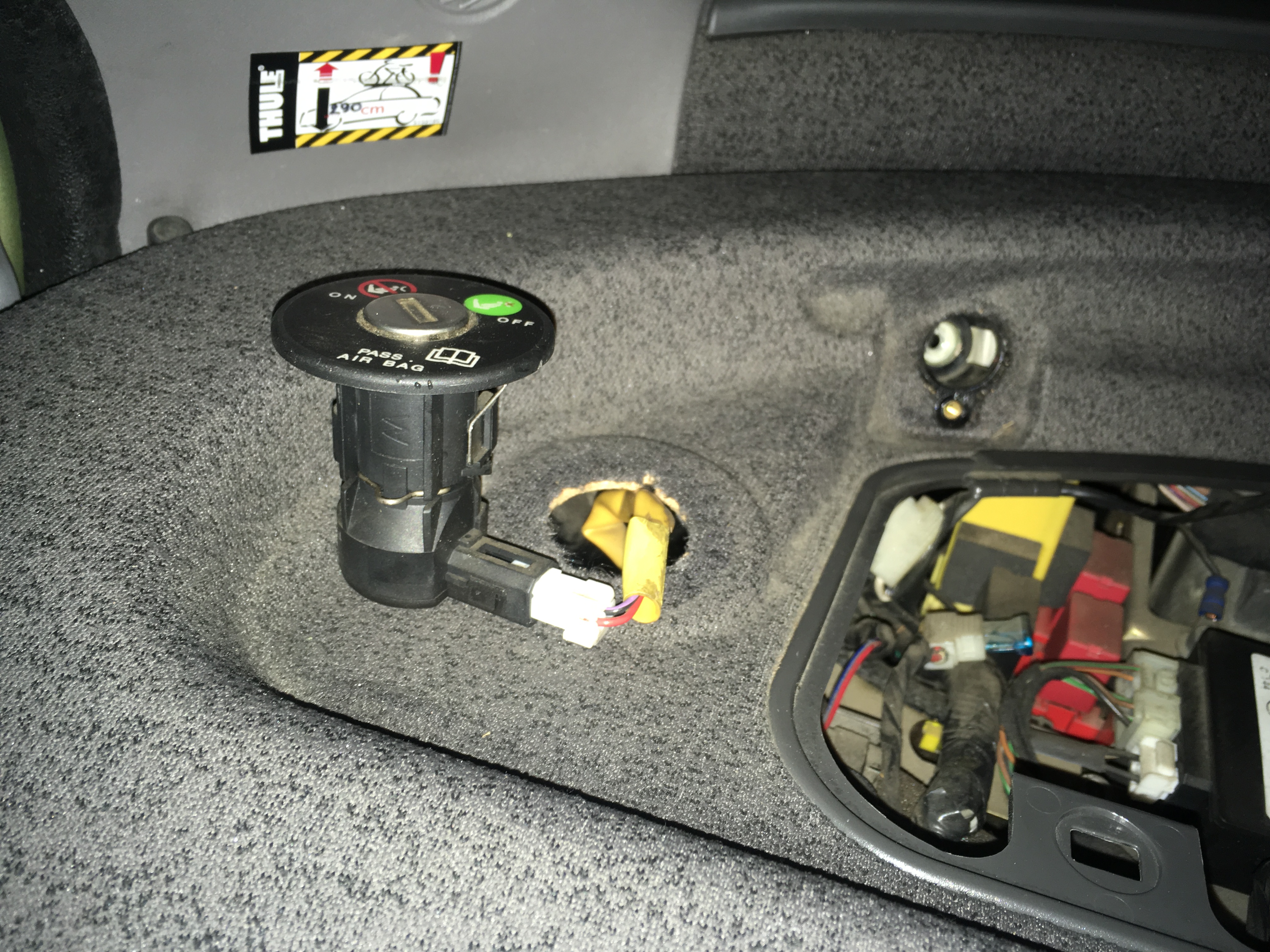

- with a flat screwdriver pop up the airbag switch in the glove box and disconnect the wires
Now all you have to do is lift up the top of the dashboard (driver's side).
Forgot to mention that all the screws are torx, same size, except for the glovebox lid which is smaller.
Later I will post some photos and continue with the passenger side.

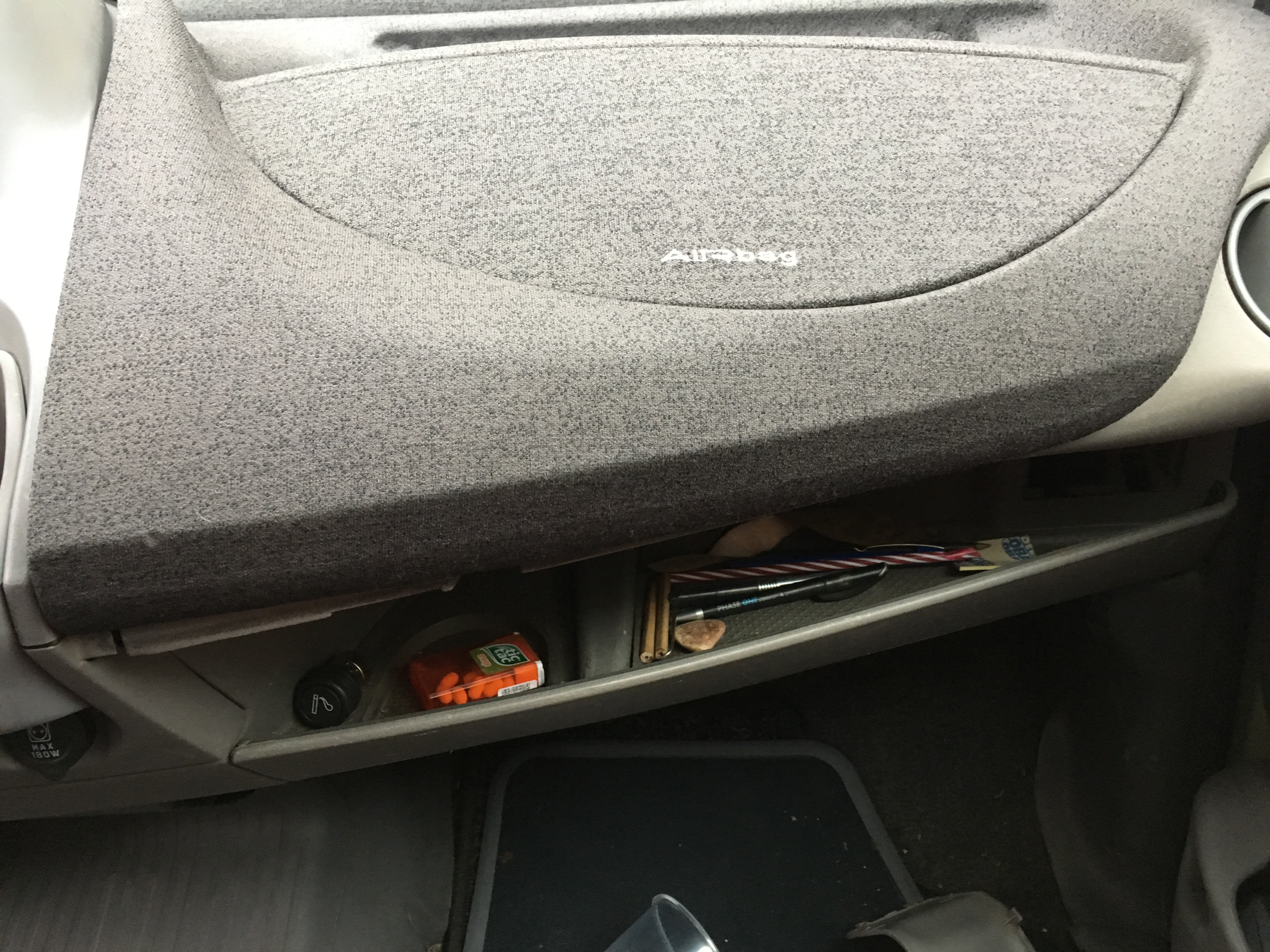

As for the passanger side, you start with 3 screws on the knee level, 2 of them right under the edge of the textile part and one hidden under a plastic near the door.

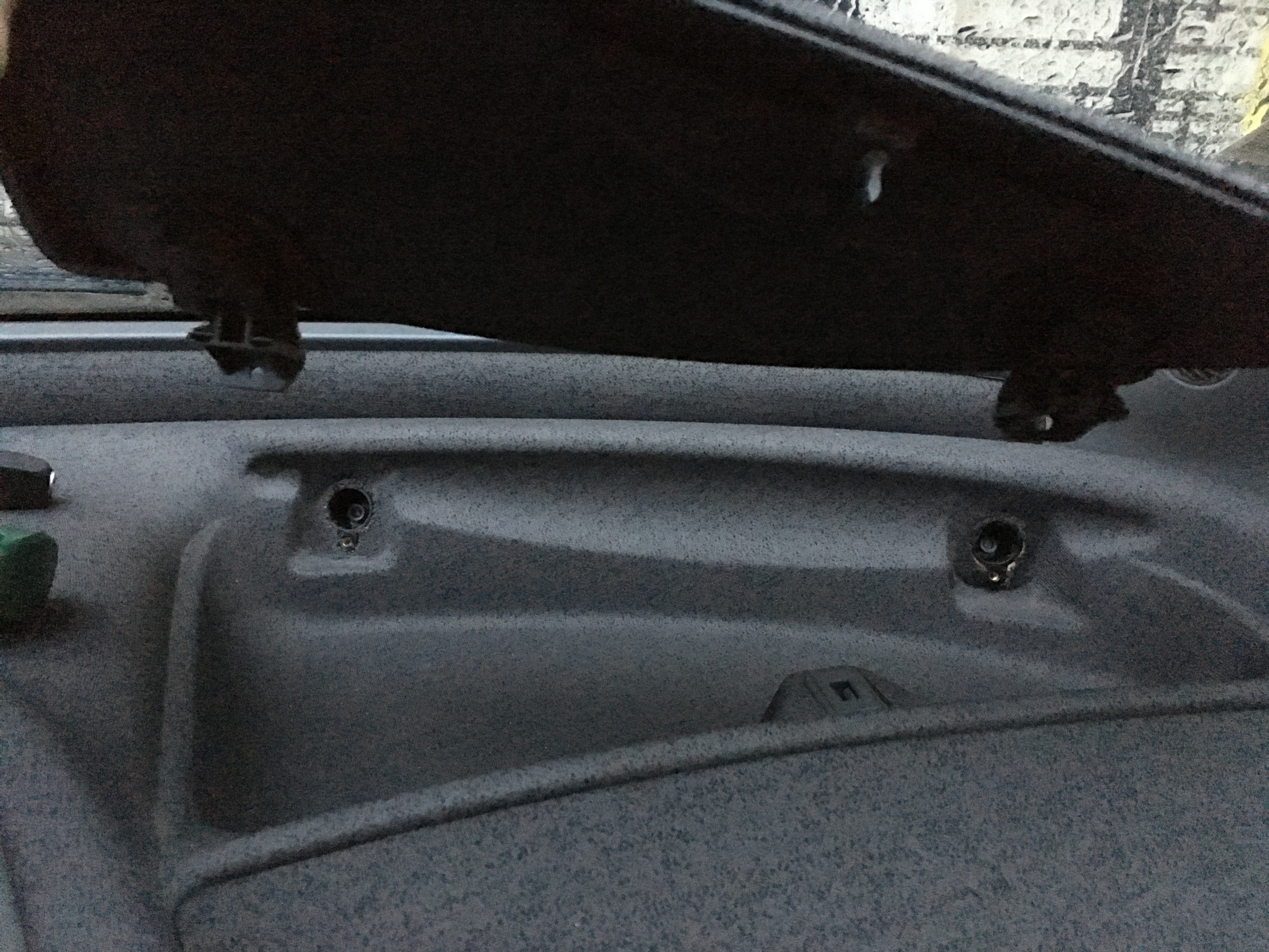

You continue with the storage compartiment: there are 4 screws:
- 2 under the brackets that hold the lid (remove the lid by unscrewing its 2 small screws then pull hard)
- 2 screws on the opposite side covered by 2 plastic squares.
And then I think there is one more screw visible near the center console.
All the pictures are from my LHD car, for a RHD you shoul imagine the images flipped.

Yes, you have to be careful with the righ side panel when you put it back.
I broke the plastic parts that sit right on the edge, near the knees. Then glue them back with a glue gun. Then broke them again while trying tu put the whole thing back. And again...
In fact it's easy but you have to whatch carefully how they fit together, not like me :)
