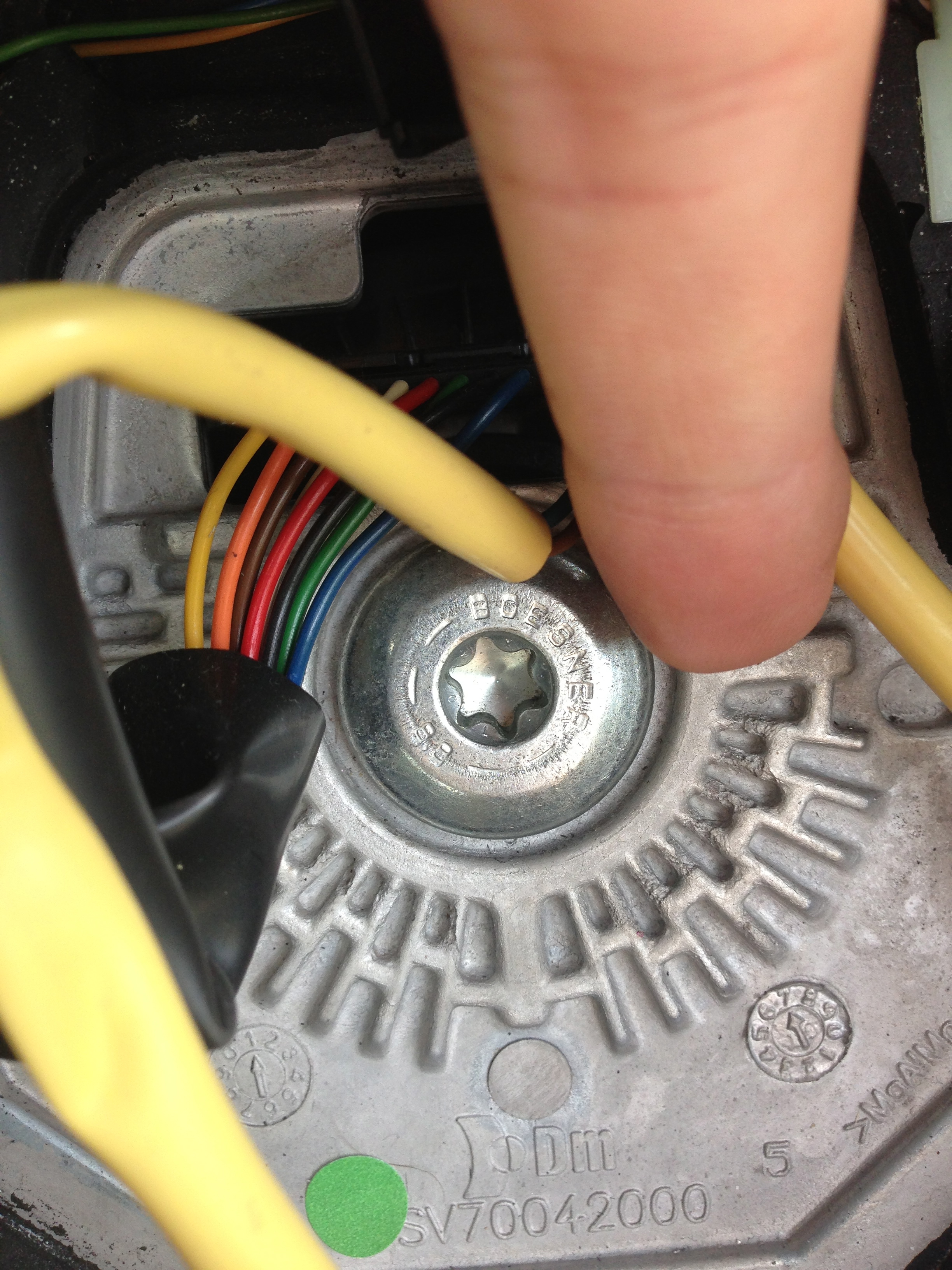

For the punto evo you will need a Torx Bit Socket T50 to actually remove the wheel once the airbag is out.

Here are some images of me replacing the wheel that you may find useful... or not.

did you have to drill 2 little holes in the back of the wheel to remove the air bag?
Yes there are 2 little indents behind the wheel which do need to be pushed through. They are very thin and therefore you don't need to drill, I used a philips head screwdriver and just pushed through.
Hello, there is no need to drill any holes, you can remove the steering wheel quite easily using tools you can make by yourself.
The only thing you need to do is to remove the plastic cover underneath the steering wheel and release two clippers from the back of the steering wheel. You cannot use a screwdriver, you need to bend a piece of metal to do that.
Have a look at this video at YouTube: youtube.com/watch?v=-7PFvGh5610
Those clippers are the ones to be released:
These are the tools I used:
Good luck!
And of course, disconnect the battery a follow all safety instructions!
