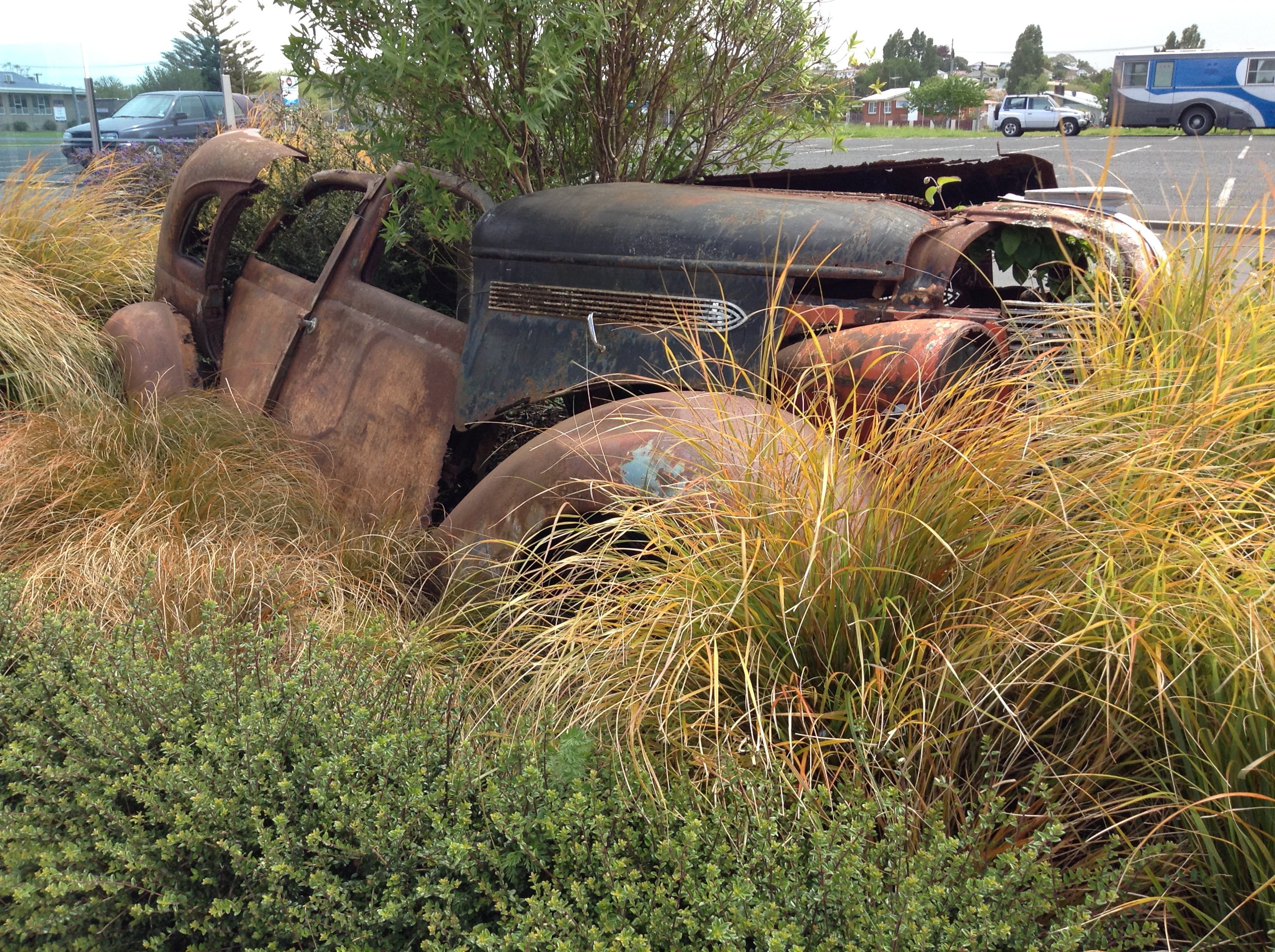

Jimi Hendrix comes to mind “Is is love baby or just corrosion”
You guys have just about summed it all up but I think that quite a few cars are prissed up to sell and are not necessarily coming up for sale by enthusiasts. Some forums are packed with so called pristine cars for sale in Italy and it has proved to be a real gamble for some. There also seems to be people with money who can afford these iconic cars but don’t know how to change a spark plug, that coupled with a huge shortage of people capable of fixing or understanding these cars compounds the situation. Successful owners are prepared to research the cars and their idiosyncrasies and get their hands dirty. Forget about a radio, listen to your car and feel the road, a 500 is far from a modern car which is the appeal for many.
As @ Bleeding Knuckles mentions Rust!!!!!!
It was always a good earner Mot welding, but unless completely cut out and repaired properly in a good dry work shop it tended to be the thin edge of the wedge. I used to say if a customers car needed an Mot "patch" it was time to move it on as each year on more would be required.
I suspect many of us have seen "classics" with a beautiful paint job that the owner is rightly proud of and then when we look underneath the true horrors are revealed.
I recall a 1960s E type Roadster that really looked show winning from first look, that the owner had spent many thousands to buy and claimed to have reached 135 Mph in, having seen the under side on a ramp patch welded upon patch, I thought "You are a braver man than me!"
