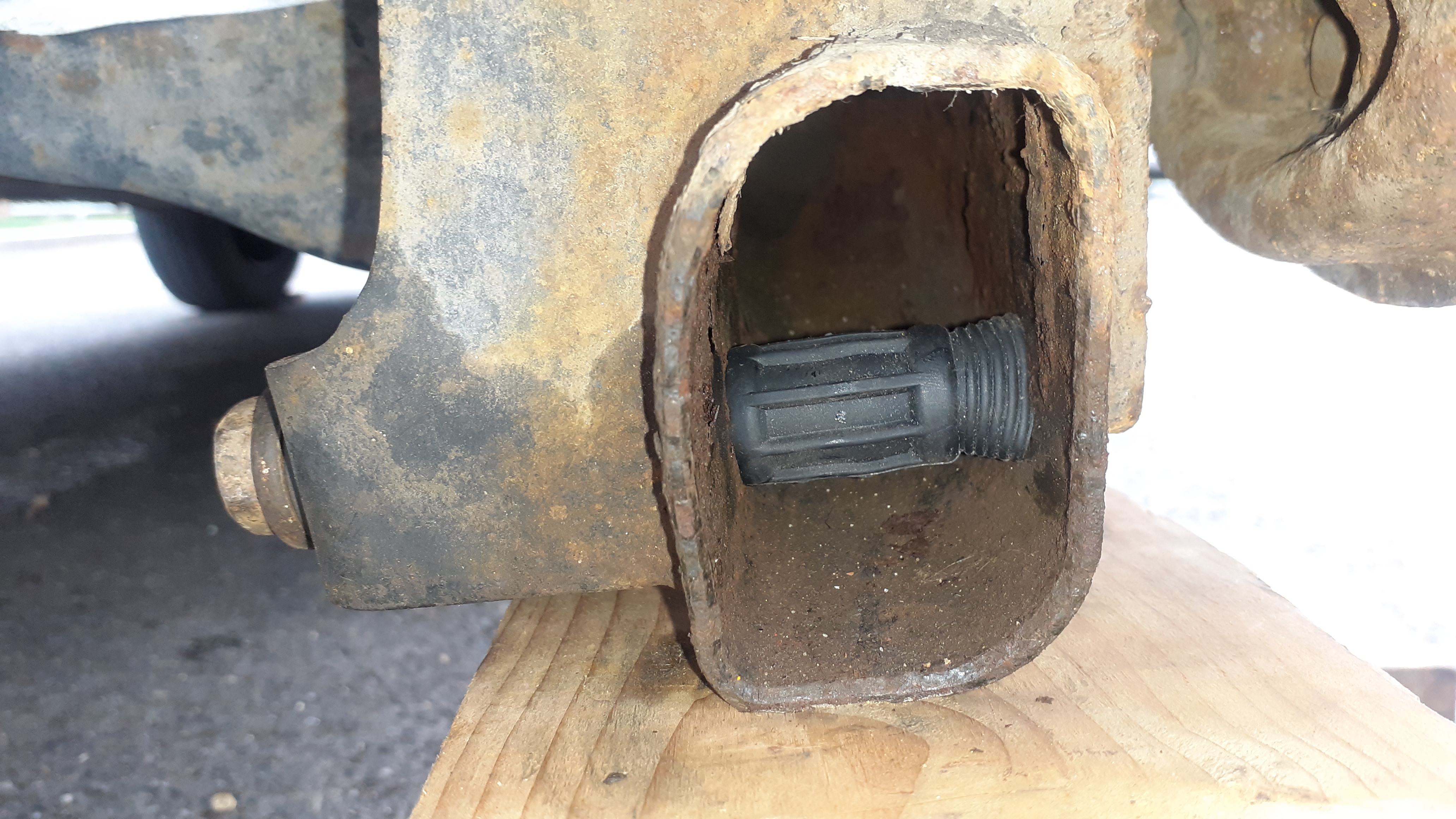

I did my Punto's last week and when I put everything back I also made nice protection for those bolts to prevent them go rusty like that again. I made it from old leads silicon protection, cut it on size, put grease into it and placed it over the bolt. This is the right hand side, made the same for the left.
I used the same springs, just got new supports for them and cleaned the rusty parts and painted them. And new shocks, of course. Looks really nice and feels very nice, much much better than before. Next I'm doing the front shocks.

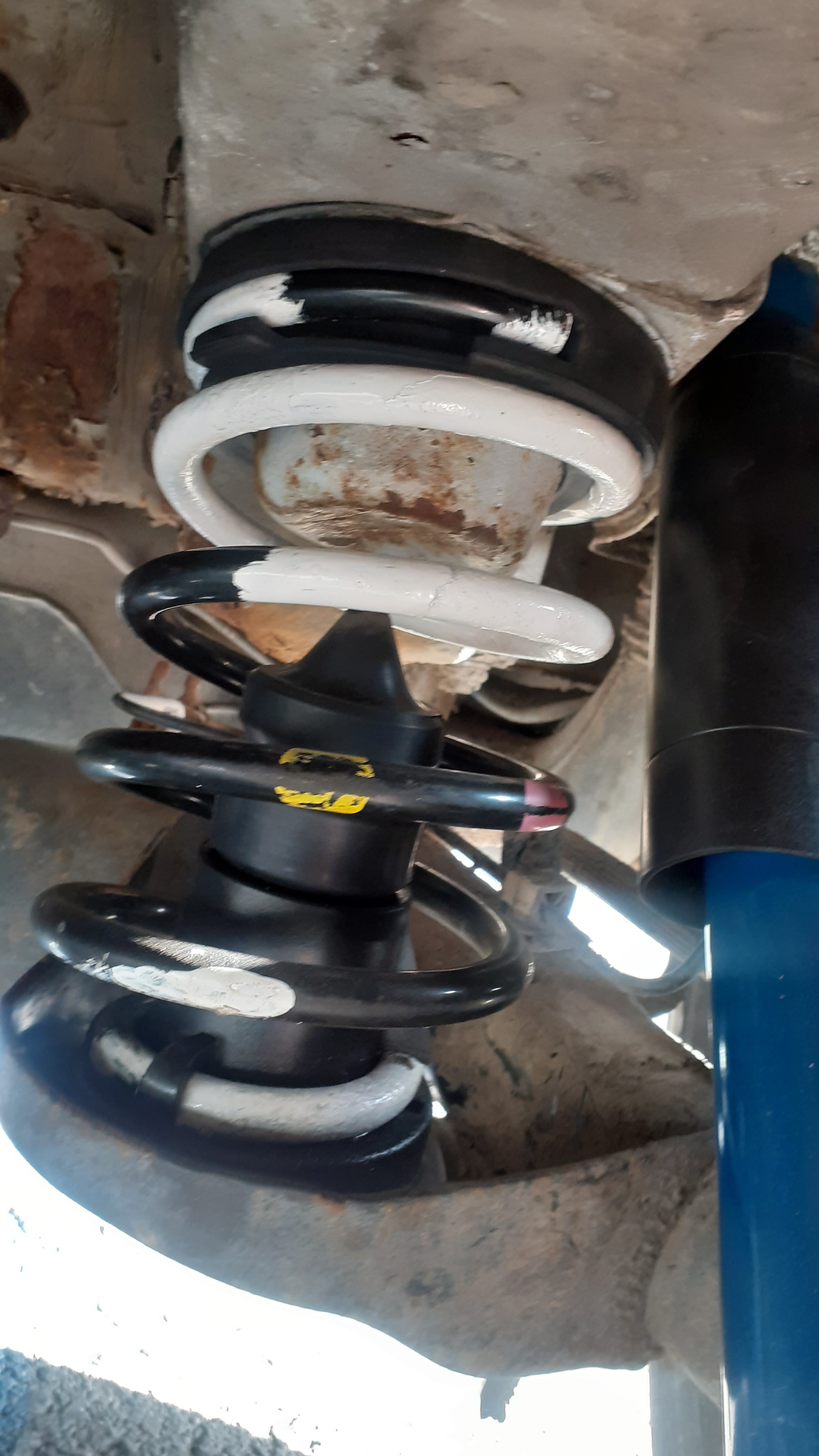

Just got round to doing this, no way as heavy as I thought
wire brushed all the crap inside and looks good so cleaned it and applied korust, I didn’t like the idea of the beam just hanging for the rest of the week so I lifted it and placed it on some bricks
Tomorrow I’ll paint the inside with rust eating paint, left it dry for a few days then fit my new bump stops, springs and shocks, then I’ll give the rear a good coating in bilt hamber spray wax
