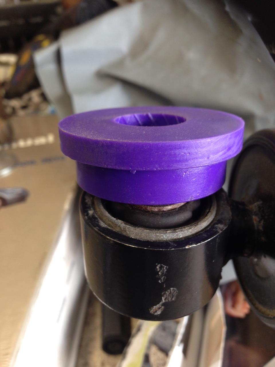

Well that didn't go to plan!!!
PowerFlex bushes arrived. Stripped one shock off and offered up a new bush.....
Didn't bloody fit!!!!! Miles out. So they are going back and I've ordered a set of the SuperFlex ones instead.
They'll be here this week sometime.
You can see here, they were as big as the outer rings diameter. Whether you are supposed to squeeze them in I'm not sure but I wasn't going to try to be honest.
