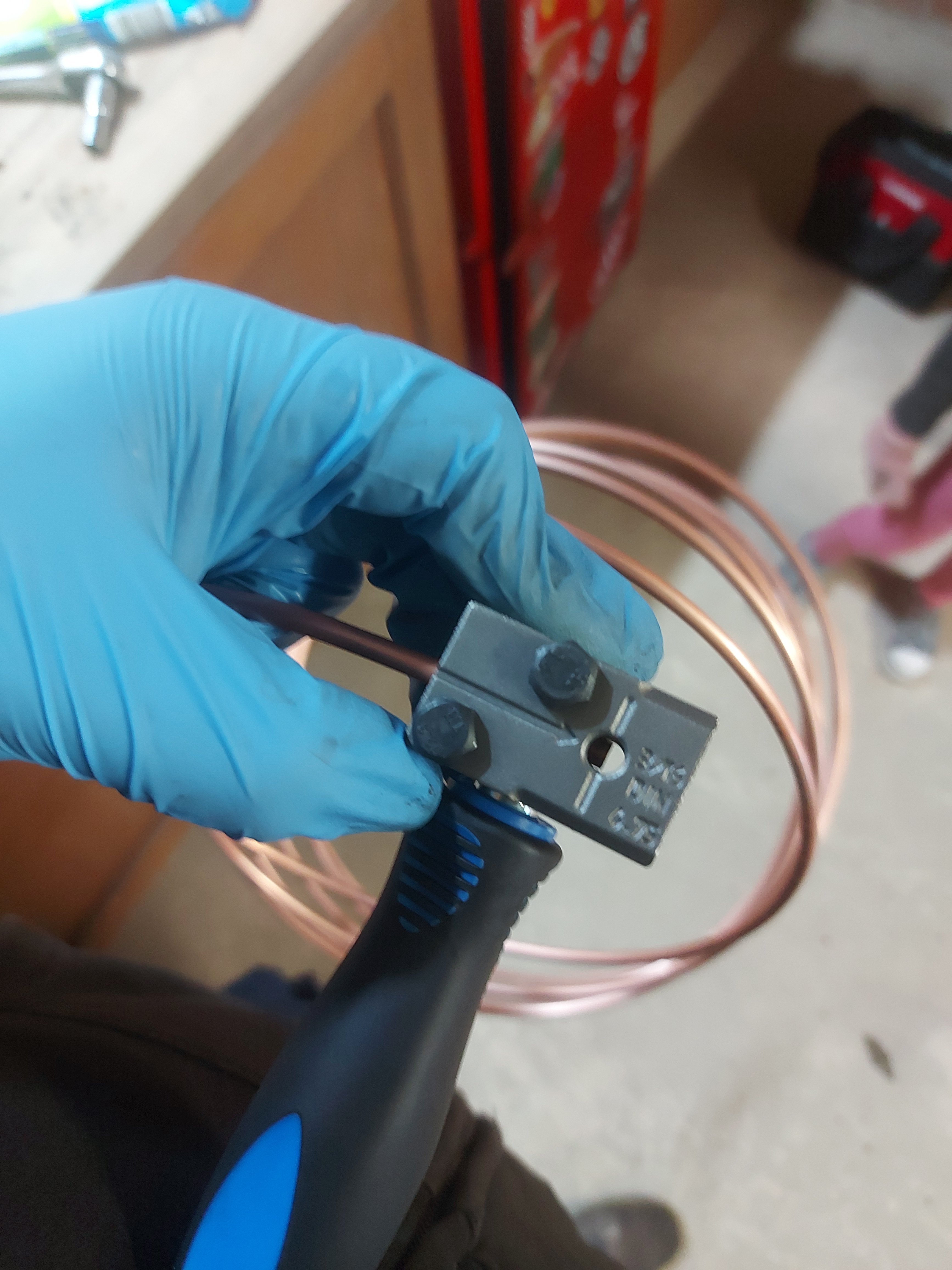

As my other thread I'm doing a rear axle replacement on my panda. Unfortunately when I took it apart the brake line unions were fairly corroded and bound up so I had to cut the pipe. I'm going to make a short piece from the existing steel pipe to the flexi. So one male union on the existing pipe that runs the length of the car, then a small piece with one end female going to that and the other end male going into the flexi.
I was under the impression that pandas were DIN type swages so ordered a DIN kit which I'm waiting to arrive, however I also ordered 2 new flexi's that have arrived and are SAE. All suppliers seem to list the flexis as SAE. So am I OK to use an SAE die to flare the make up pieces now? Or have the flexis possibly been listed everywhere incorrectly?

Here's how I do them
This is the connection between the front ridged and Flexi

I use cupro nickel pipe from Halfords, it reasonably cheap and takes a flare well
@irc probably knows for sure
Thank you, I actually just watched a youtube video saying to use the back side of the sae flare tool so its good to see that technique yields good results. Annoyingly I've got to put a flare on the steel pipe still attached to the car aswell, it seems as though that might be a struggle to do with the usual type of flare die. Have you had success doing it this way on steel pipe as well?

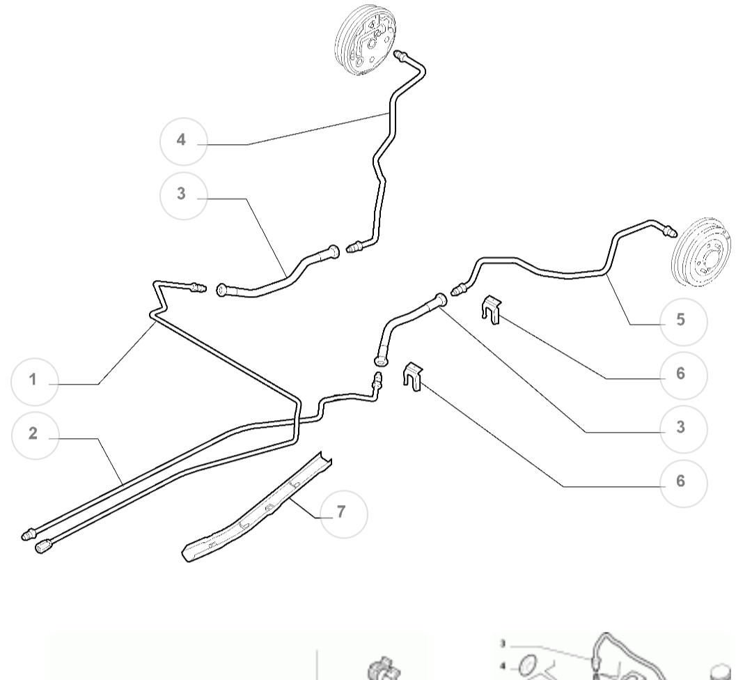

Hi @irci just want to double check that you mean there is another union half way down the car directly under the passenger seat for each side? You don't mean the union that is into the flexi on the brackets for the rear axle mounts?
Just want to double check as I'll be hopefully back on it in the morning and I can go straight to it. I tried to find a diagram of the brake lines for the panda but I don't know if it's my terrible googling abilities or what but I can't find anything.

Managed to get the brake lines under the passenger seat to seperate with ease, so great thanks to @irc and @koalar for pointing me in that direction. The clips by the fuel tank aren't much fun to get to mind! Got a handheld DIN brake line tool from amazon for 25 quid which seems to do the trick, did one end on each line for now and I'll run it on the car and cut to length and do the other end on the car to suit.
