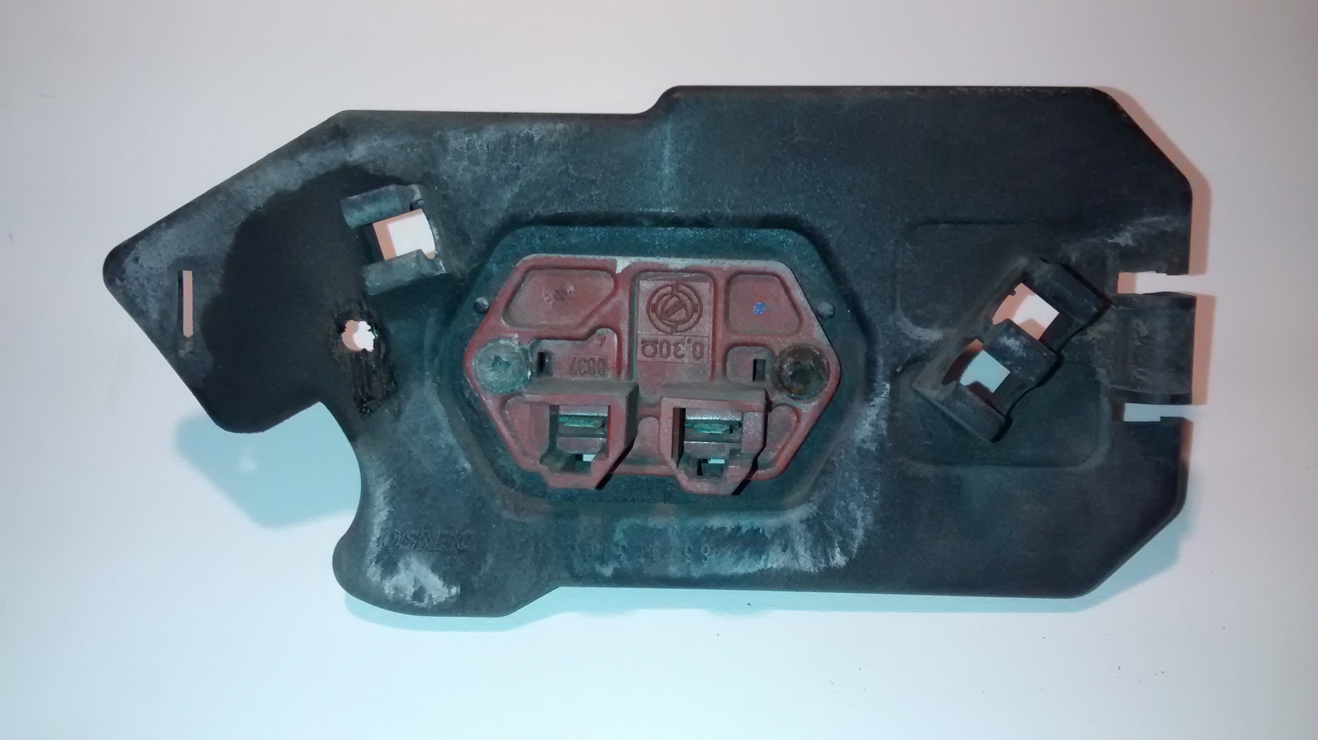

Underneath the tube is a some kind of in-line resistor, which is looking pretty scabby too.

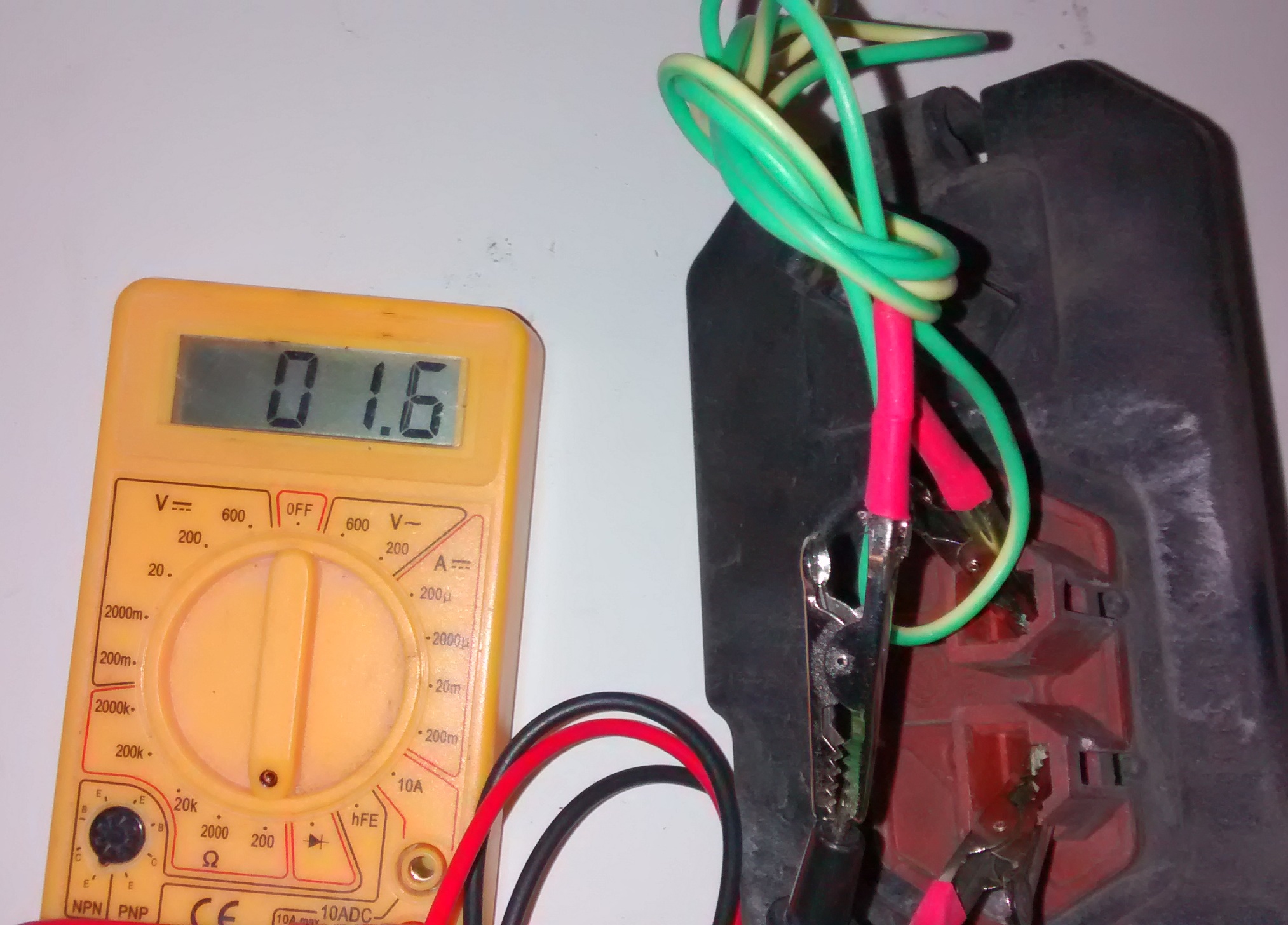

I put a multimeter across the terminals and it was giving about 1.6 Ohms. Applying a hot air gun didn't change the reading.
Sorry, one final point. As I was putting away the multimeter, I idly shorted the test leads together. And discovered that there's about 1.6 Ohms of latent resistance in the testing apparatus..... :mad:
So in fact the Fan Motor Resistor is providing no resistance at all, at room temperature. Which makes me wonder if it has actually failed.
(Off to buy a decent multimeter now, after years of cheap eBay tat...
A faulty resistor will not cause the fan to stay on, and it is only in circuit for the low speed, you say yours is running at max speed. About 1.6Ω is correct for a fan speed resistor, so you can discount it as the cause of the problem. Either relay T7 is shorted, or it's getting an unwanted ignition switched earth to pin 86. This could be from pin A19 of the engine management ECU, or possibly because of water in the engine compartment fuse box.
