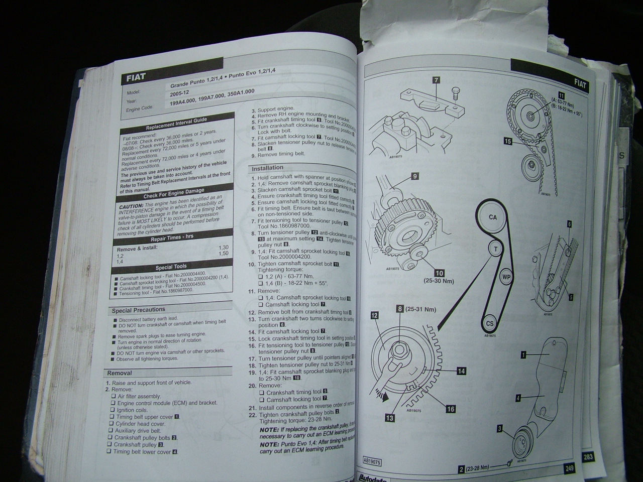

I was wondering what the knocking sound could be and if the car has a belt or a chain ?
Because my friend that went with me said this is most likely chain that needs to be replaced.
But I am unable to find specifics online if this car uses a belt or a chain.
In general chains rattle and more at idle cold before revs increase and take up slack, engine bearings, etc. knock more under load,and pistons knock more from cold before metal has expanded.
Does the engine numbers in this photo answer the question? :)

All Grande petrol engines have timing belts (not chains).
Knocking/ticking noise when cold (and goes away when hot) can be an exhaust manifold (broken studs), or worn VVT wheel. Or valve "lash".

No chain on the FIRE range and this should be the 1.4 8V 77Hp version, that comes with factory installed LPG, i think from Tomaseto. If you have the VIN, we can verify that, or if it is an aftermarket installation...
