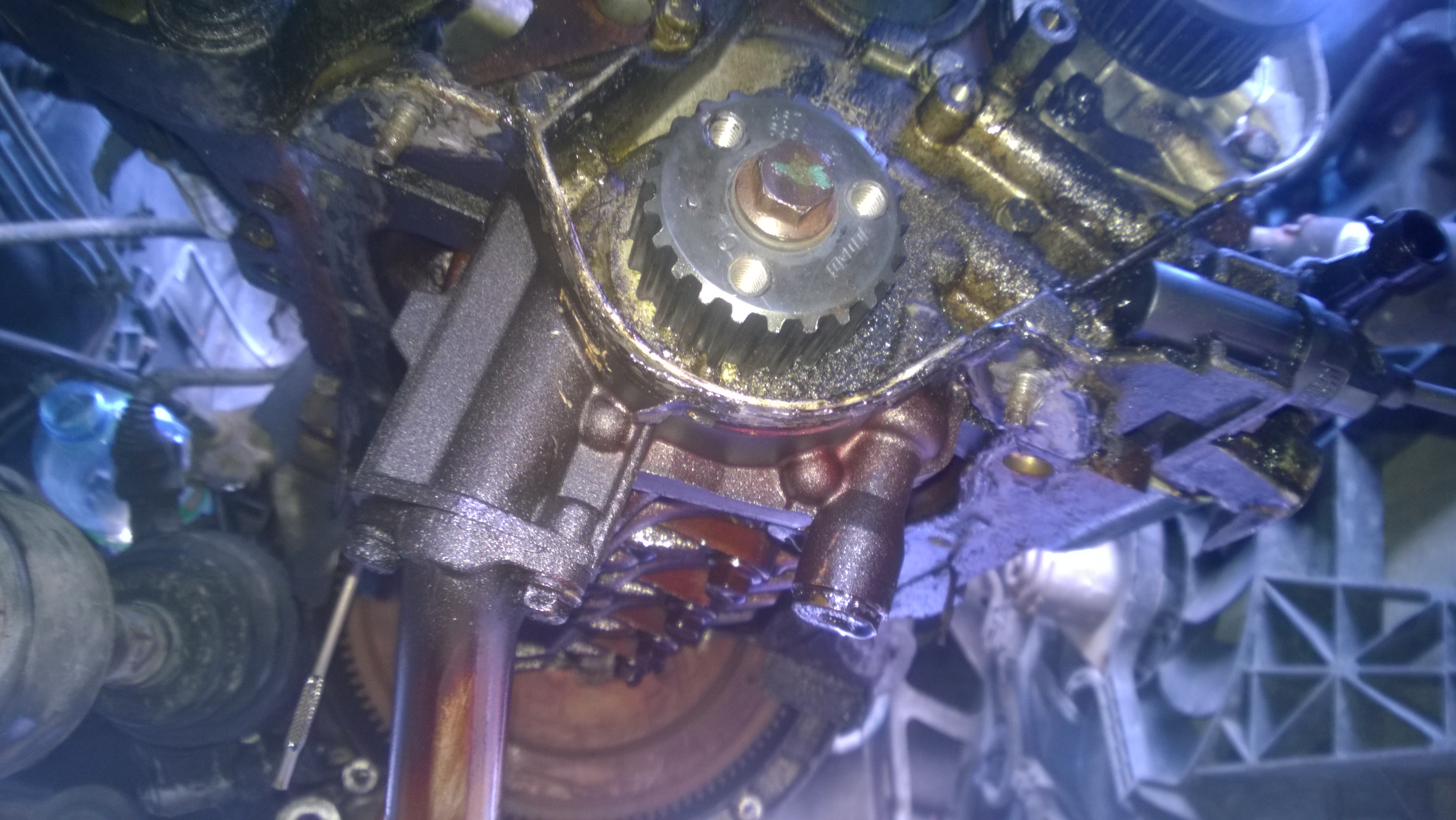

Afternoon all, I have a punto 2001 1.2 which I'd like to remove oil pump from. Ive an assessment on Tuesday on this and been practising on my punto as she's not working Engine does not start. I cannot remove the bolt that is shown, it holds crankshaft sprocket on. just wondered if anyone knows how difficult it should be. Bar some very rusty bolts on manifold and a ruined sump it came apart ok up until this point.

There are two ways of undoing this bolt.
Option 1 remove small round cover on the lower part of the flywheel cover and have a assistant jam a pry bar into the teeth on the flywheel. Now use a long breaker bar to undo the crank bolt. I used a jack handle to extend my breaker bar as the bolt should be very tight.
Option 2 take a length of flat bar and drill a hole in the end and anouther 10 to 15 cm further down. Take a shorter length of flat bar 10 15 cm long and drill a hole at either end. Bolt them together in a y shape and attach them to the pulley holes in the crank. You can now use this to immobilise the crank whilst you use a breaker bar to undo the crank.

Thanks for reply, we immobilised the flywheel and used a longish bar, got a bigger one to use tomorrow. as couldn't get the force that was needed on it.

Easy peasy way is just to make up a flywheel locking tool that bolts on to the grearbox casing. About 20 minutes work with a grinder, drill and welder. In the past, I've used a leg off a very small 3 legged puller, spaced out with washers.
If you pop the spark plugs back in, you should be able to free the bolt with air gun, without a locking tool.
Trying to free the bolt off with the cam belt on will often result in the faux woodruff key in the (probably sintered metal) pulley snapping off. They're very fragile.
we hijacked the starter motor and used that to spin the crank and we have success, all that just to ay I could do oil pump removal. well was good learning and assessment tomorrow
