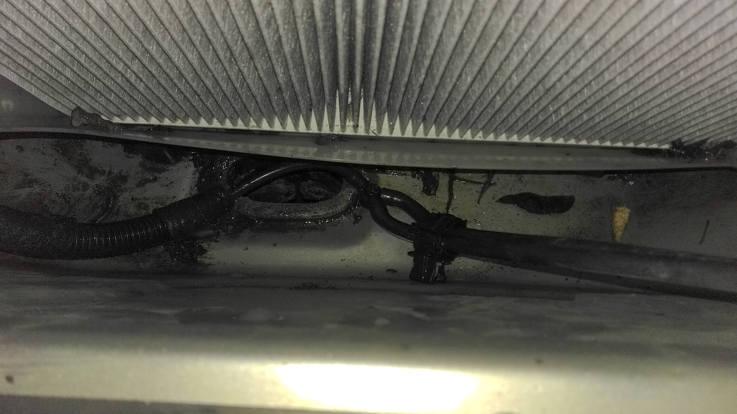

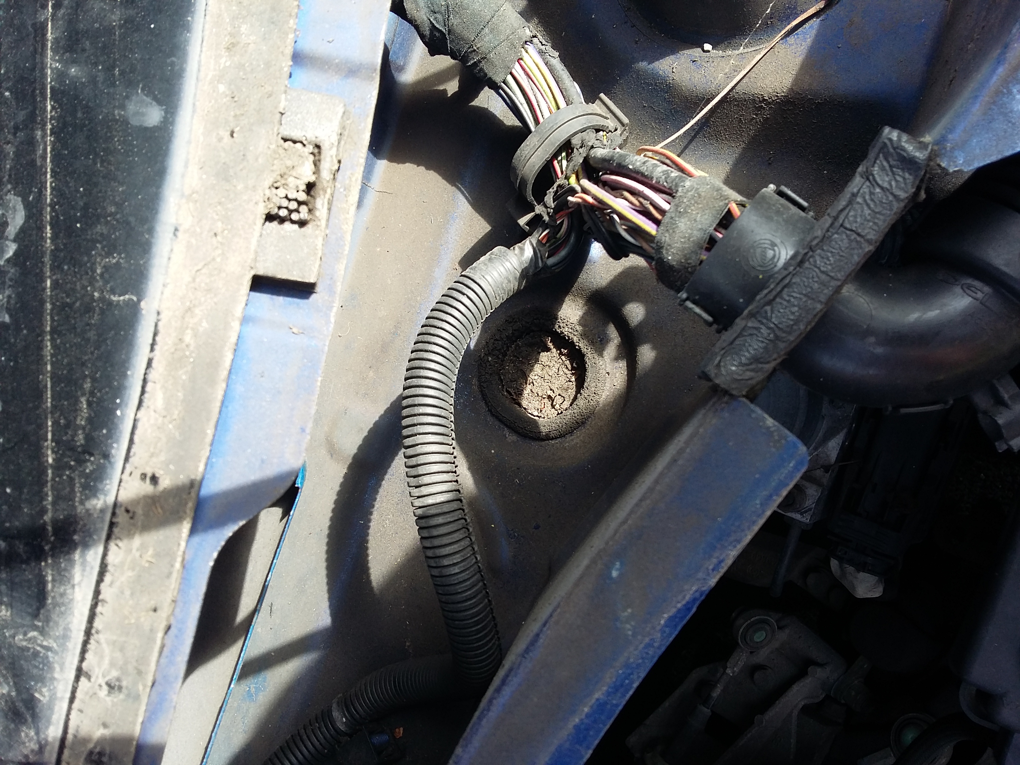

Anyway, found a load of water up to the bottom of the pollen filter. Managed to grope about and suddenly water gushed from under car. The big rubber oval shaped drain cup was cleaned out of leafs and gunk. Tried to clear as much junk around the area too.

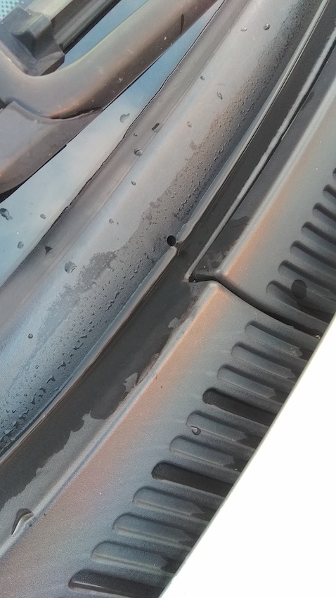

The top little drain hole was also clogged. A meat skewer clears that one. Would not a longer bit of tubing that sticks right down into the drainage hole be a better idea?
Damage done though as the carpet is very wet inside and this time of year is not good for drying it out. I tried taking some photos, the one looking up under the glove box does show some dribbles where water was coming in. I hope the drainage clearing solves it.
