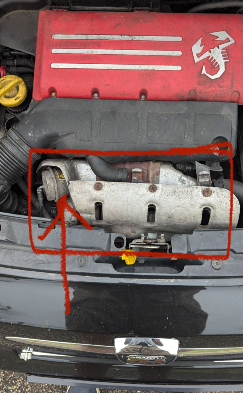

Open the bonnet, take a picture, post it up and we can point it out for you.
In these cars from memory it sits on the front of the engine on the top of the exhaust manifold so it is easy to access, and again if memory serves, it’s the large pipe going into the right hand side of the turbo you’ll want to pop off.
It could do with a clean but here it is. I'm thinking it's down the right hand side.....

Turbo is under here
Arrow is pointing to the waste gate actuator which if stuck or it’s become detached could be letting all the boost out.
The pipe you’ll want to remove is on the left hand side not the right as per my previous post.
You could also have just blown and pipe off or it’s split and not holding pressure, well worth taking a look to see if there is anything obvious

Thank you. I've inspected the pipe. It isn't split nor has it come away from the waste gate actuator. What I am I looking for if I take the pipe off? Does the waste gate actuator come apart. Again, thanks for your help.
you need to get the metal covers off to see whats going on there, get the engine cover off too. Then you can see what's going on.

Where the turbo actuator is in my picture above.
you will find under it and slightly to the right is the turbo unit itself.
on the left of the turbo is a big 50mm ish pipe going in, which will be connected to the air filter, this is the air intake side of the turbo, if you take that pipe off you can access the impellor on the turbo and will be able to see if it spins which it should so very easily, and if there is any movement up and down which would imply the bearings have worn out. it should also not move in and out, there is a certain amount of "end float" that is to say movement in the turbo impellor but it should be minimal. .
There will be another large pipe probably coming out somewhere under the turbo which carries the pressurized air to the intake of the engine. this is the pipe you will need to look at.
The actuator should normally be closed and only open if there is too much pressure on the presurised side of the turbo.
so if you take the metal covers and plates off and find the valve on the turbo to be open then it might just be the actuator has failed or needs adjusting.
given the sudden nature of the fault developing either a pipe had blown off, or split or the actuator has stuck open. thats where my money is.
If the turbo had seized suddenly you might get a similar issue where you no longer make any boost.
