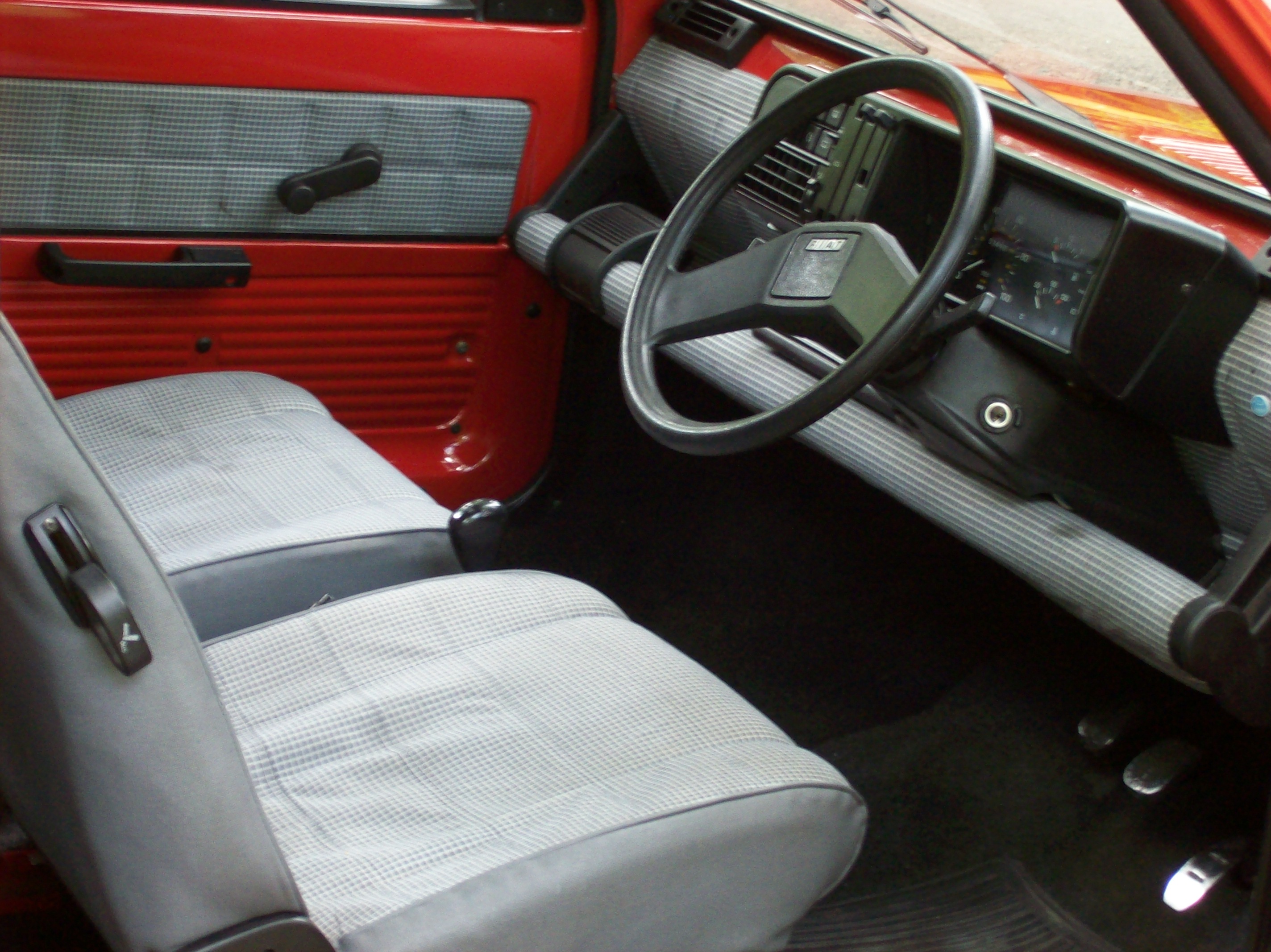

Seats look past hope really (worn and dirty) - don't suppose anyone has a clean set of CL ones kicking around? I think it was once a velour type cloth with a light bluey/grey pattern judging by the dash trim.

Alternatively, take the covers off and bung in washing machine on lowest wash. Poppi's seat covers came up a treat . . . .

Thanks for the ideas. The seats are the same as the pic above - only worse..... :yuck: Hadn't realised you could wash them - might be worth a go, but they are worn & faded under all the oil, so I could do with new ones really.

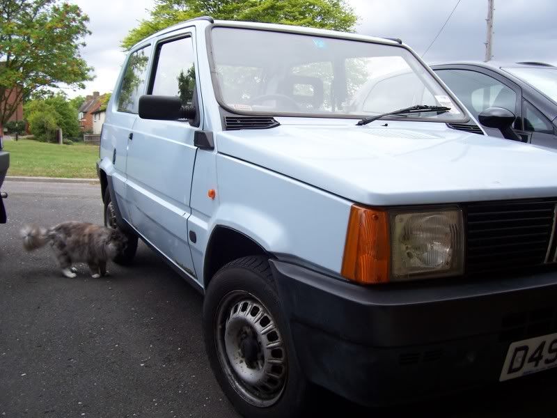

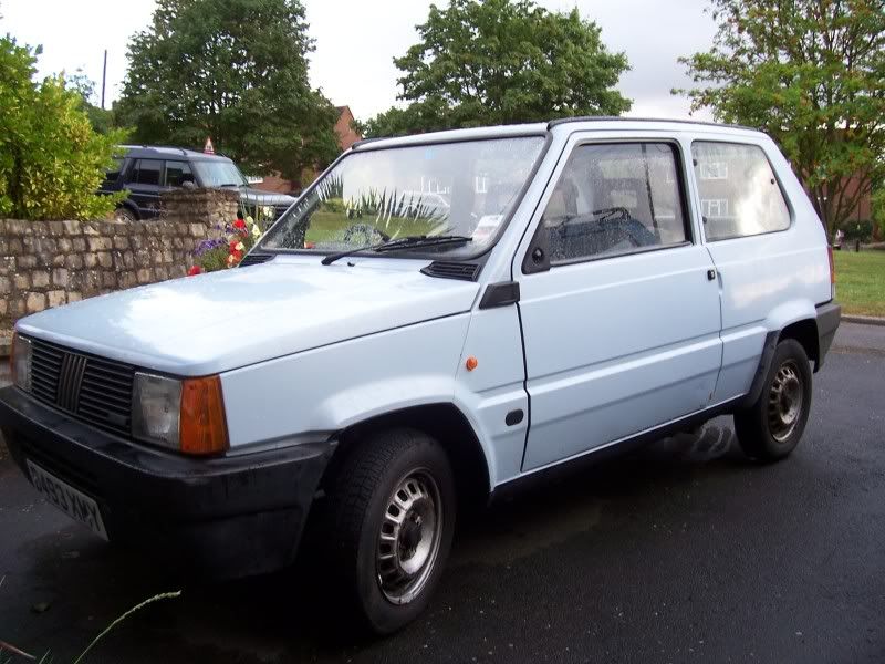

A few pics below - the paintwork is really dull and it doesn't show in these (amazing what a bit of damp weather does). I did spend an hour with T-cut and half the roof now shines, so it might be presentable in a few years :rolleyes:
New clutch and tyres done, so now for the odd running - it's also jerking when you ease off the accelerator (worse in traffic) - a bit like when the HT leads are going, but not on acceleration :confused:
Anyway, here's the rescued Panda - no name yet if anyone has a printable idea!!
