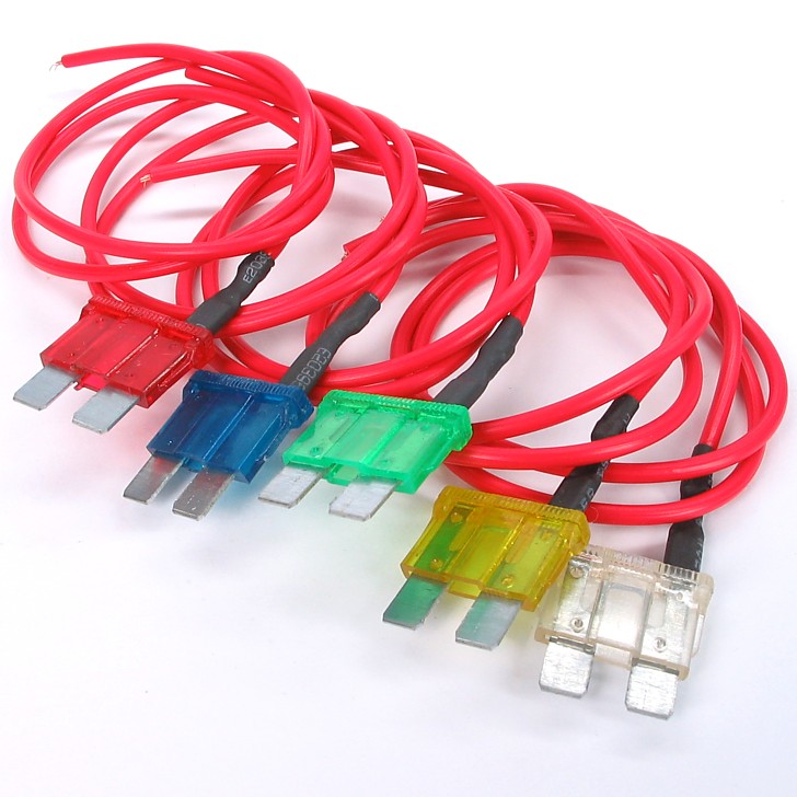

For power I found the fuse that runs the headunit (and dash clock) which will be permenantly live, and used a spur fuse (see attachment)
My local halfords had these in their audio fitting toolbox(not on shop floor, ask!)
This has space for two fuses, one for the fuse the spur replaces andvanother for the live feed
This removes the need for modification of any existing wiring in your car! Really useful.
