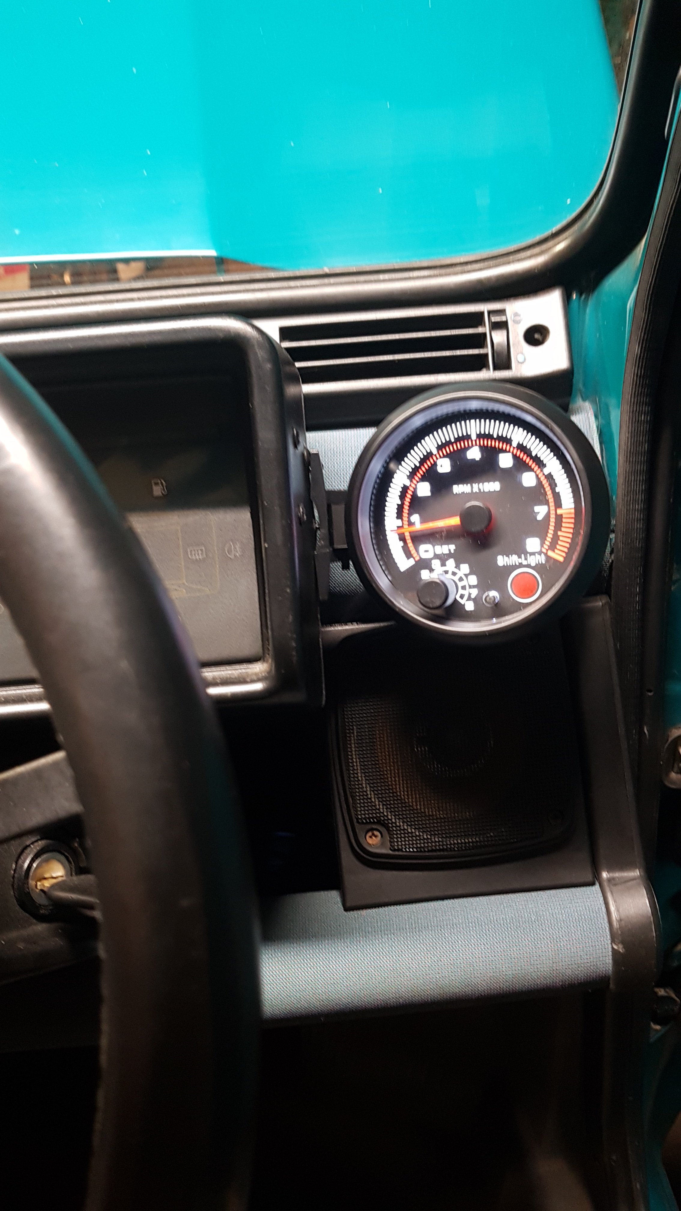

I take it it will drive better without it if it's faulty?been running some injector cleaner new fuel and caning it.think old fuel had been in a few months seems a bit better now.fitted rpm dial too...take lead of pin 1 on ecu.
